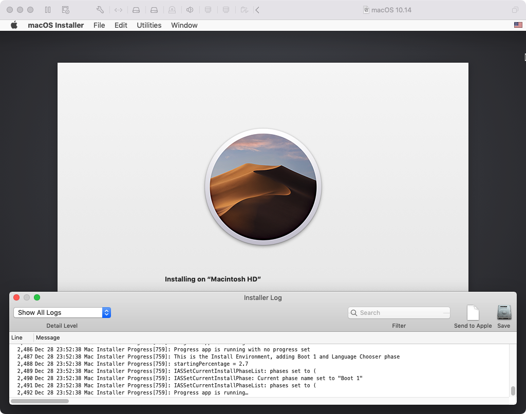

1. Start the Mojave install:
2. Accept the agreement:
3. After the install starts, you can show the macOS installer log pressing CMD-L:
4. Now press CMD-3 to show all messages/errors/logs:
5. After that, wait for the failure and take a picture of the log and any error messages that can be displayed.

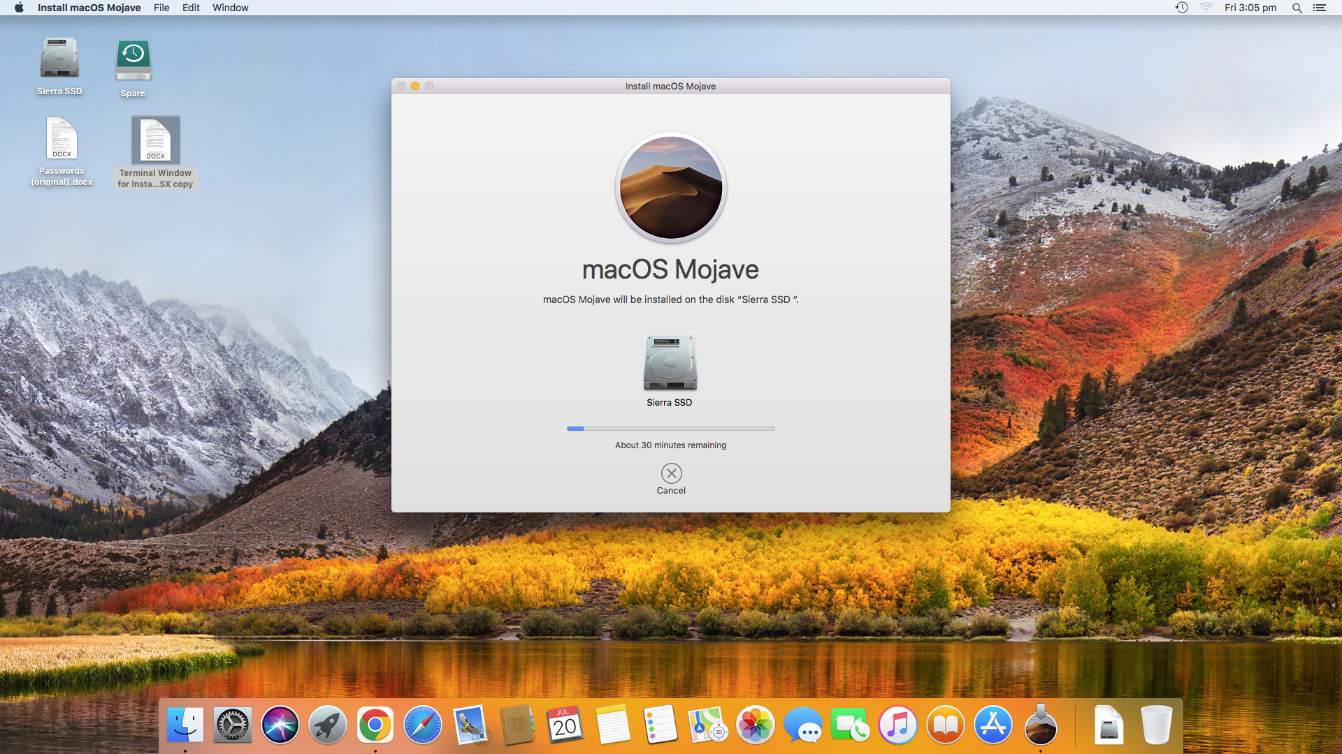

1st screen shot beginning Mojave install.

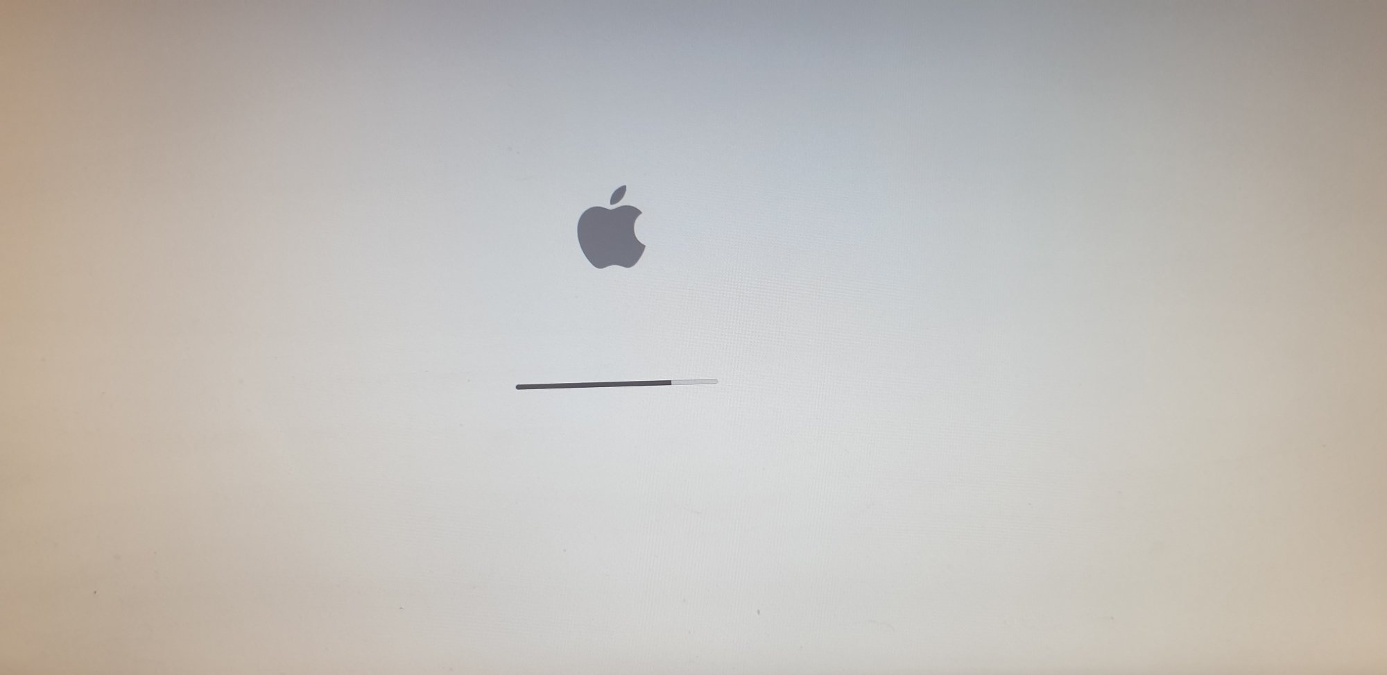

2nd screen shot progress failure, which I didn't touch the for 45 minutes.

Begin of Install
Progress bar seconds prior to failure.

The log is failing right at the APFS conversion phase, several wrongs things could cause this failure, like wrong firmware features (could be a botched/incomplete BootROM upgrade) or even disk problems.
My suggestion for further diagnose is to add another known working, or a brand new disk, to your Mac Pro. Format it as JHFS+ and then select it right at the beginning of the Mojave install, instead of your "Sierra" disk.
After that, see if the install completes/where it fails.
Remove your TimeMachine disk from your Mac Pro, make your hardware config as simple as possible, so you avoid any red herrings.
Also, try to run AHT and be sure that the extend test completes with your Mac Pro. You can learn how to create an AHT memory key with this GitHub article linked below:
