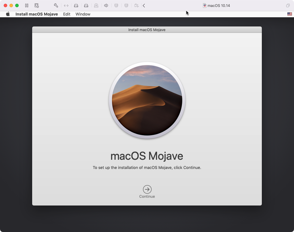

Start the Mojave install:

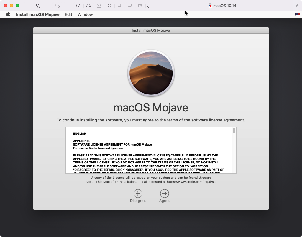

Accept the agreement:

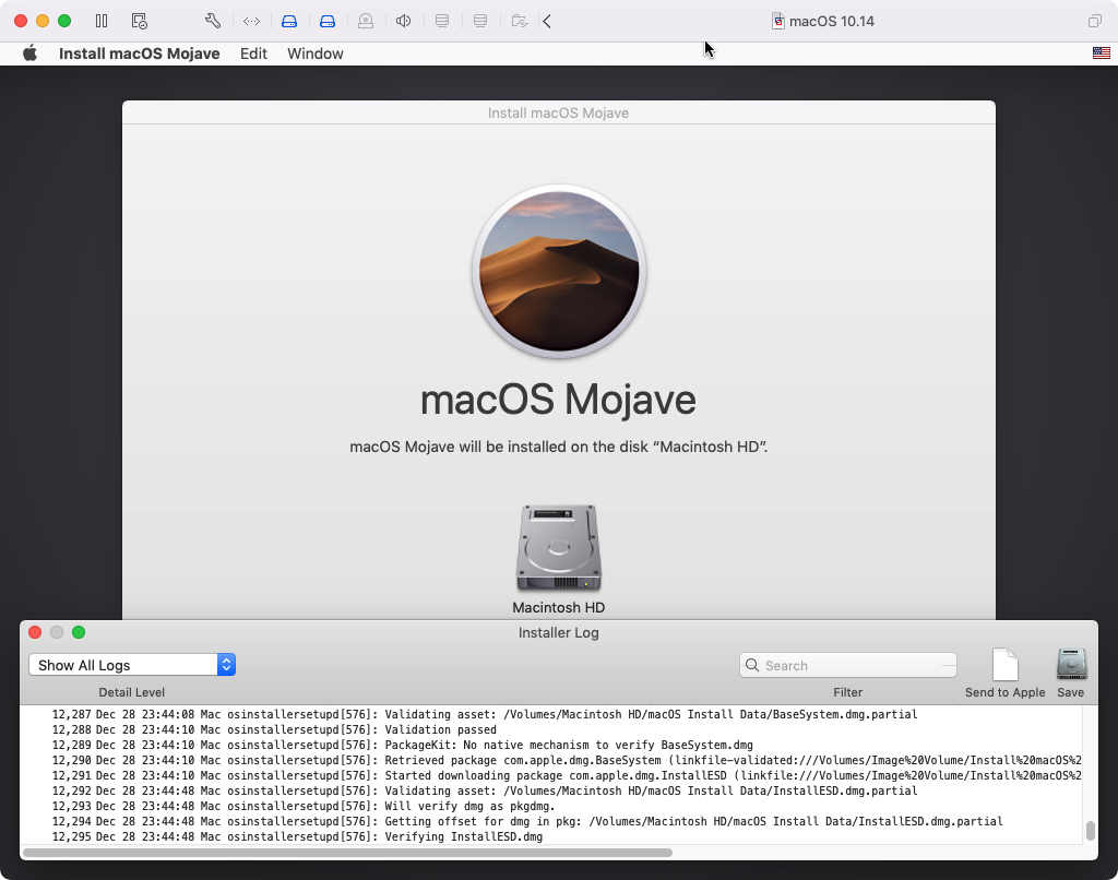

After the install starts, you can show the macOS installer log pressing CMD-L:

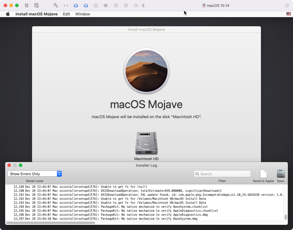

After you press CMD-L, the macOS installer log will be displayed:
Now press CMD-3 to show all messages/errors/logs:
After that, wait for the failure and take a picture of the log and any error messages that can be displayed.

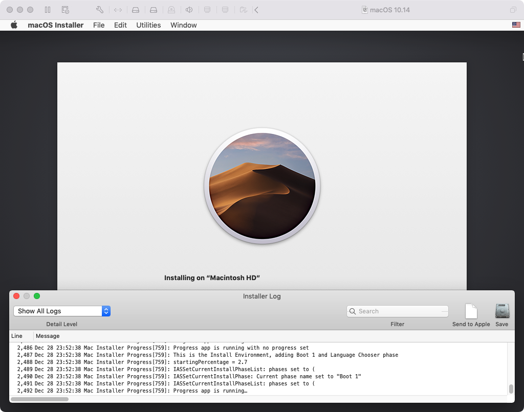

If the failure happens after the first macOS installer reboot, when the black screen with the progress bar is displayed, do what @arw linked to you before:
