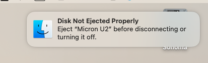

Last few days, on Sonoma 14.2.1 I had messeges like this, sometimes on cold boot, sometimes after restart:
After that message, there is no drive mounted or drive present as a device at all in the system

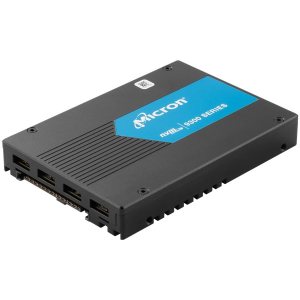

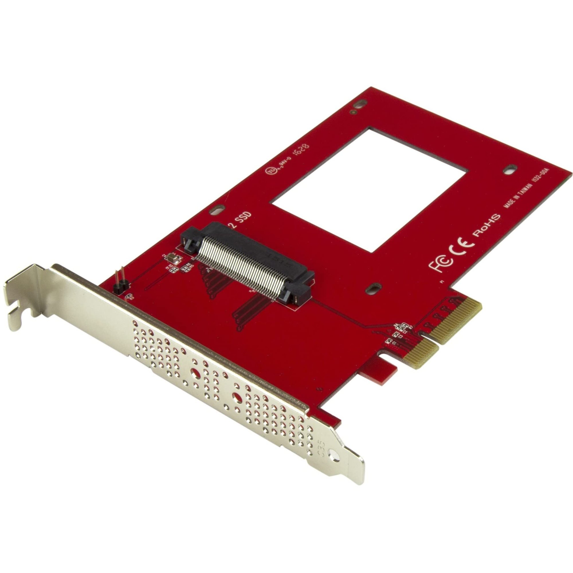

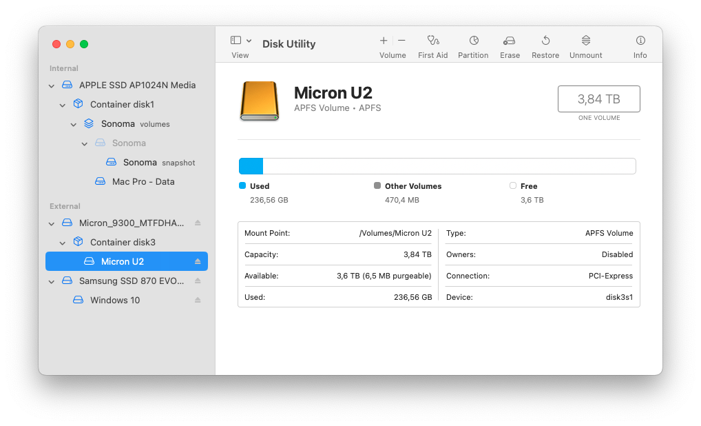

So here is my experience:
In slot 6 I have StarTech PCIe to NVMe U.2 adapter and connected to it is Micron 9300 Pro 3.84TB drive (Storage, APFS)

Last few days, on Sonoma 14.2.1 I had messeges like this, sometimes on cold boot, sometimes after restart:View attachment 2340138
2 days ago, I have installed Sonoma 14.3 and problem disappeared. Let's see for how long.
