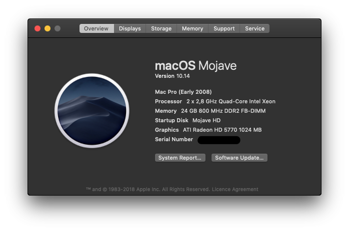

I was asking this because I read that @Zlobnick manage to use both a GTX1060 and an Ati Radeon HD5770 at the same time:
Yeah, I installed Mojave today using both cards at the same time. 1060 in slot 1, 5770 in slot 2. All went flawlessly using dosdude's Mojave patcher. I even get a usable picture in Mojave with 5770, but it's slow. But it's enough to install nVidia web drivers which haven't been released yet :(

Some of your assumptions are incorrect.
First one is about how Apple designed the GPU power delivery with the backplane, but this is a long explanation that I already posted about in detail previously. I'll resume here, it definitely don't work like you think as GPUs don't equally are feed by the PCIe slot power lines as they are from the PCIe auxiliary power inputs. This tremendously changes from GPU to GPU power design and almost none do it equally, almost all PC GPUs use most of the power required from the PSU power connectors and just a little from the PCIe slot. Never assume that a GPU will use 75W from the slot, almost all GPUs use around 25W, some GPUs use a little more, from the PCIe slot and the rest of the power are feed from the PCIe AUX power connectors.
A GTX 1060 will never use 120W at idle, NVIDIA Pascal idle usage is around 14W or less, you are looking at total system power consumption.
Second one is that Apple supported SLI or Crossfire, it never was supported feature. Apple implements multi GPU supported very differently from the way it's supported with PCs. Developer Center has documents that explain how this is implemented with Apple APIs.
Third one is that you can use dissimilar GPUs simultaneously, you can't. Up to High Sierra you can use an AMD GPU with a NVIDIA one without much trouble when you are doing 2D or light 3D work, but you always have headaches when using compute. After Mojave you can only use GPUs from one brand and even if you stick to AMDs only, you can't use an unsupported GPU like HD 5770 and a supported one. dosdude patches gives you the impression that you can do this, but save the future headaches tracking weird problems, just use officially supported GPUs and with the way Apple intended you to use it. If you need pre-boot configuration support, rEFInd works nicely with GOP GPUs and MP3,1. No need to keep a Mac EFI GPU just for boot screens/boot picker.

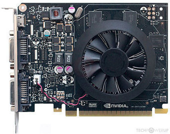

So you are saying that this (GTX750Ti SC) would be my best investment if I want to upgrade to Catalina? (also regarding drivers availability)
GTX 750 Ti, GM107, is Maxwell.
Apple used GK107 for Mobile GT 750M used on mid-2014 MacBook Pro
