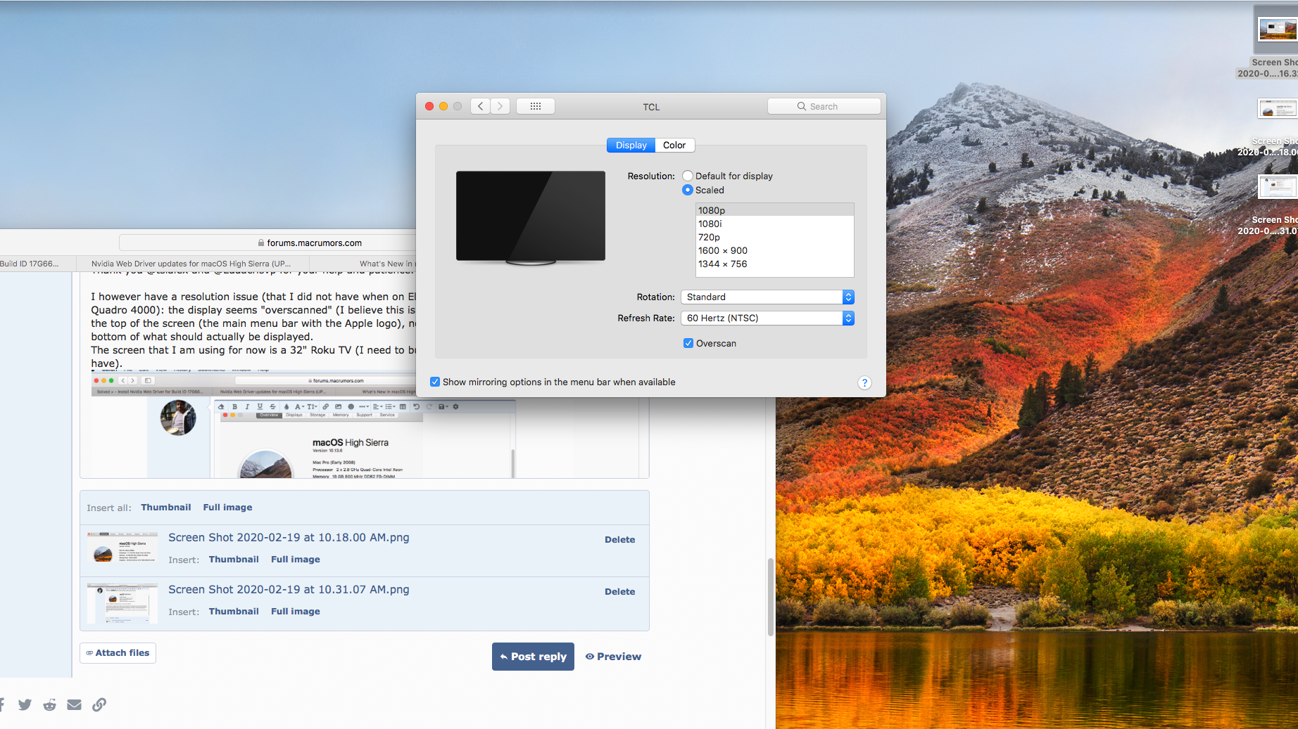

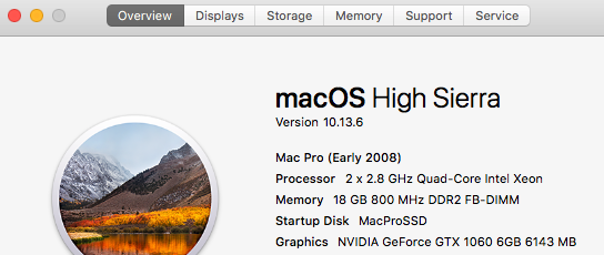

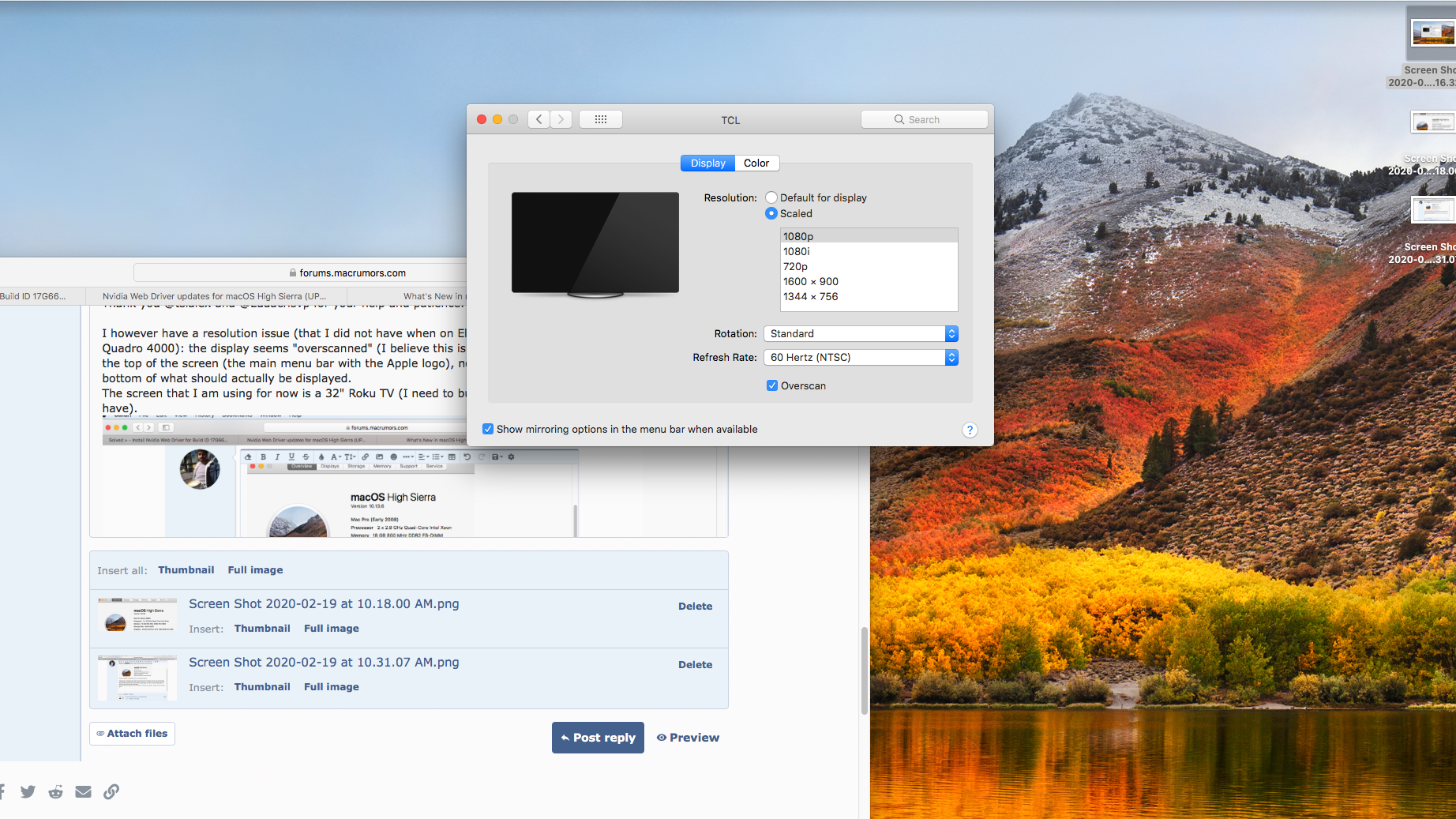

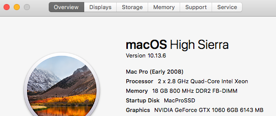

Ok, so I manage to install the GTX 1060 6Gb (with a dual mini-PCIe cable) on High Sierra using @dosdude1 ’s patch (thank you again!). At first the driver that I got from insanelymac did not work so I search and found on this page that I should run the following script:
Code:
bash <(curl -s https://vulgo.github.io/webdriver) 387.10.10.10.40.113
which indeed allowed me to get the driver installed.
Thank you @tsialex and @Ludacrisvp for your help and patience.
I however have a resolution issue (that I did not have when on El Capitan using my now removed Nvidia Quadro 4000): the display seems "overscanned" (I believe this is the term). In other words, I cannot see the top of the screen (the main menu bar with the Apple logo), nor that I can see the whole sides and bottom of what should actually be displayed.
The screen that I am using for now is a 32" Roku TV (I need to buy a screen :-S but for now this is what I have).
Any idea how I could fix this? The System preferences menu does not seem to provide any help in solving this issue.
Code:
TVs usually have a menu where you control over and under scan. If not, you can use an app like SwitchResX an others.
