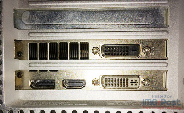

What you don't seem to understand is power is not the issue here, the card is not under any load and everything I have read on this forum suggests no need to power any card from SATA.
I just want 2 of the 4 ports to give a video signal, so far only the Displayport does.

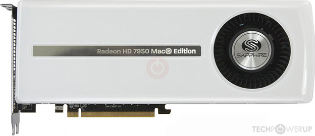

Your problem is not power related. It's that your card outputs are different from the layout of the personality used with Sapphire HD 7950 Mac Edition. When this happens, only the outputs of the card that have the exactly same configuration as the Sapphire HD 7950 Mac Edition will work. Most cards lose one output, usually the HDMI or the second DVI, when flashed.
You can't edit yourself the personality layout, it's very low level table inside the firmware. If I remember correctly only two users here that are not active anymore knew how to do that.
This makes sense, the mac Edition has,
1x DVI
1x HDMI
2x mini-DisplayPort
My card has,
2x DVI
1x HDMI
1x DisplayPort
As I mentioned earlier I have had the lower DVI working, but now only the Displayport works.
Any thoughts on where I go from here?

You can search for Fl0r!an posts and see if he ever edited a personality that would fit your card, it will be trial an error. Besides that, you can't do anything.
Btw, Apple did some changes with the drivers between High Sierra and Mojave that made some cards to not work with some outputs or with some of the worst cases, like with AMD Pitcairn GPUs, stop to work completely. If your DVI output still works with 10.13.6, it's the case.

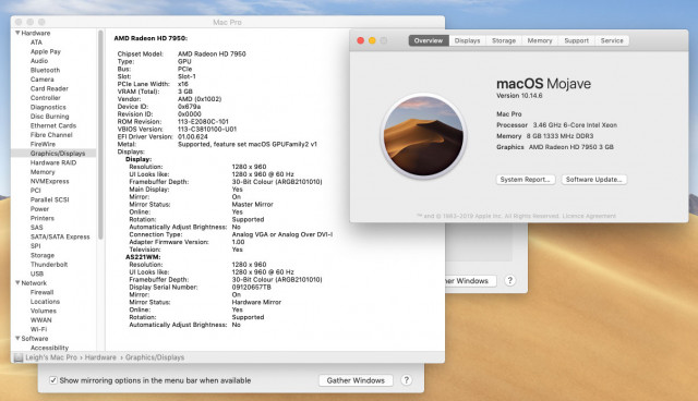

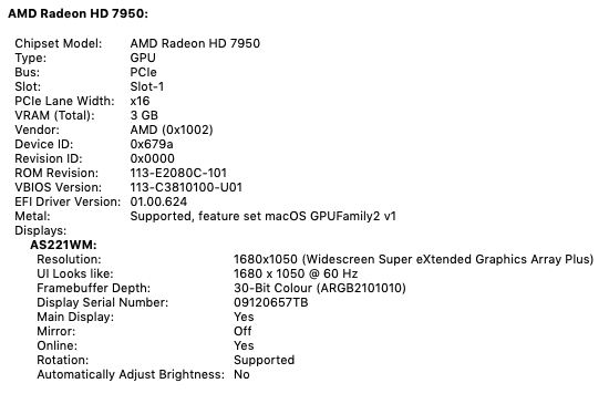

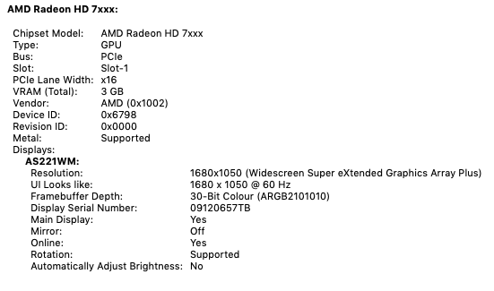

I have magaged to get both displays working but only mirrored, if I select use as seperate display I lose the DVI output.

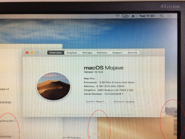

Also the DVI output seems very glitchy see below, the circled areas jump all over the place.

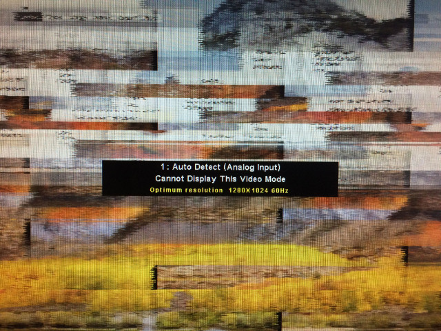

And if I swap the DVI to the other monitor,
Is this anything to do with a bad flash? or shall I buy an RX 580? :)
Test with High Sierra, if you don't have the same problems you will know that it's a driver problem and you can't do anything about it.
Yes I tried HS also, exactly same result (my last screen shot is HS you can just about make out the moutains) :)
So, it's not a driver problem and maybe it's something hardware related. One last test that you can do is to flash back the original firmware and test again to be sure if the Mac EFI is not causing your problems. If you don't have the original firmware, try to find it on TechPowerUp.

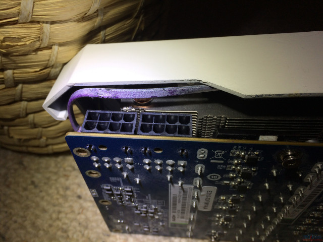

which has 1x 6-pin + 1x 8-pin power connectors, mine has 2x 8 pin connectors???

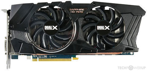

You have not posted a photo of the WHOLE card - showing the LOGO on the fan(s).
POST A FULL SIZE PHOTO SHOWING THE WHOLE CARD.
The sticker on your card in the photo you posted ( Post #1 " says "7970"

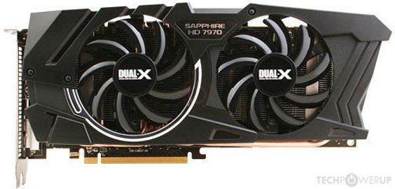

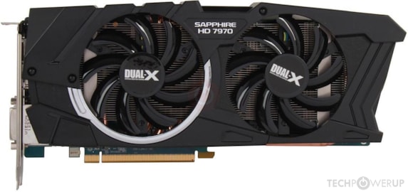

Download the ROM here https://www.techpowerup.com/vgabios/155228/155228
If the card is indeed non-reference then sell it and get either a true reference DUAL-X 7970 or a Sapphire or Gigabyte or MSI R9 280X
AMD Reference 7970 & R9 280X cards have 1 X 6 pin and 1 x 8 pin.
Personally I would not buy your card . . . 2 x 8 pin points to non-reference.
YOUR Sapphire 7970 ports ( TWO x 8 pin power sockets
My Sapphire ( reference ) DUAL-X 7970 ports ONE x 6 pin & 1 X 8 pin power sockets
My DUAL-X 7970 has TWO mini Display ports + ONE HDMI + ONE DVI
All ports work !
It would appear that your Sapphire 7970 is non-reference.
Thanks, there is no logo on the fans as the case has been spray painted white, but the case is exactly the same as in the techpowerup link you just posted, its is actually this card below (not home right now so can't take photo)
2x 8 pin
I do have a Gigabyte card in the post with ports exactly the same as your Dual-X hopefully that will give the dual screens I want, I am grateful for everyones help and just trying to understand a little more about my 'nightmare' card, I think at this point I'll go with your comment "Personally I would not buy your card" just unfortunate it came with my second hand 5,1 :rolleyes:

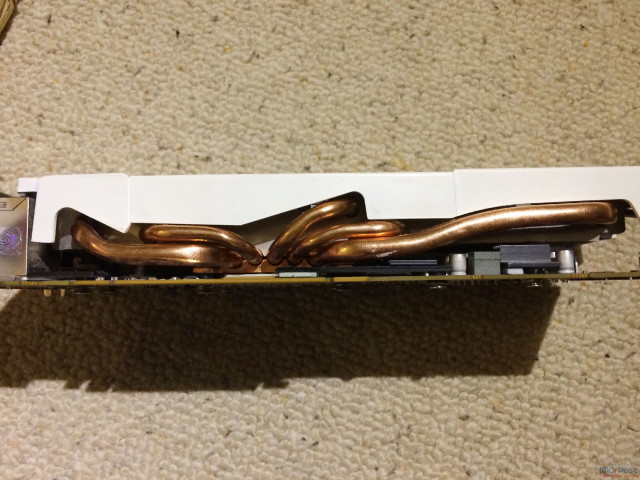

Just out of curiosity, when time allows . . please take a photo of the card ( side on ) so we can see the shape of the fans shroud to actually verify it's shape for model identification.
PS : If you had ordered a Sapphire Dual-X 3gb ( same as mine ) I could have PM'd you the working, EFI de-volted ROM.

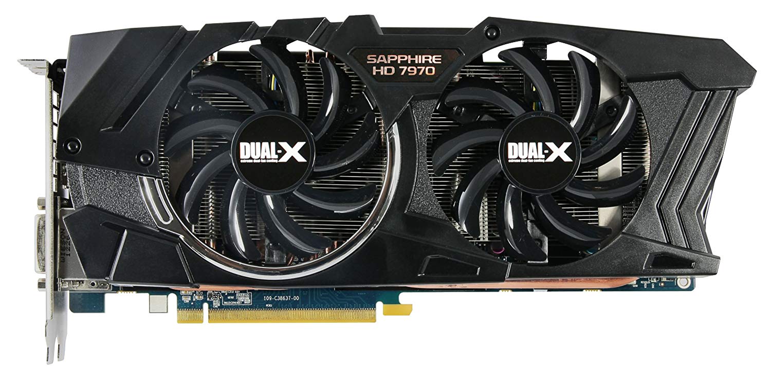

still cannot see the FACE of the fan shroud.
We need to see . . . THE WHOLE fan shroud. like this . .
