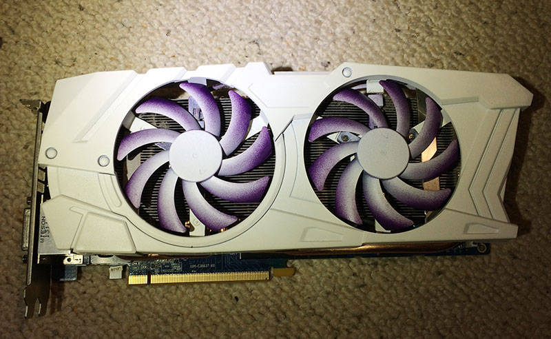

Well you did say side on which I posted, thats the top view, my card has exactly the same plastic cover as that one.
I thought that it was obvious what I meant. I wanted to see it with my own eyes.
You have been posting bits & pieces photos of the card.

And I also attached the photo of the card you wanted, and also the original and modded roms if anyone is interested (use at your own risk) ;)
You will be pleased to hear I have replaced the hideous spray painted cover and fans with parts from a dead card I found on eBay.

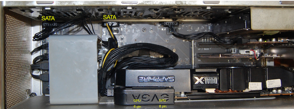

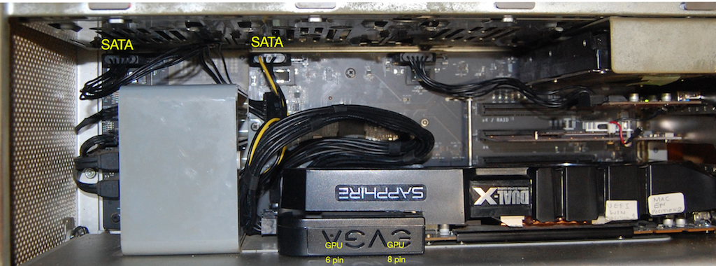

I hope that you are powering the card correctly now.
This is how my Sapphire Dual-X 7970 is powered when I need to use it.

Why aren't you using your EVGA PowerLink for this card instead of grabbing more power from sata ??
I DO use the EVGa PowerLink connected to the 7970 to 'balance' ALL the power supplied to the PowerLink to the GPU . . . the Dual SATA to ONE 6 pin cable is connected to the PowerLink as shown in the photo I posted.
In case you do not understand . .
Power to the PowerLink.
1. From MacPro Dual Mini 6 pin cable to PowerLink 8 pin socket.
2. From the Mac Pro. DUAL SATA to ONE 6pin cable to the PowerLink 6 pin socket.

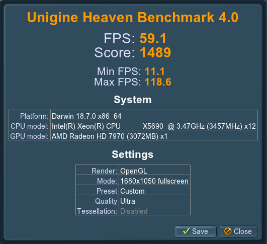

Run Unigine Heaven on Ultra setting and you will see it crash due to power draw √
