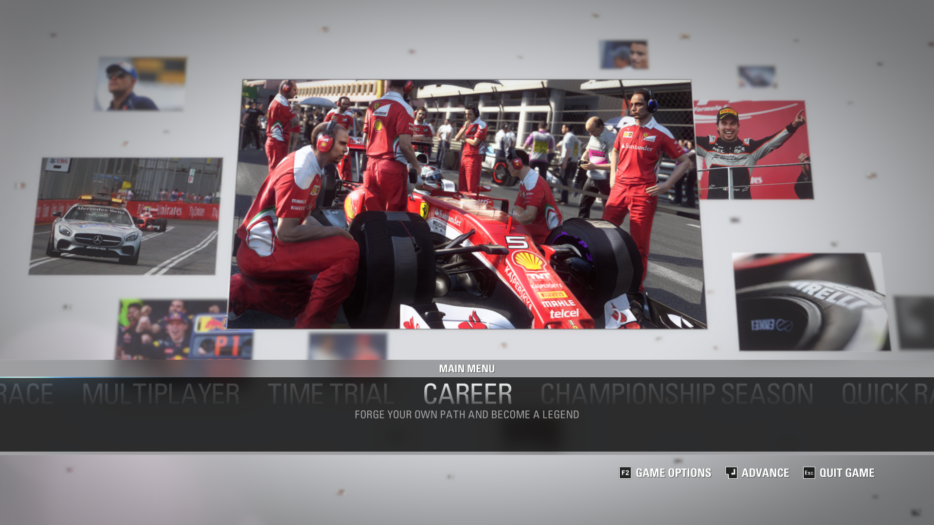

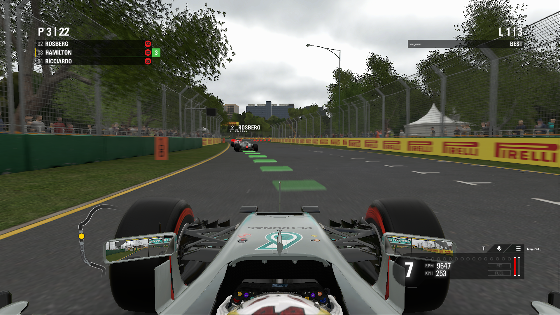

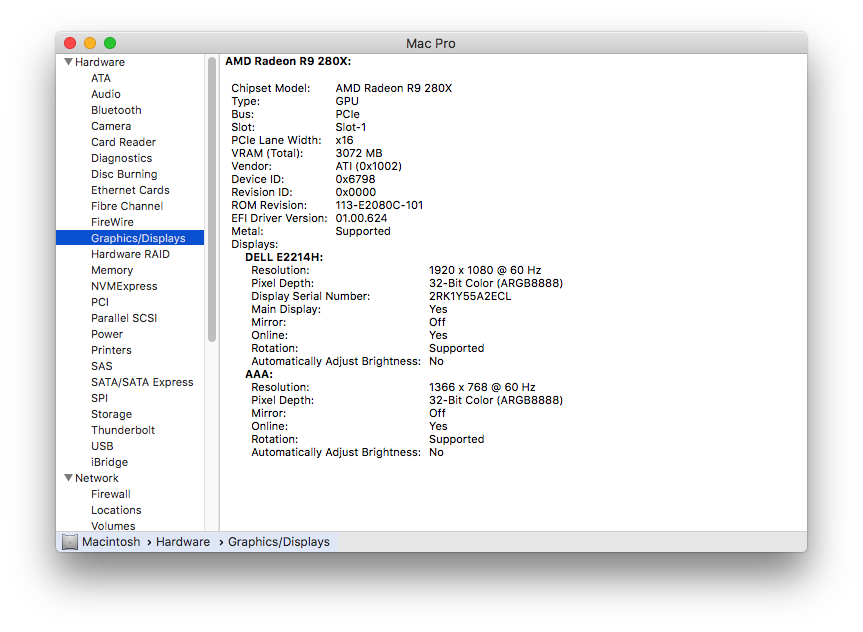

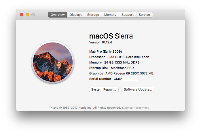

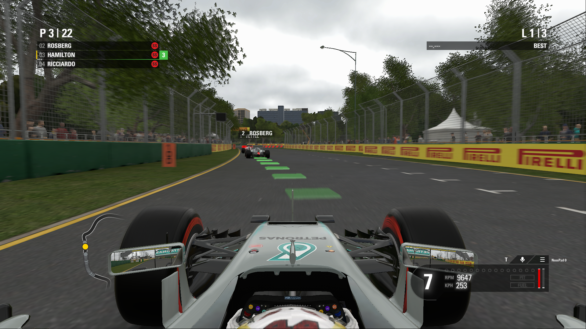

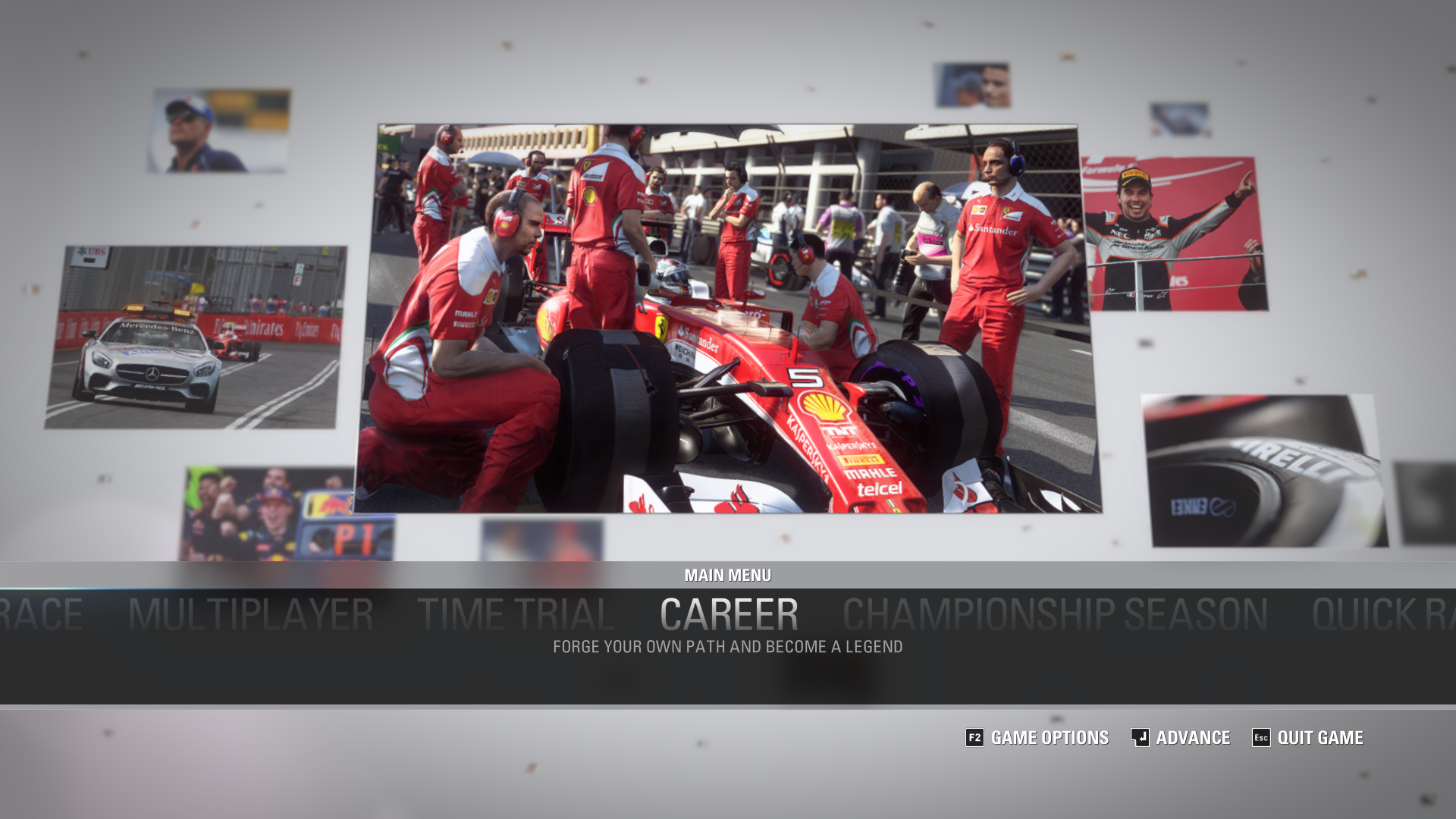

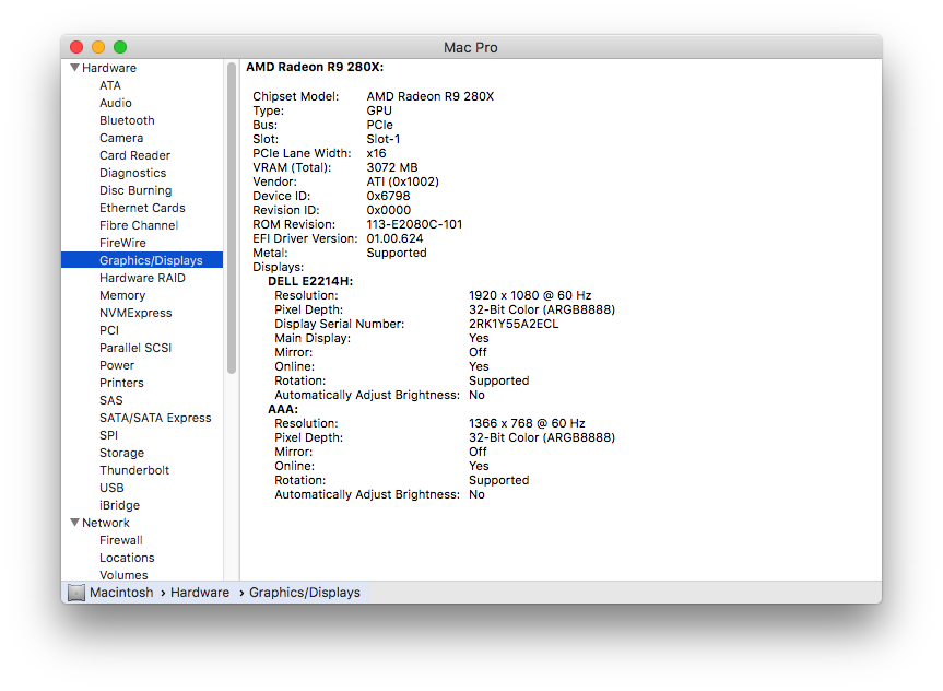

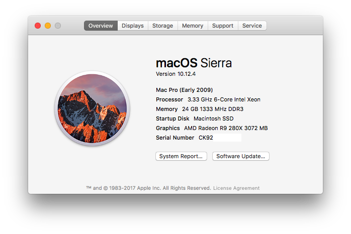

Sorry for the wait, but i don't plan on playing this game so i had to find it on some other "store" rather than MAS or Steam (it would be stupid to spend 50 bucks just for testing) 🙄
The game works with my MSI R9 280X Gaming 3G
View attachment 695870 View attachment 695869
View attachment 695872 View attachment 695873
Not one warning on compatibility or anything like that.
This is a good news for you, since you can buy R9 280X for cheap, still be able to play Dying Light and after flashing (quite easily done in Windows) there will be no downsides compared to Mac HD7950.
Thing that bugs me now is why is R9 280X supported and HD7950 isn't and does game looks for name of the card or Device ID. In other words, will it run on HD7970 since they share Device ID and HD7xxx are not supported...
If I grab some spare time, i'll reflash R9 to read HD7970 and test again. In the meantime, if there is anyone with HD7970 willing to try this out it would be great. Also, what would happened if you flash HD7950 with R9 280 (non X) rom, or just use the stock PC one (for those with flashed R9 280s) - will it run the game?

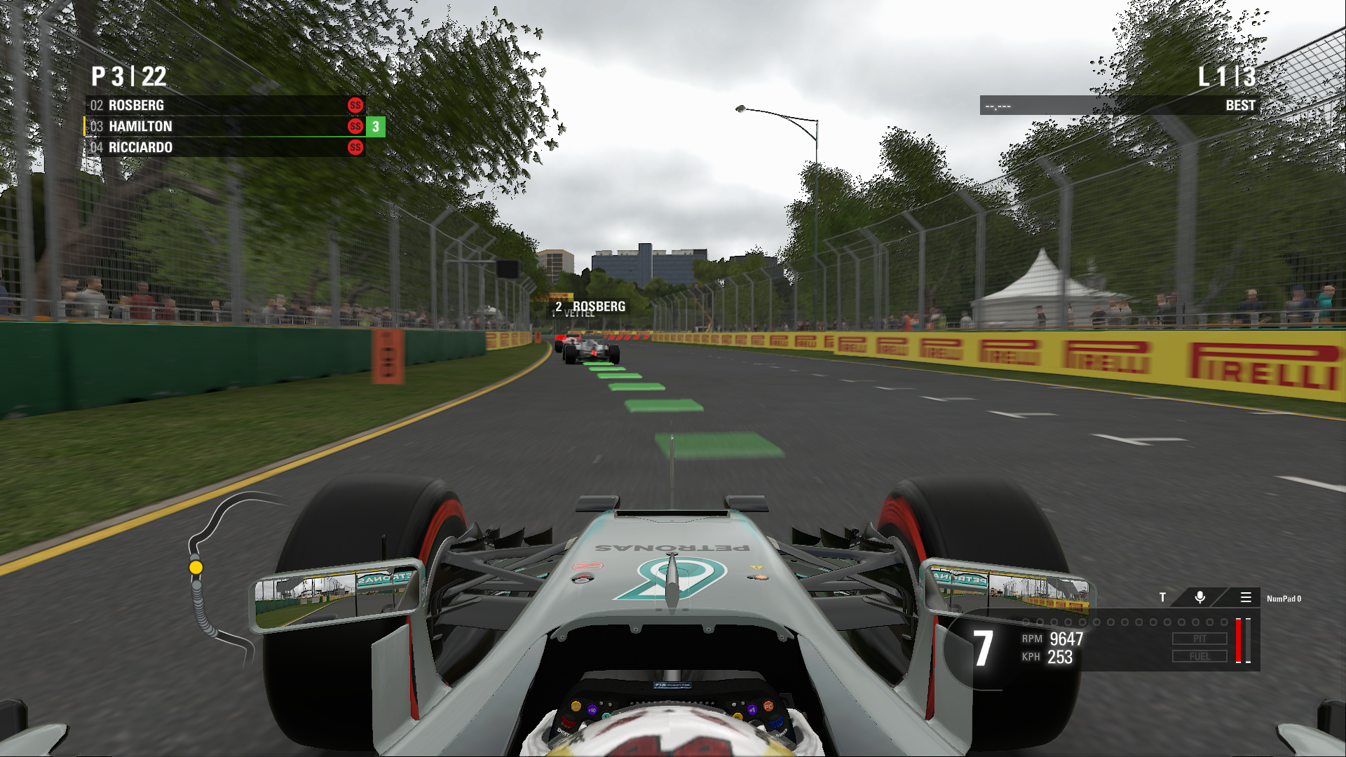

A few points about F1 on my Mac Pro....
I have run the game on my Mac Pro 5,1 with an R9 280x with the default OS X graphics driver and a GTX970 with the nvidia web drivers installed. The game runs great with both cards, but there are texture resolution issues with both cards on my machine. I am running the game on ultra settings and some textures look really good while others, like the asphalt textures along with some of the trees and others, are piped in at a very, very low resolution. When I run the game on an iMac 5K, everything looks as it should and is quite beautiful. Even if I turn everything down, the low res texture issue remains. I have played with the settings quite a bit and this aspect does not change. Anyone have better output in this area?
As far as wheels, the G27 runs great with the game and the FFB is tight and responsive. I have a the Logitech Driving Force GT and a Momo that I can also try out. I have not tried the G29 or the 920 yet to see whether or not FFB is actually supported, but I have a feeling they may not be.
