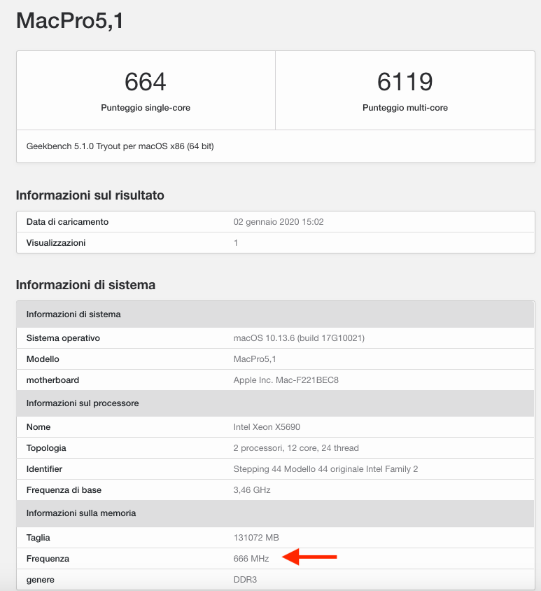

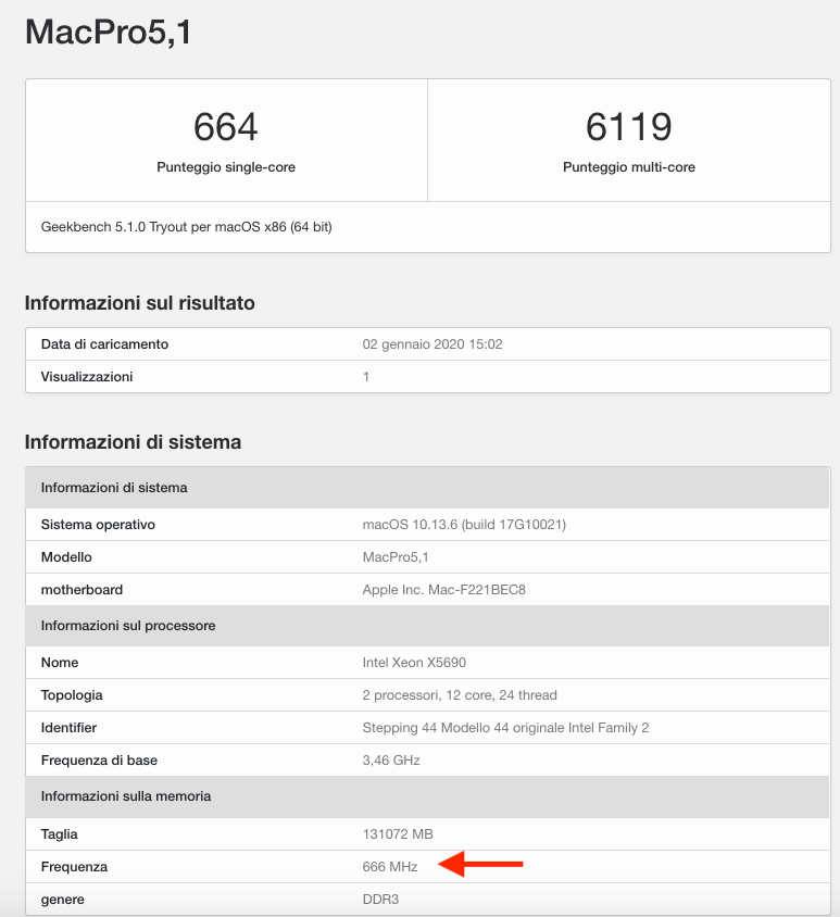

I don't understand why 666mhz marks me when I am 1333mhz

No that is just a mistake by the program. The first post you made today showing your system "About This Mac" screenshot clearly shows your ram at 1333mhz. The system sees it just fine as it is no reset needed. If worried about heat, as I usually am, I would go for the hottest CPU to keep an eye on. But really it will only be while under heavy load you need to watch, then once you see how it behaves you will worry less about it.

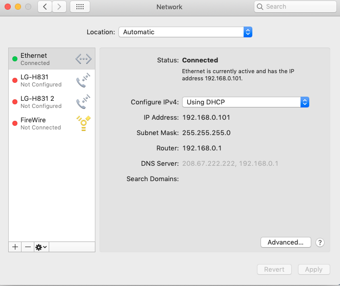

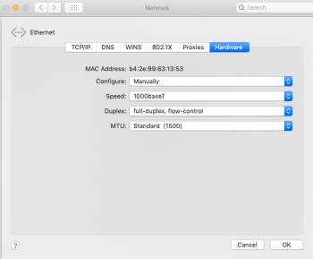

integrated network cards you mean the standard ones on the mac pro? because I connected the lan cable, but it only supports 100base tx and not 1000t, I don't find it so responsive in opening web pages, compared to the standard wifi
Your two network ports on the rear are gigabit (1000Gbps) Ethernet. Make sure you use a Cat5E or Cat6 patch cable (and a gigabit capable Ethernet switch/hub if you use one) to get the best out of those network ports. If your router or a Ethernet switch/hub is only 100Gbps then that’s all you get out of your LAN and WAN.
As the other poster mentioned make certain you have the proper cables a cat 5e or better. There can also be times when it does not get it correct when negotiating the speed. Go to the System Preferences -> Network -> Advanced and manually set it to get the full speed. Then renew the DHCP lease by hitting that button (in the TCP/IP tab) and see if you get the proper speed.

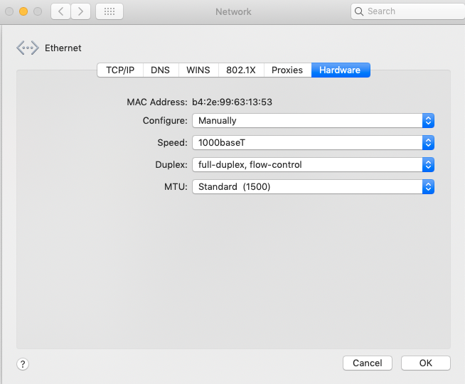

so you confirm that the 2 ethernet ports are gigabit? because I was considering buying a giga ethernet pcie card
now I have modified how MacUser2525 posted me, and it seems to be much better, then text for good
thank you so much guys
above all I ran greenbench, and I got a very low score .. 664 single core, 6119 multi core
remove the DIMMs in slot 4 and 8 and you will have a better performance
the cMP is triple channel and slot 3+4 and 7+8 sharing the bus.
so it will be faster with 96GB of RAM

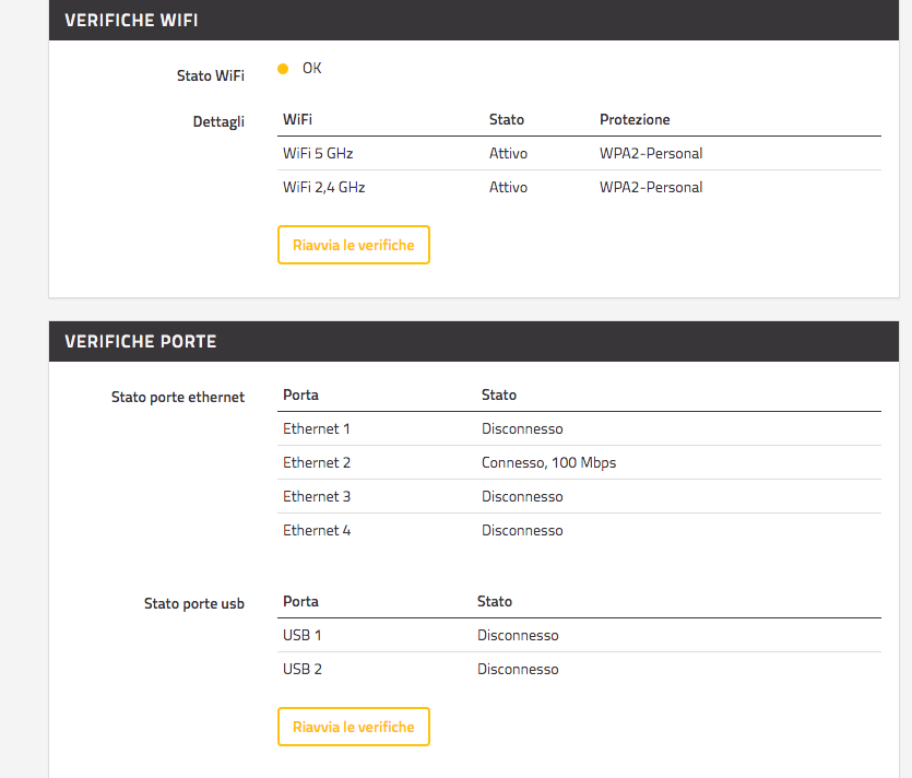

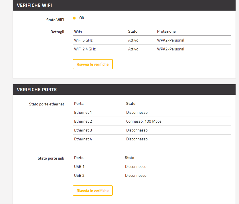

is a router given by the company that provides me with internet and has 4 gigaethernet ports and 2 dual band wifi, but I entered the router and saw this ... I attach photos.
I only connected cMP to port 2, but it scores 100mbs
Yes they are gigabit ports for certain if they were not then the option to set the speed to 1000t would not appear. Just keep it set to the manual to force it to connect at that speed.

That does seem strange make sure the cable is proper, when looking at it you should see some small numbers with the cat 5e or cat 6 written on it. Everyone is labeled to tell you what type it is, if it is not the proper one it will need to be replaced. Everything in the connection needs to support the 1000t if not then it will not get a proper speed.

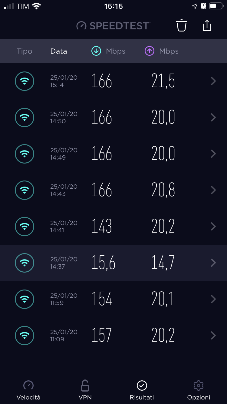

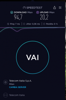

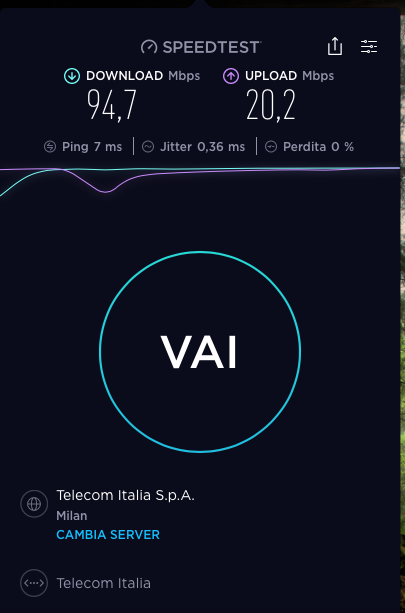

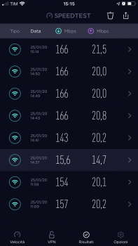

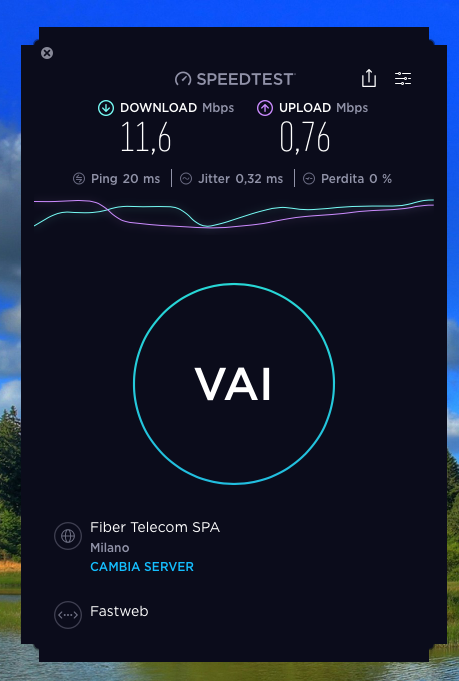

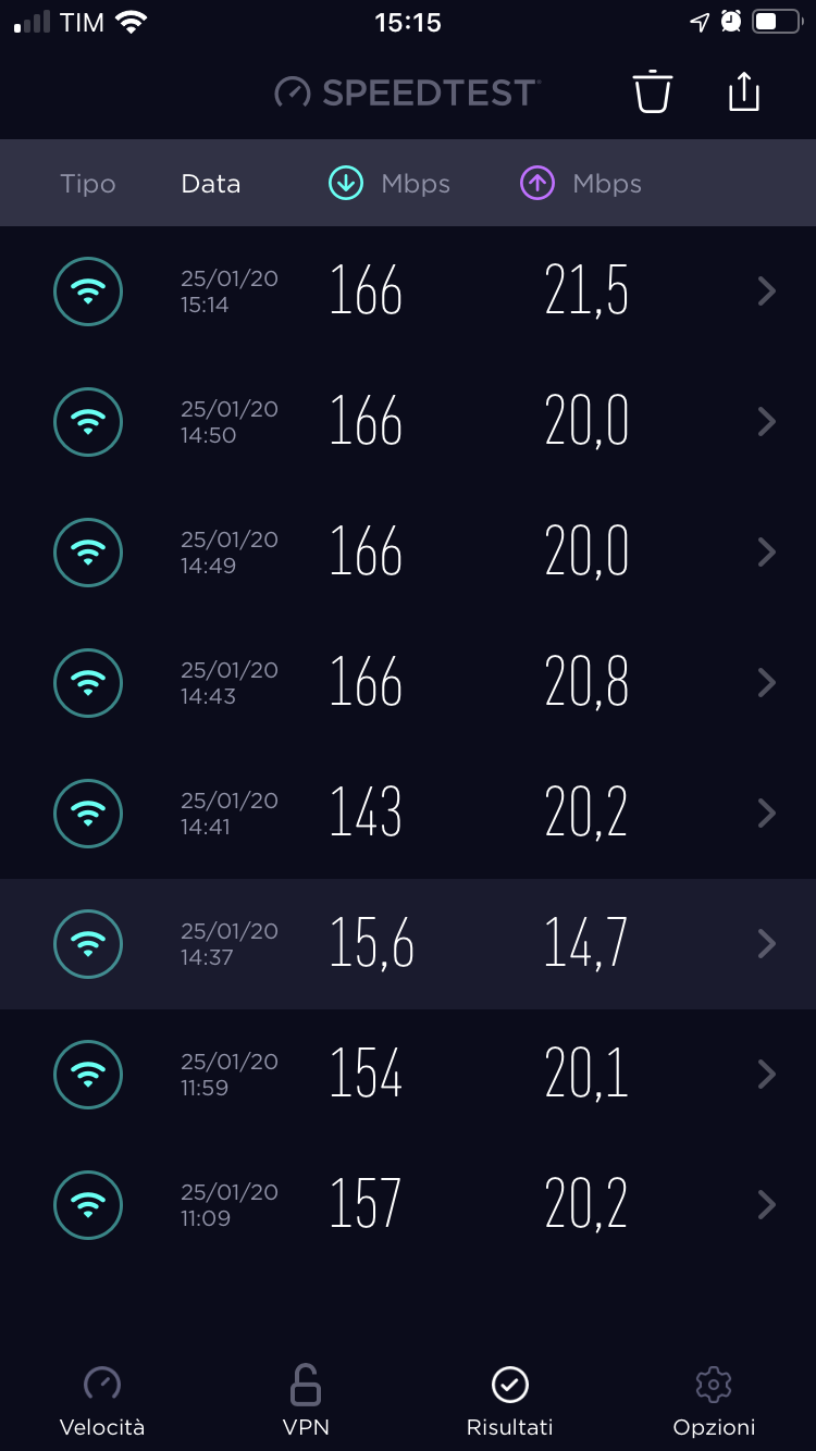

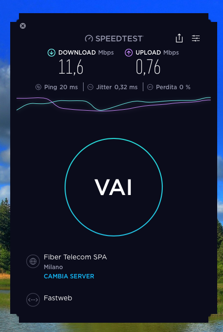

Hi guys, I wanted to ask you two info:
One how come after activating the new fiber internet line, with the mac in ethernet and wifi, I travel down 94.7 and up 20.2, while if I run tests with iPhone I travel down 166 and up 21, how come?

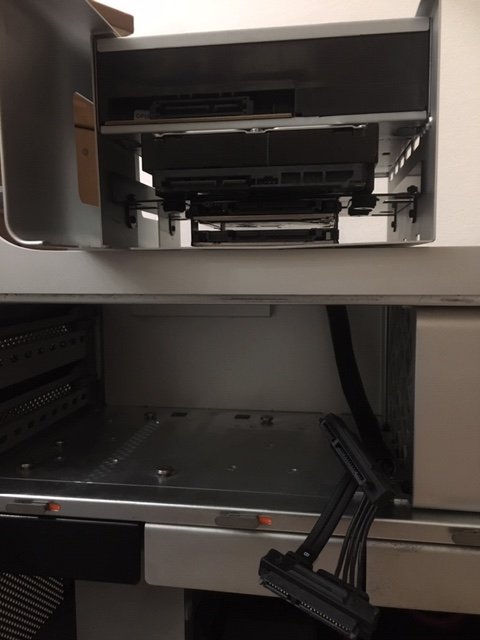

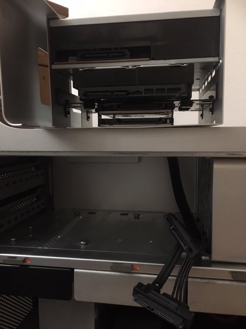

Second question, I purchased an internal 5.25 hd / ssd support and inserted 3 hd, instead of the second dvd player, which cables do I need to make them work?
