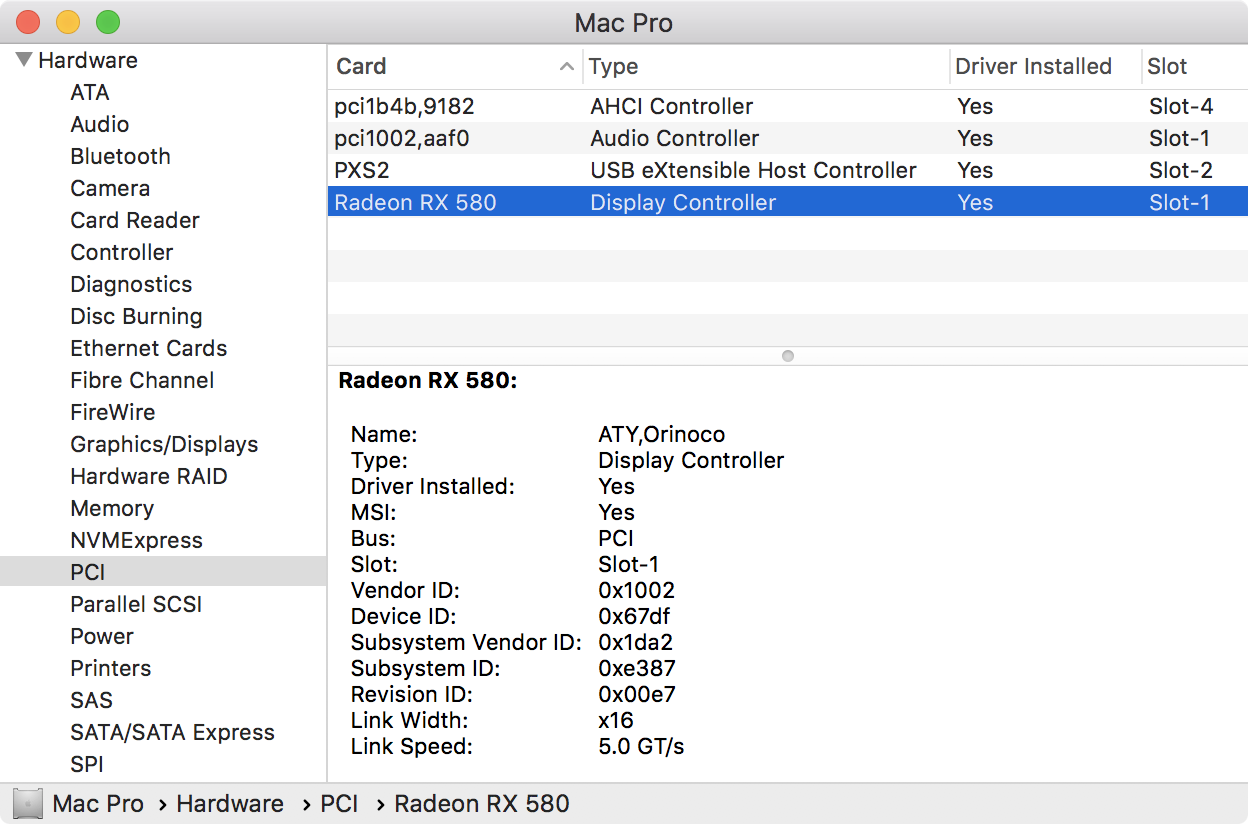

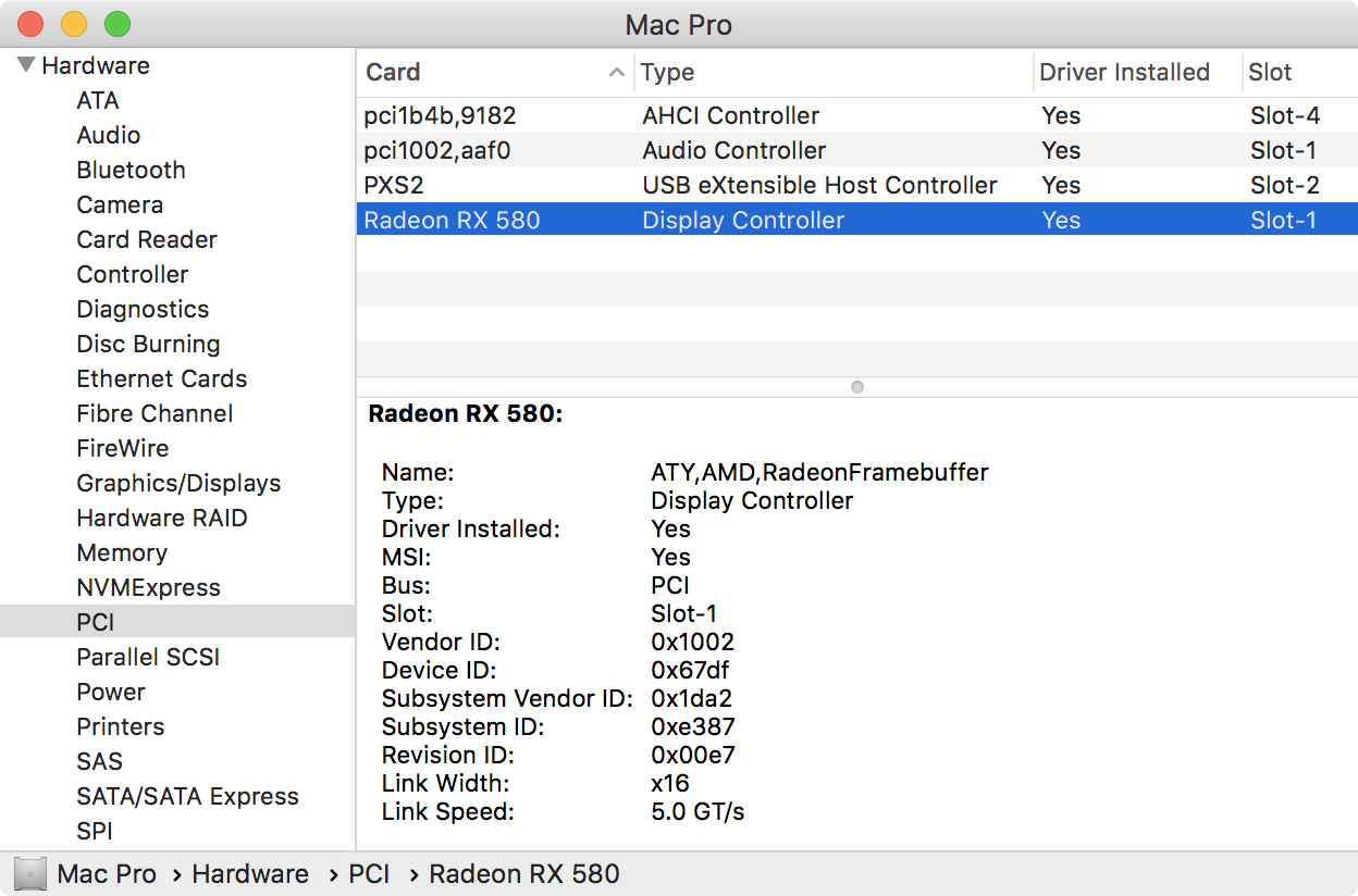

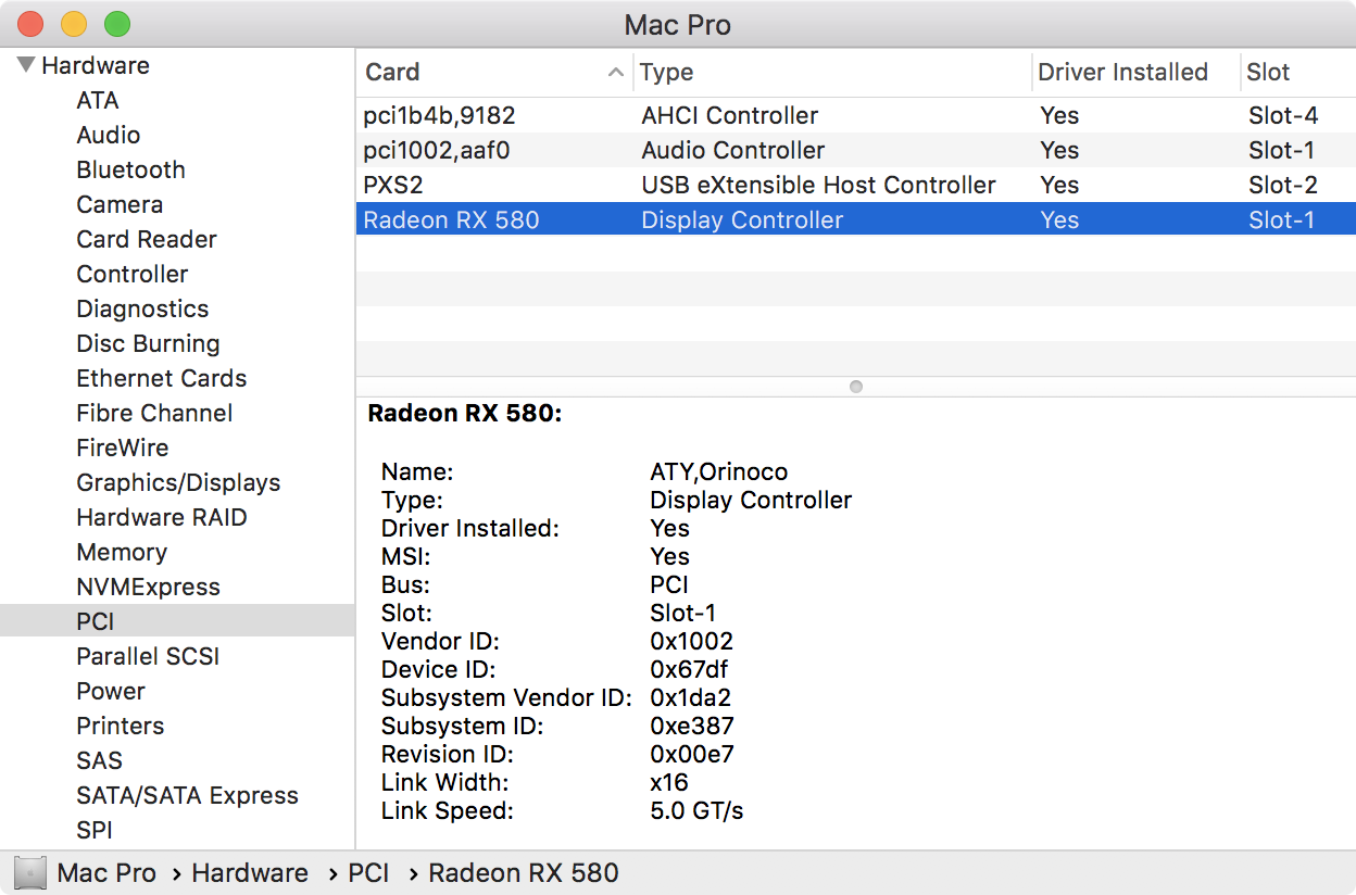

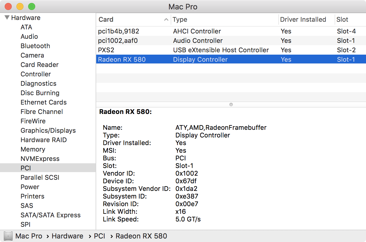

Sorry to hear that. May I know if you have Radeon Framebuffer
Or the Orinoco Framebuffer?
0089.B00 should makes no difference. I used that with my RX580 until 138.0.0.0.0 release, perfectly stable.
It seems that I have Orinoco. Don't know what's this Framebuffer, i'm gong to google it.
Also, I see that like me, the slot-1. (where is the RX 580) is listed twice. Once with "Audio Controller".
But next to that, I have no driver installed, while it seems you do have one (driver installed : Yes).
Could the problem come from that ?
