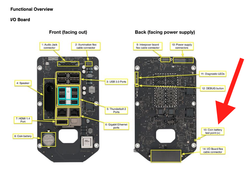

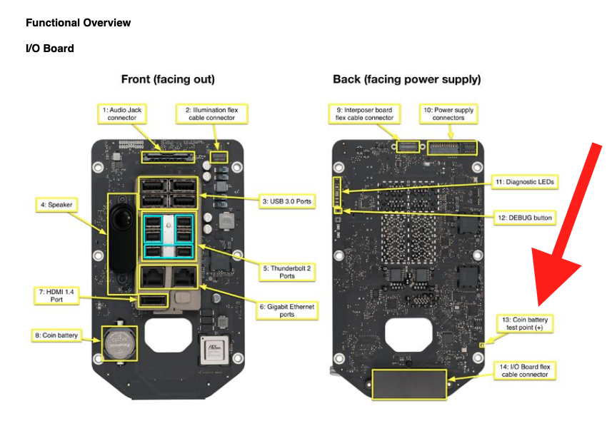

There are test points for the RTC battery on the I/O board:
Use the screw as the GND. You can download the service manual here:
Reactions: MrMacintoshBlog
You are the best! Thank you tsialex 👍
Tested 3.1v

Thank you again for this info, I'm so used to the 5,1 and below being very reliable. The 6,1 is a whole new beast to me.
I'm wondering if I am narrowing in on my issue. I mentioned above that memory is not being recognized in slot 1 and 2. Now I just found out that my d300 slot 1 GPU (slot 2 is showing fine) is not show up in system report. I'm wondering if the riser card is going bad. Does reseating the board ever fix issues?
You can try to clean it with some appropriated non-oily contact cleaner, like DeOxit. A lot of times is just oxidation and it's worth to try.
Btw, it's probably cheaper to get a working decommissioned late-2013 Mac Pro to use it to diagnose your defective Mac Pro parts then to buy any parts that you suspect that went defective. You probably can buy a whole working D300 model just for the price of one GPU.
