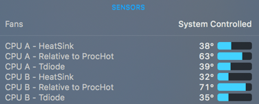

I’m really gonna look into this CPU issue, I did some more CPU demanding tasks on the Mac today and noticed a delta of almost 20°C between the 2 CPU...
Having some OS related issues right now but once that’s solved I’m totally taking the tray out and check out the thermal paste.
You should as 20C difference is not normal.. Mine is 4C difference when idling and 6C to 10C under medium to heavy CPU utilization.

So, today I redid both CPU and reapplied the thermal paste. I was with a friend who has a bit more experience in thermal paste application and who doubled checked my work and he confirmed that I applied it properly this time. I think last time I put too much.
Something I realize also is that Mac fans control, by default, is basing BoostA on Ambient and BoostB on diode CPUB. So basically, BoostA was almost never running while BoostB was running much more often.
Somebody gave me great values to use as custom values for Mac fans control for my previous Mac Pro 2009 but it was a single CPU.
Has anybody good custom values for Mac Fans Control for a double CPU cMP? Apparently the ones that comes by default aren’t that great.
I didn’t run the Mac for long because we had to leave early but the difference in temperature was between 1 and 2°C a few minutes after boot. I’ll try a stress test this week and check where that leaves me.

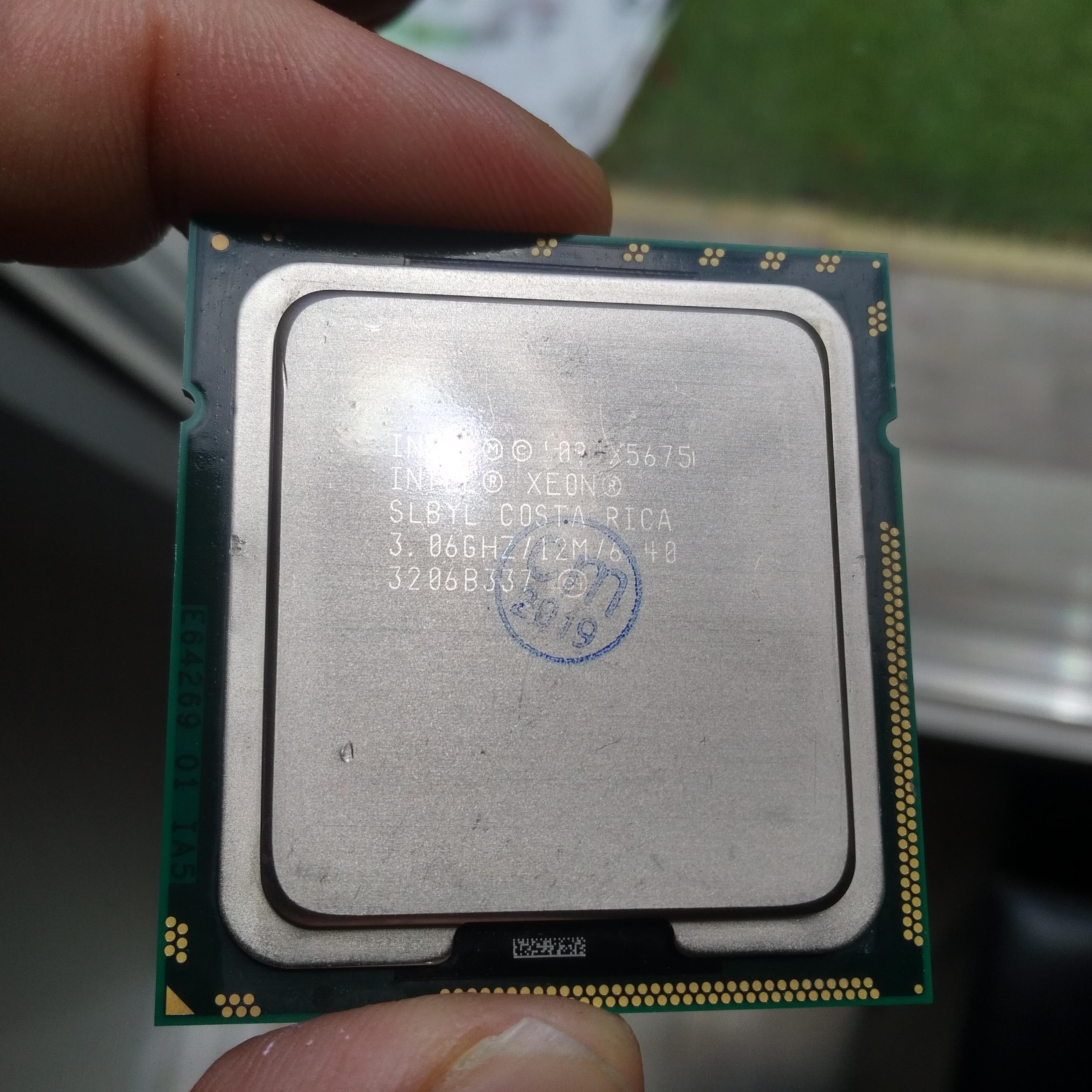

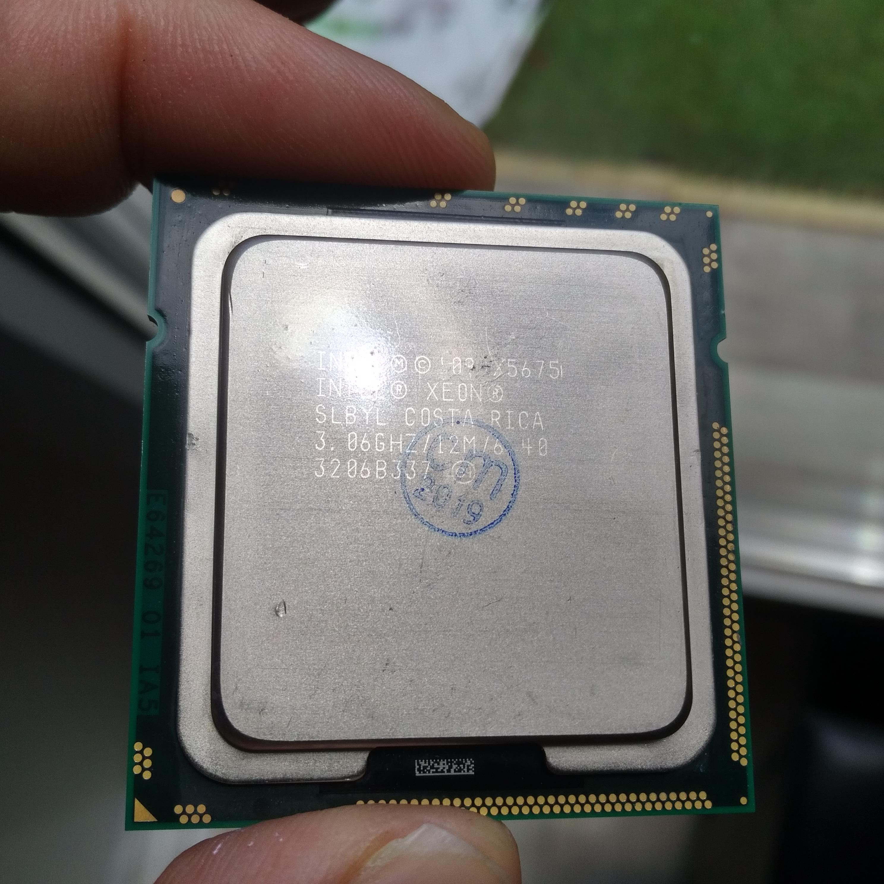

Hi everyone, new to this forum.
Mac pro 2009 mono cpu (stock mono 2,66) updated to 5.1, high sierra with bootrom MP51.0089.B00 BootROM

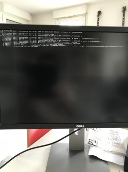

CPU update fail !! Trying to install a x5675 bought on ebay

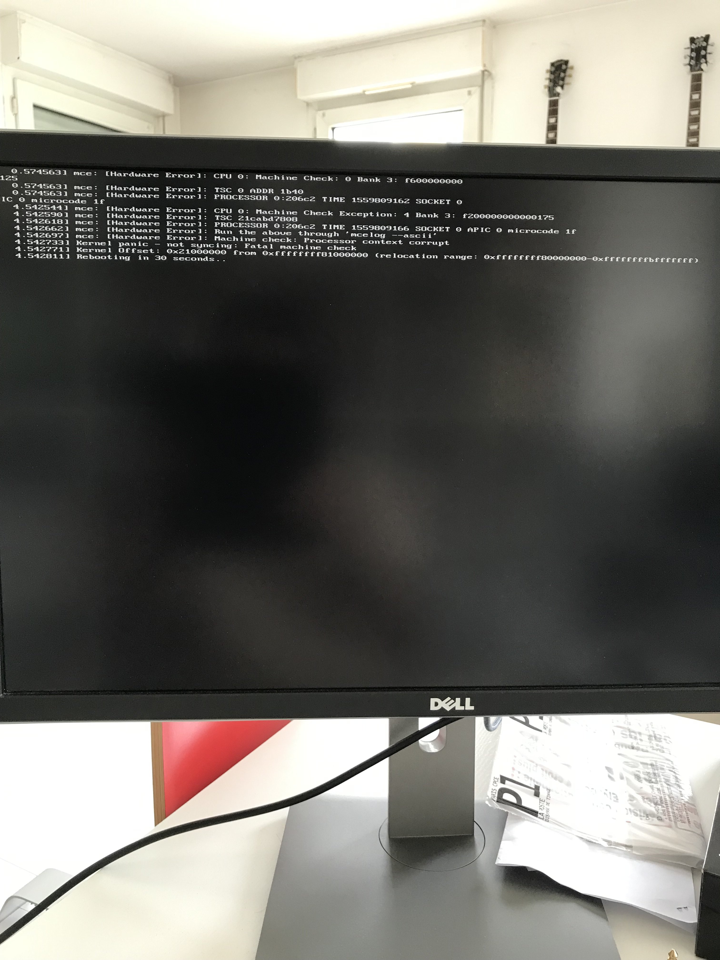

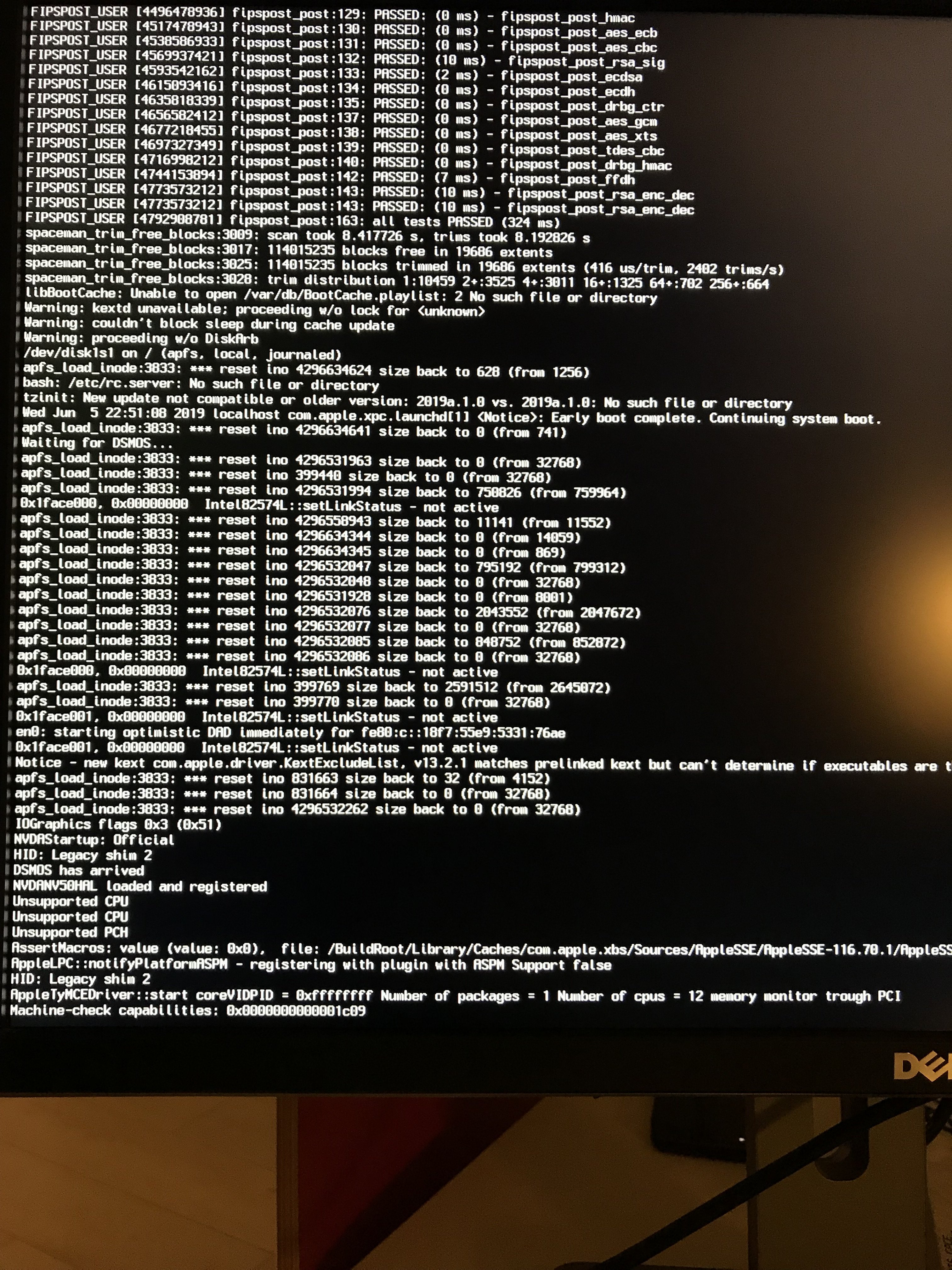

After cpu change and new thermal paste, at first boot I had a apple logo + progress bar stuck at 75%.
Did a pram and smc resest (several times, event 10 times pram reset) no success.

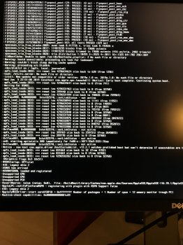

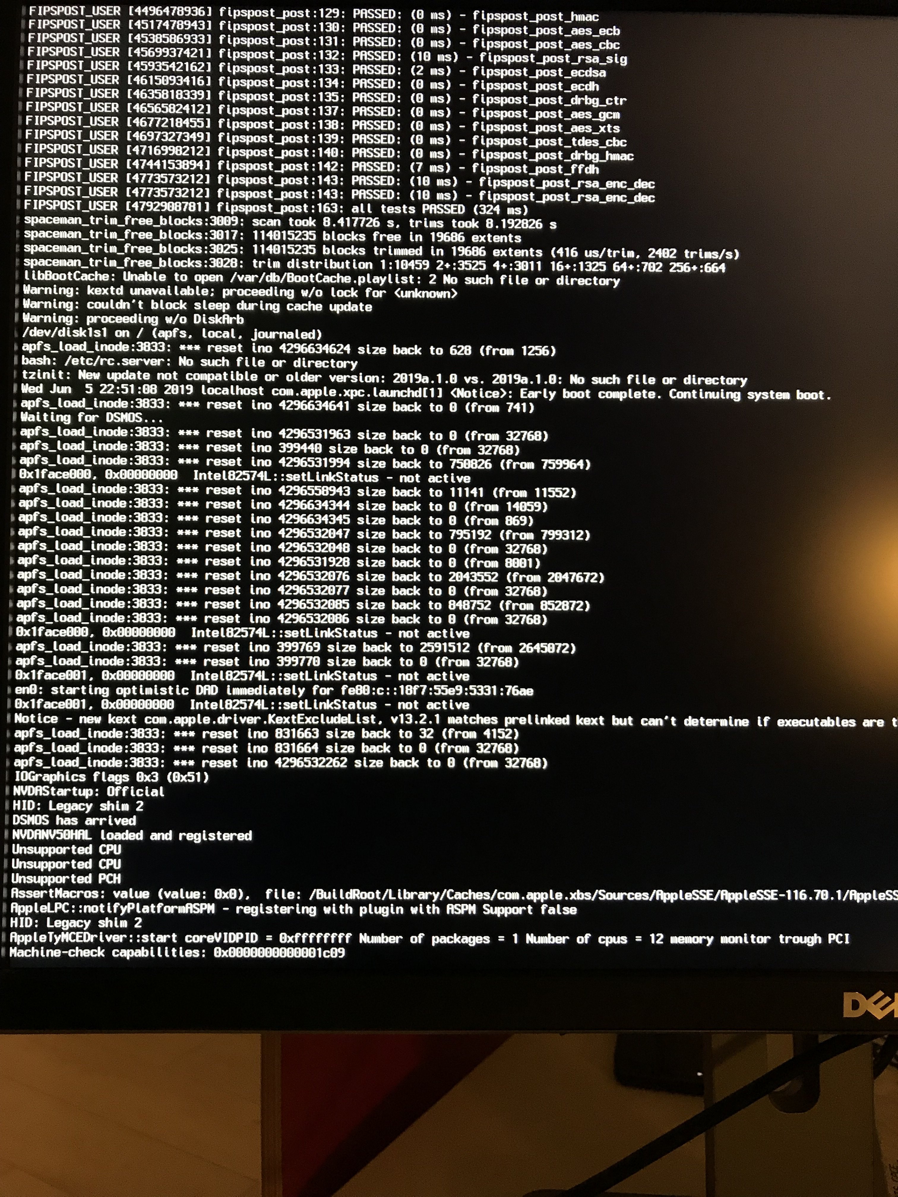

verbose mode says "unsupported cpu unsupported pch"

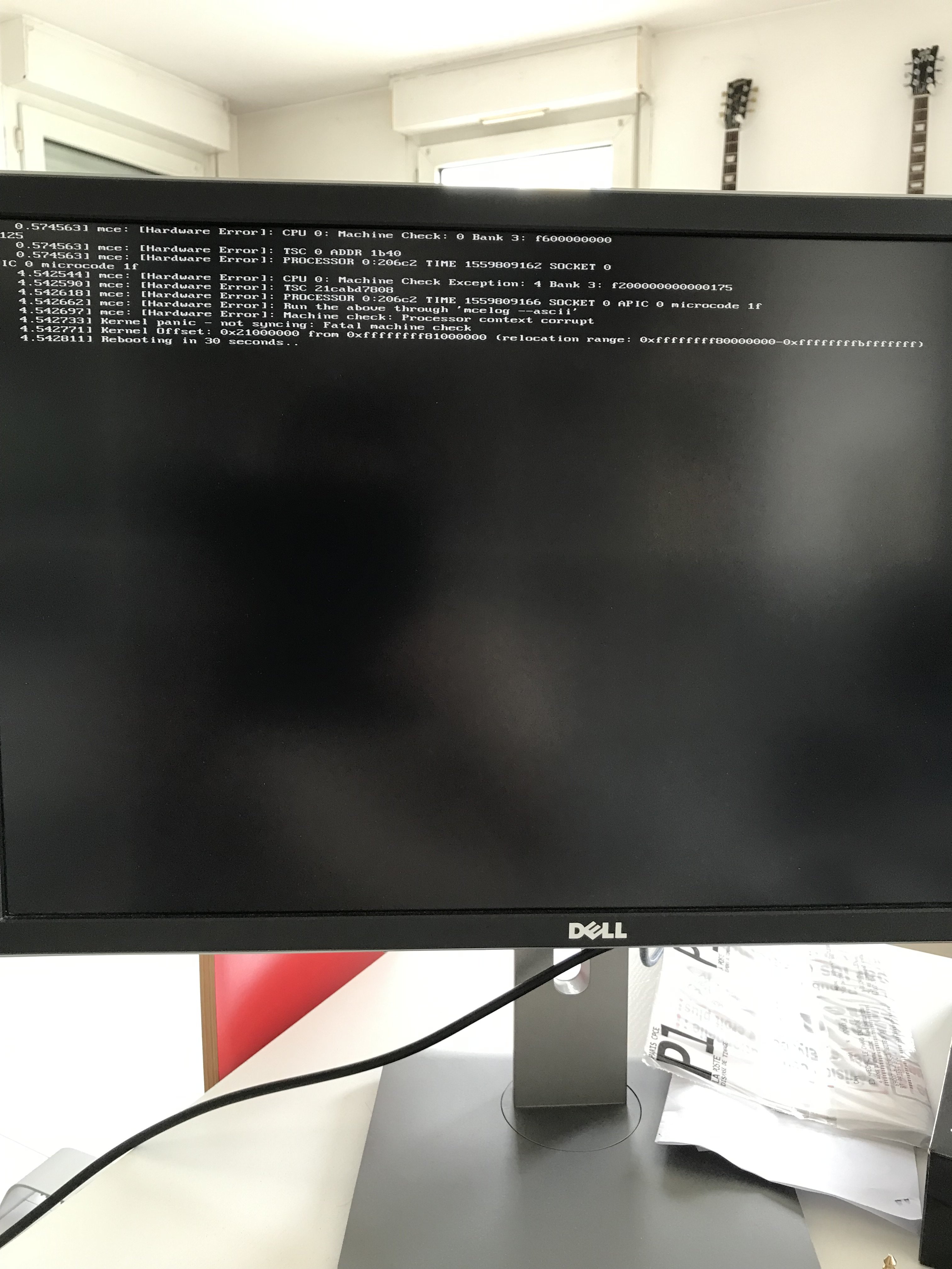

Tried to boot with latest sysrescuecd linux live, gave me a kernel panic at boot with cpu blabla problem
No red light in the cpu tray board
Pictures for the verbose mode
Strange thing : after the FIRST pram reset the verbose told about the cpu family, model number and speed, never after that.
Any clue ?

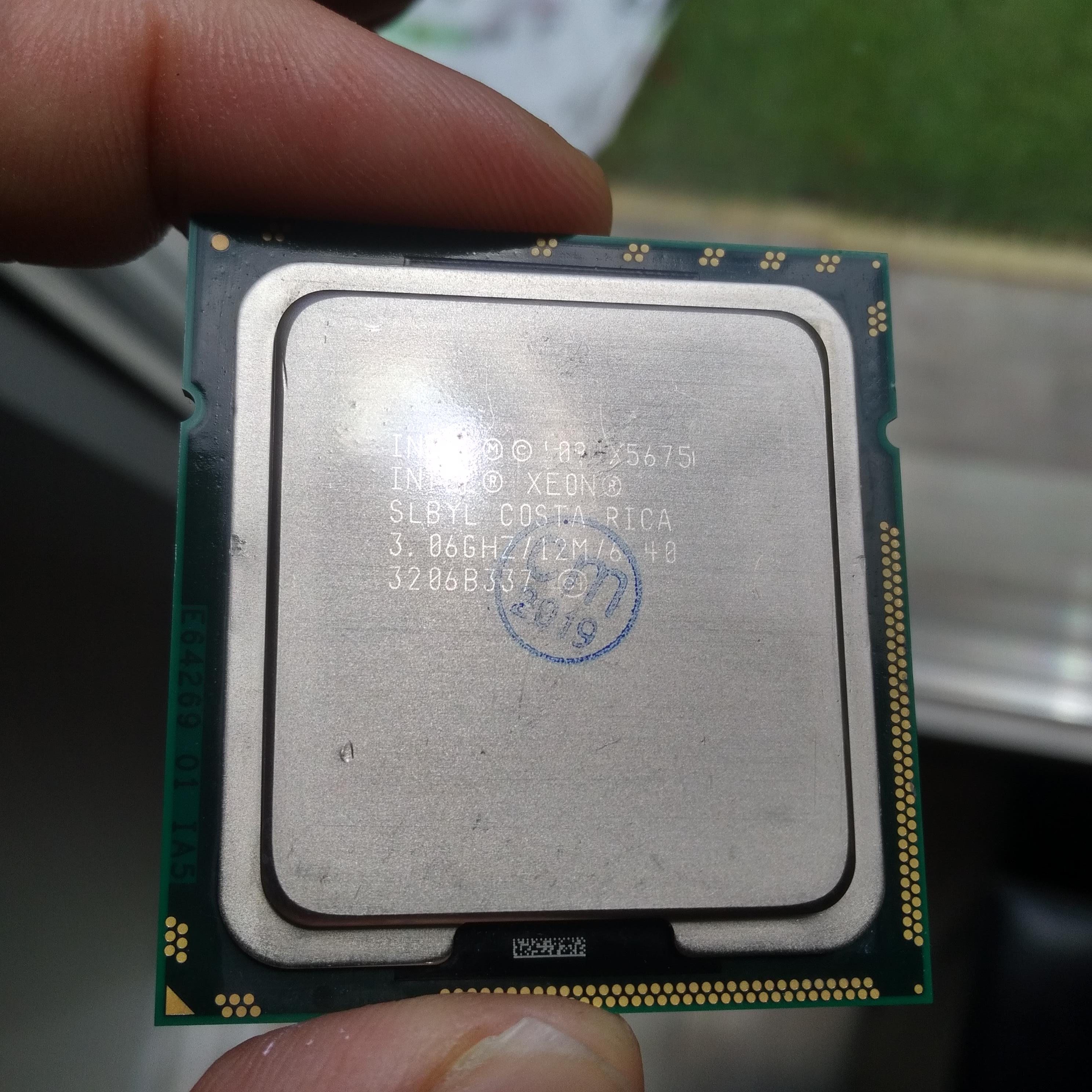

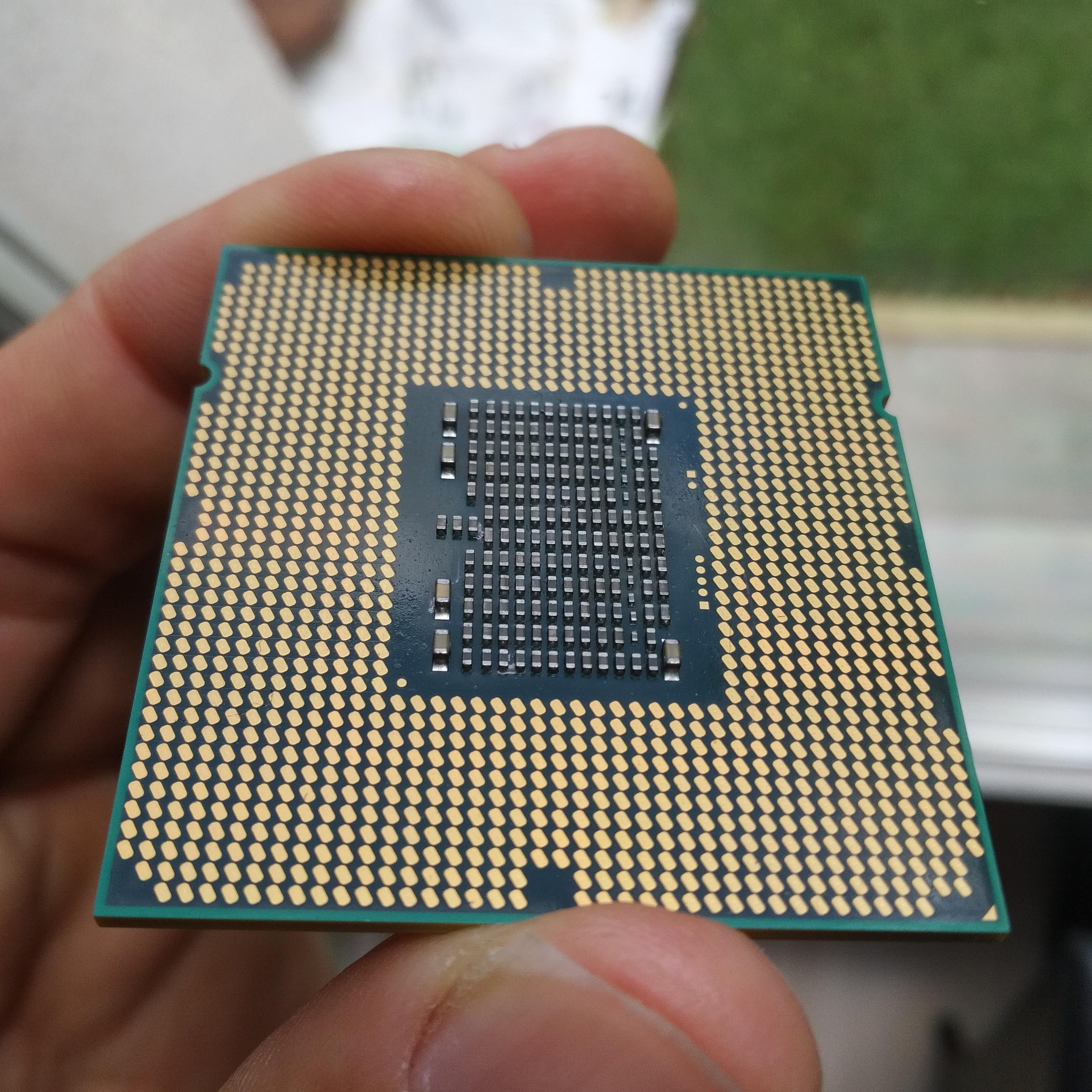

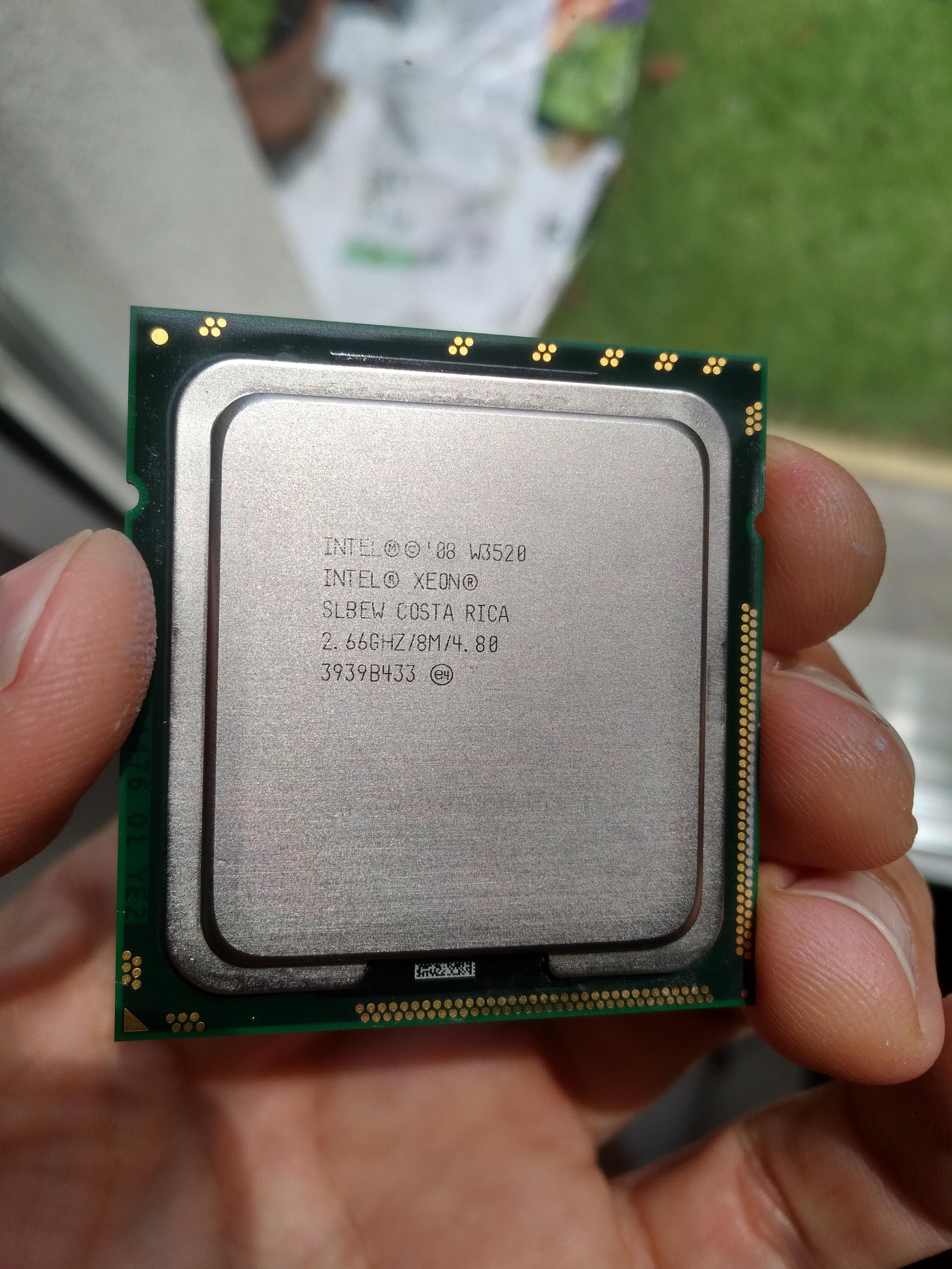

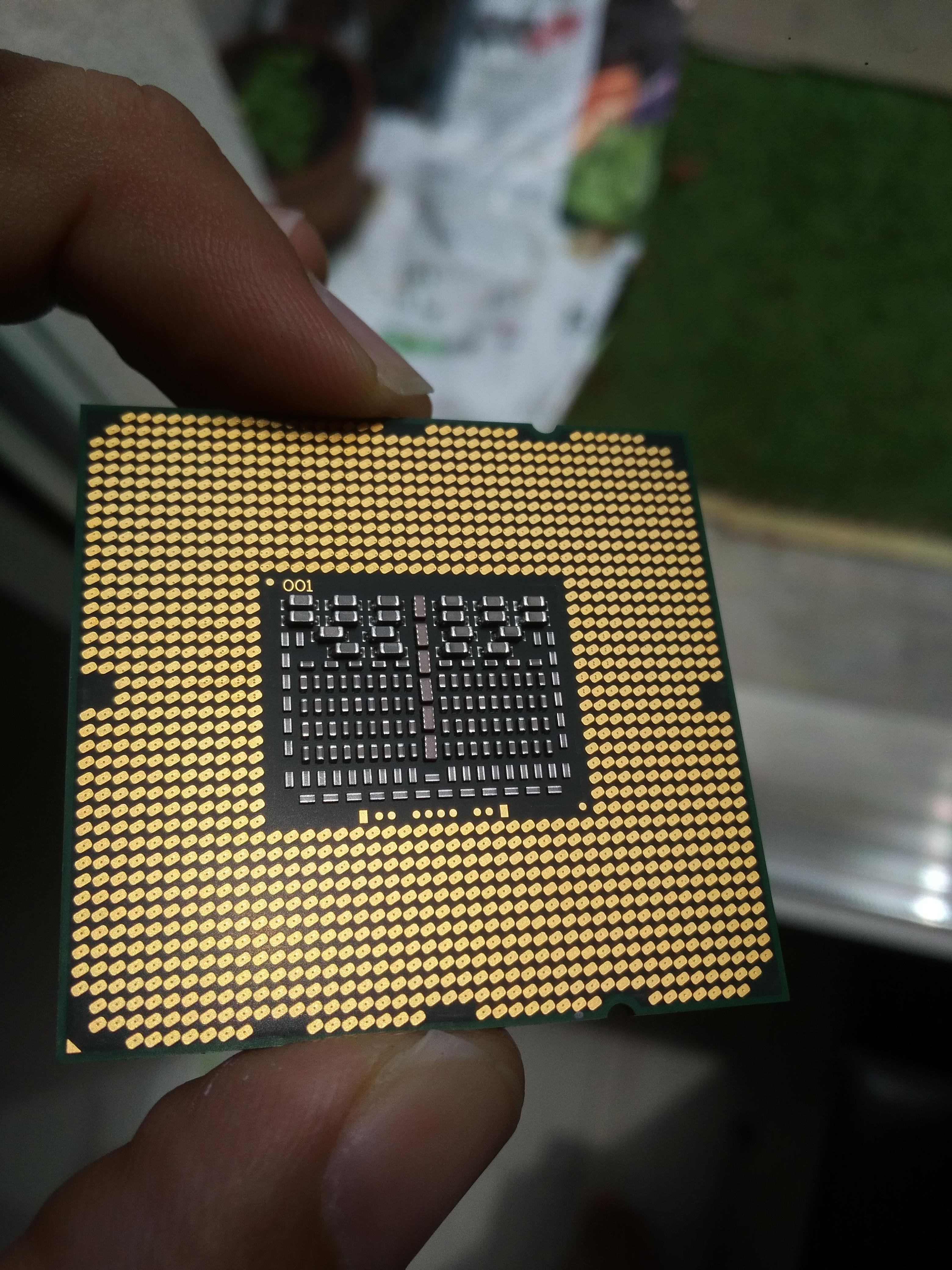

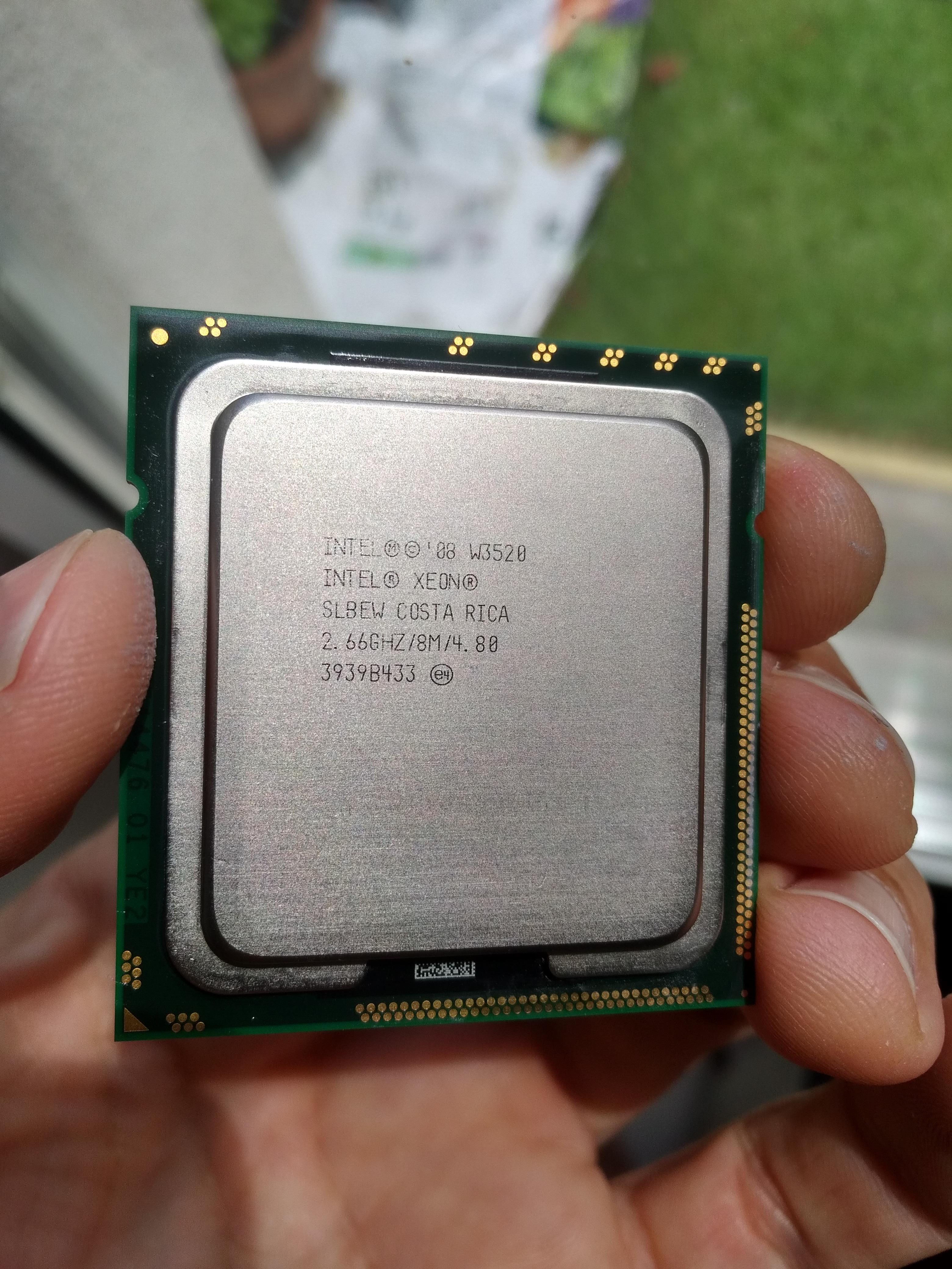

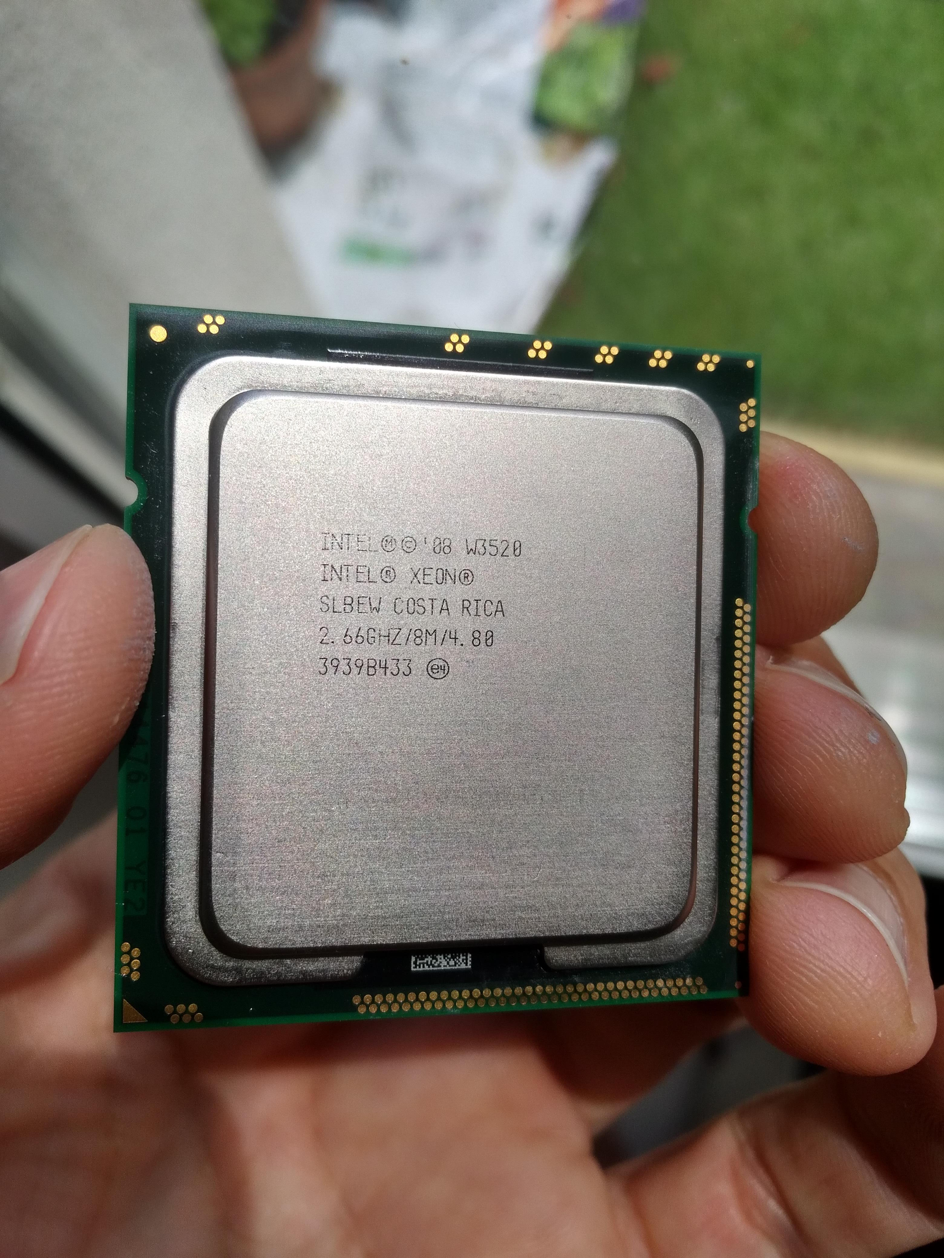

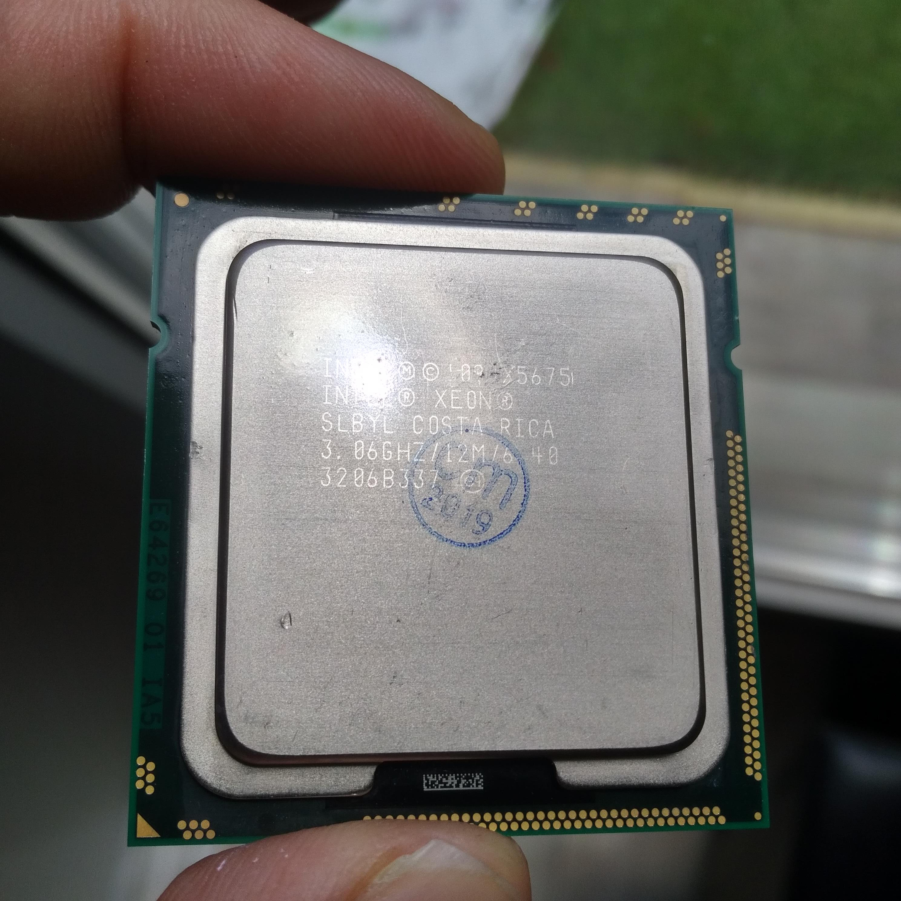

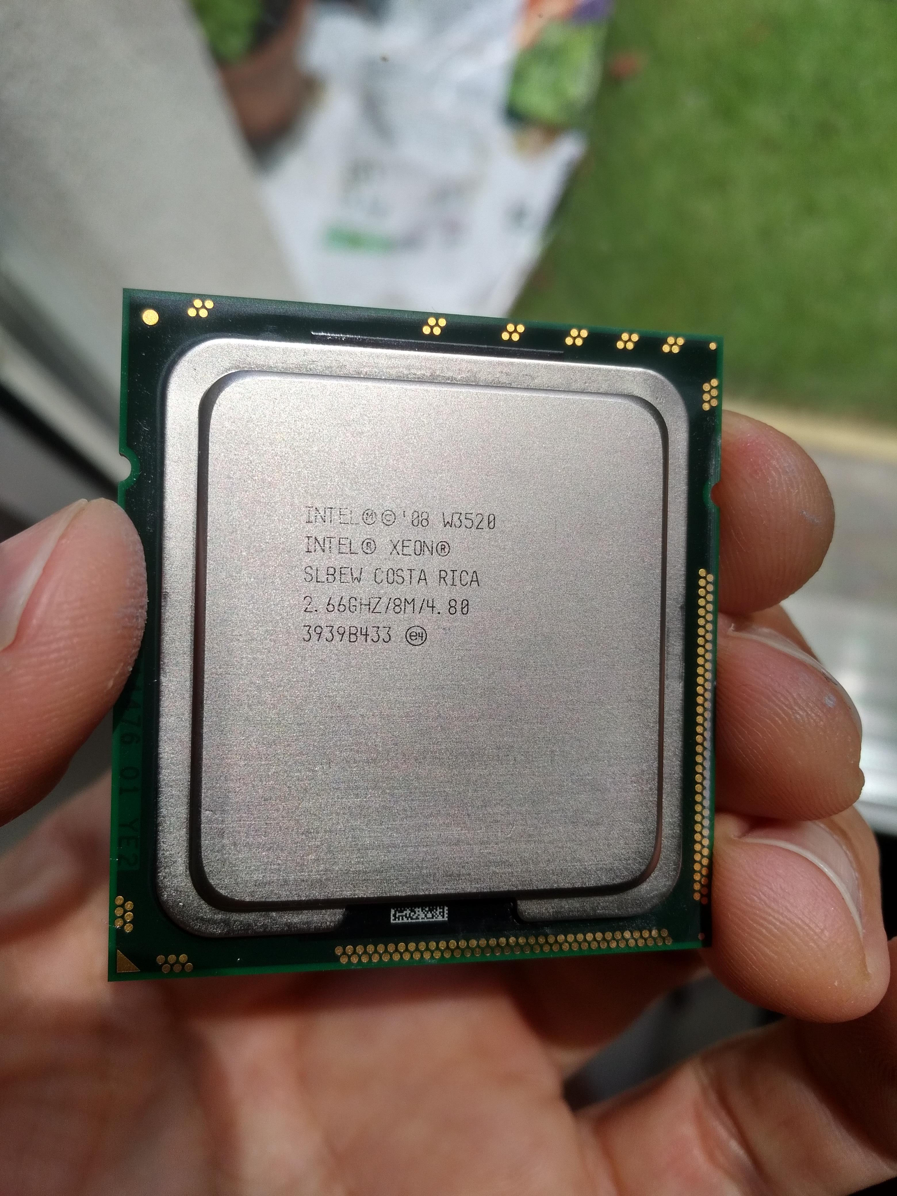

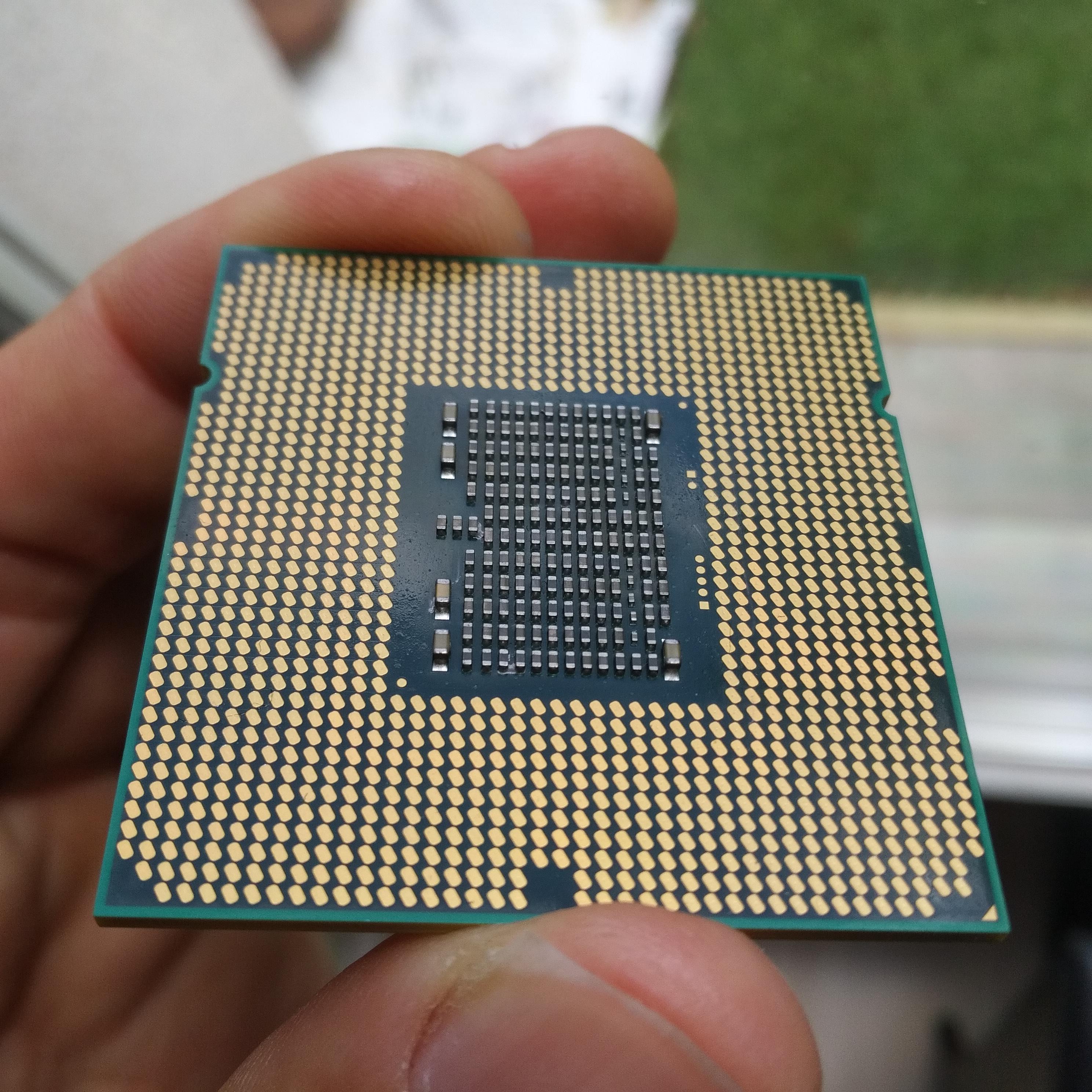

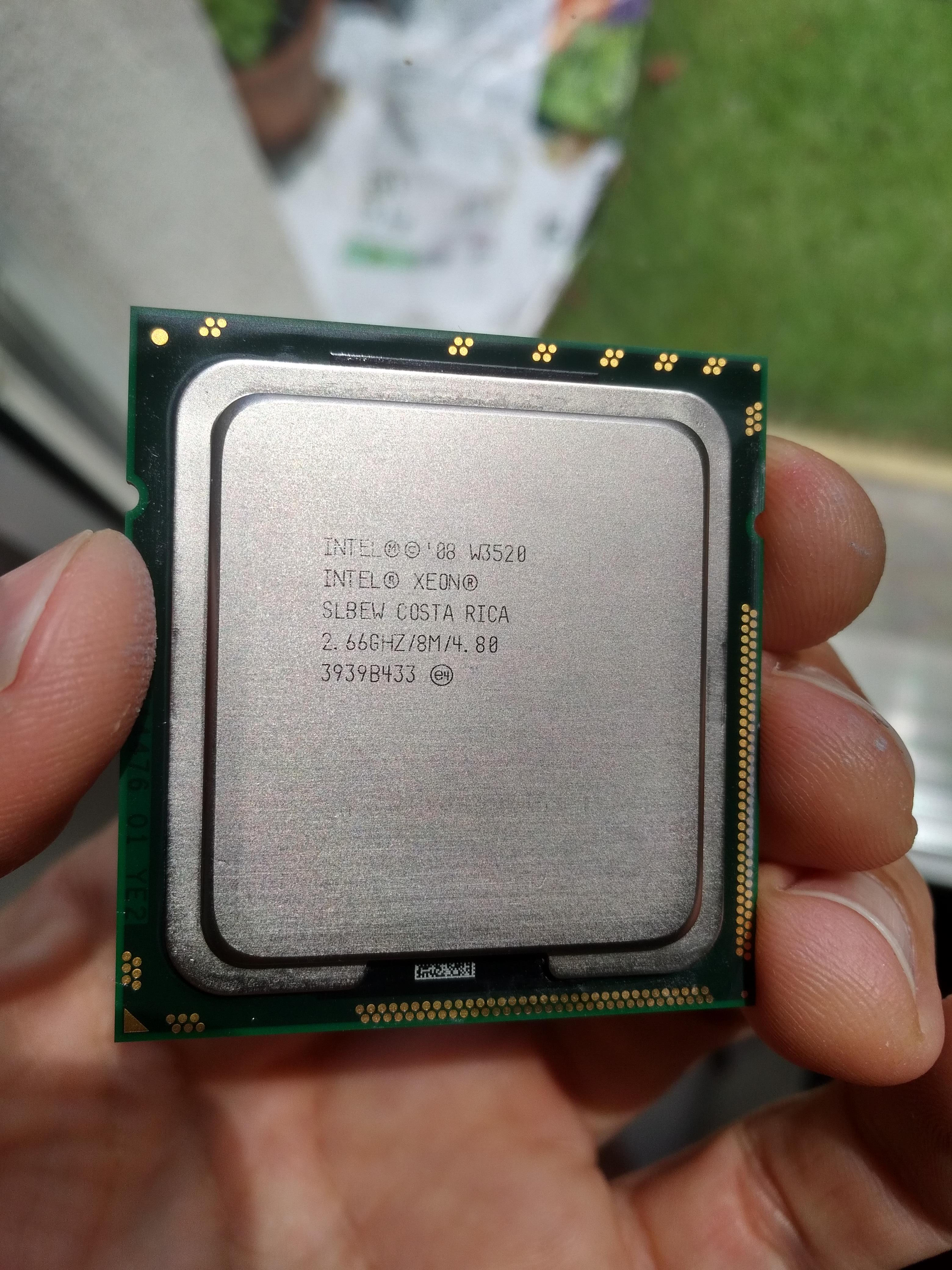

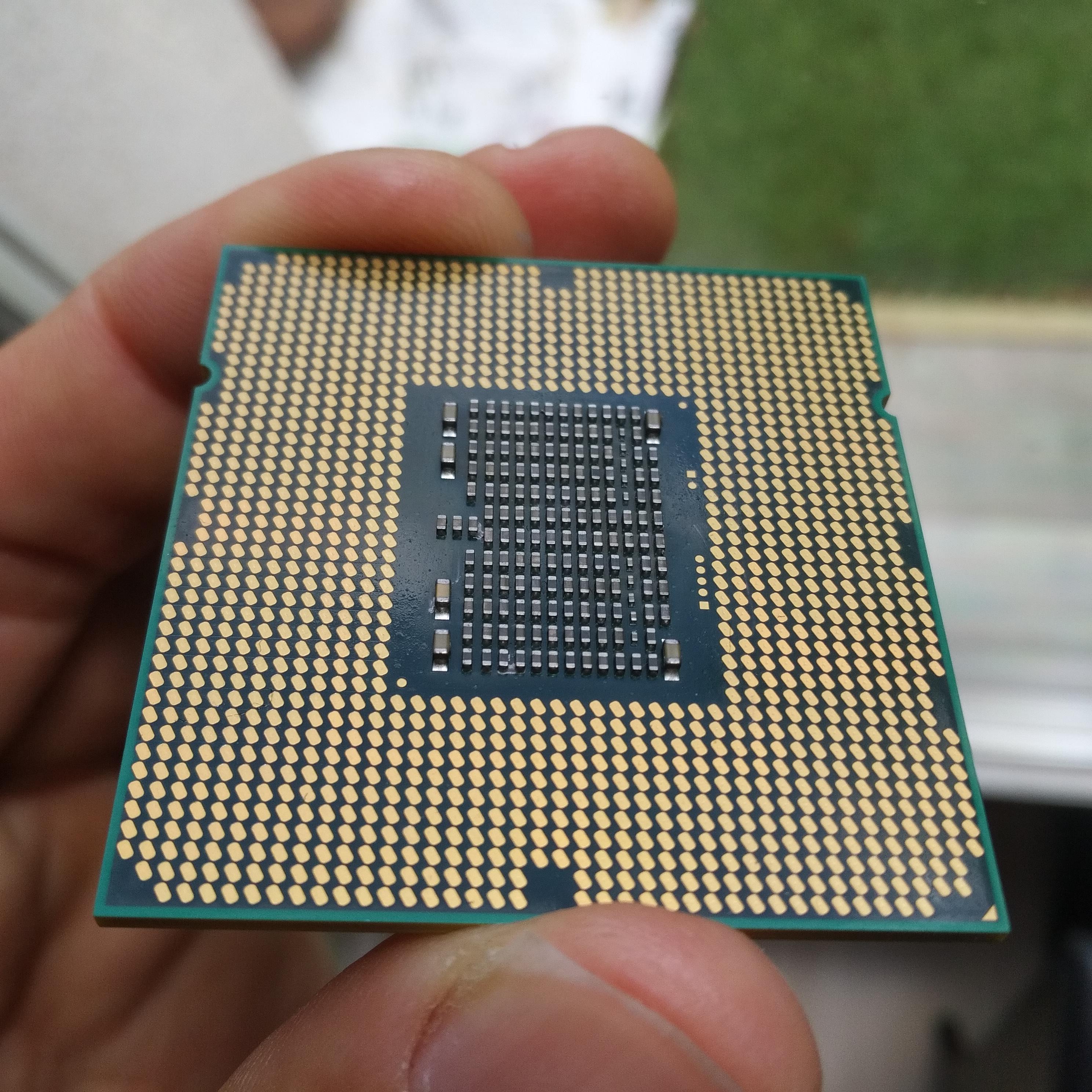

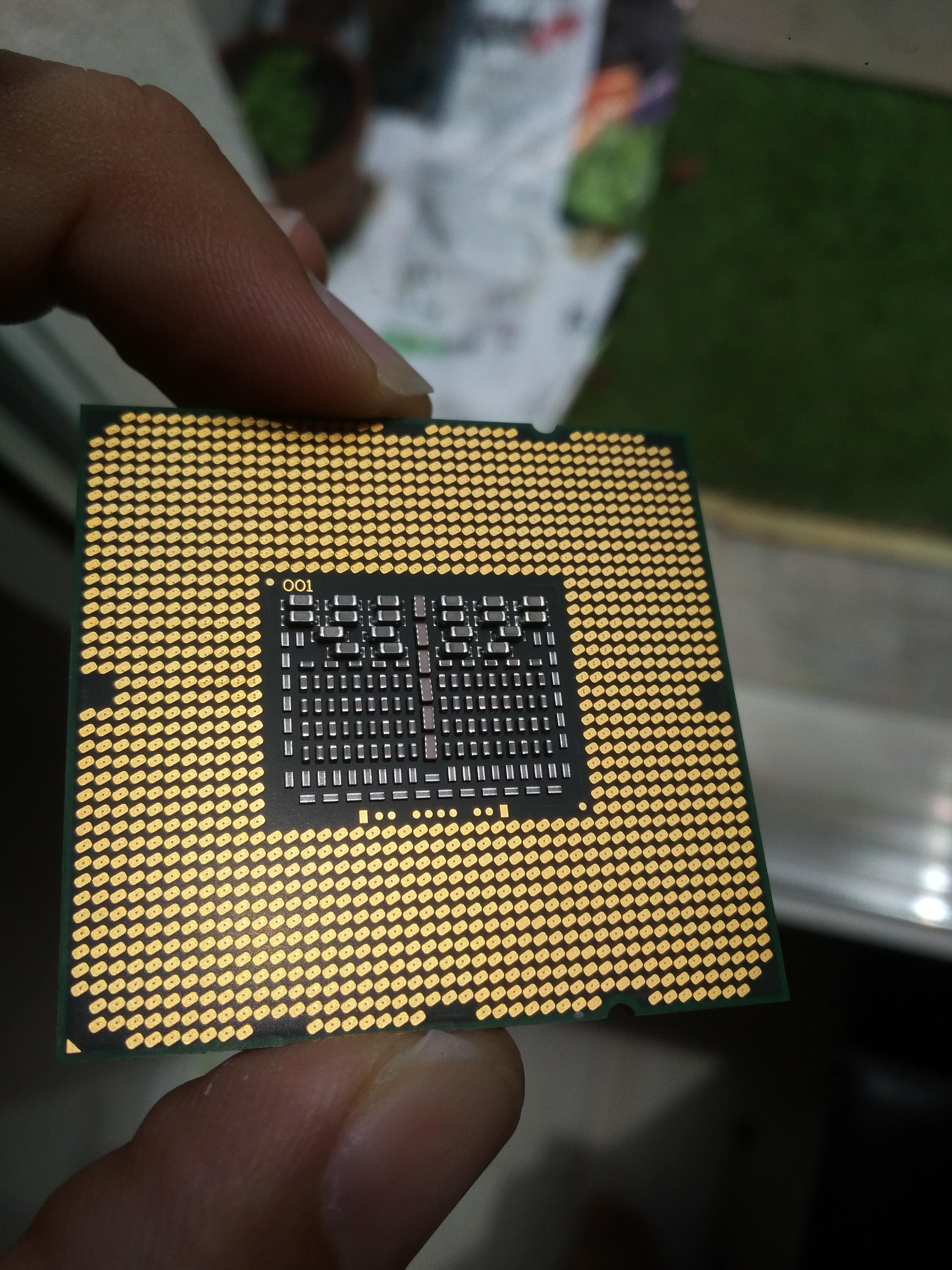

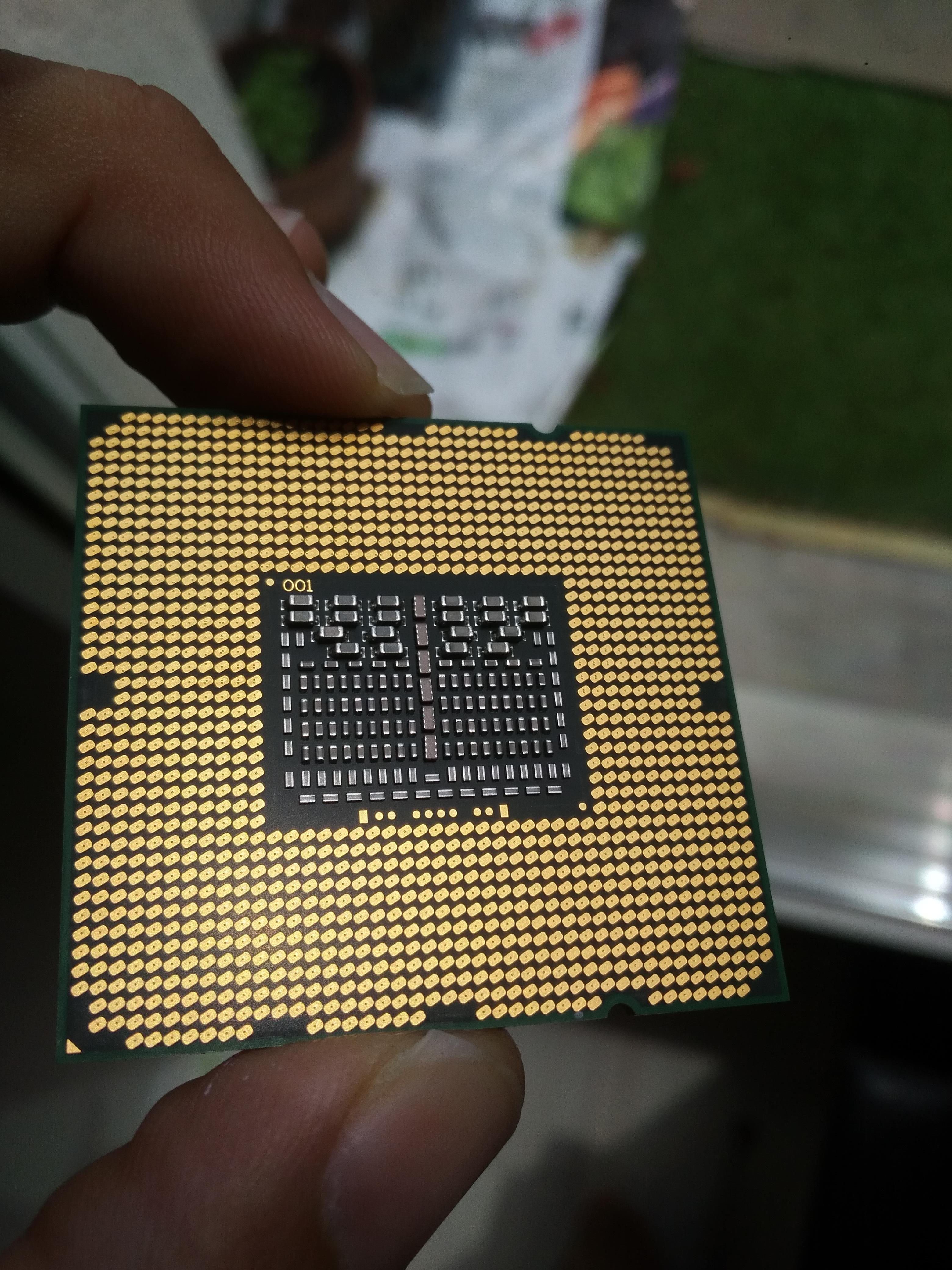

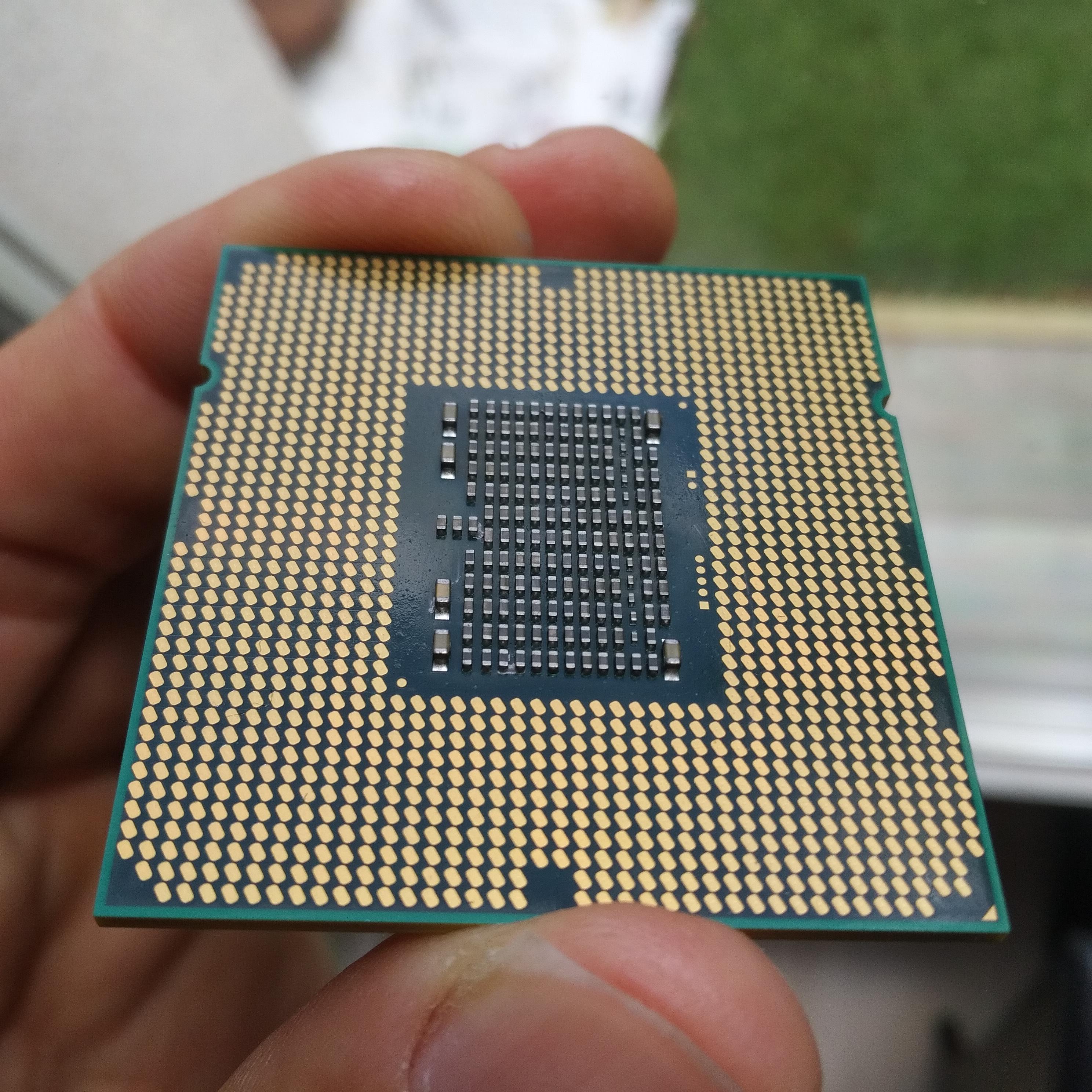

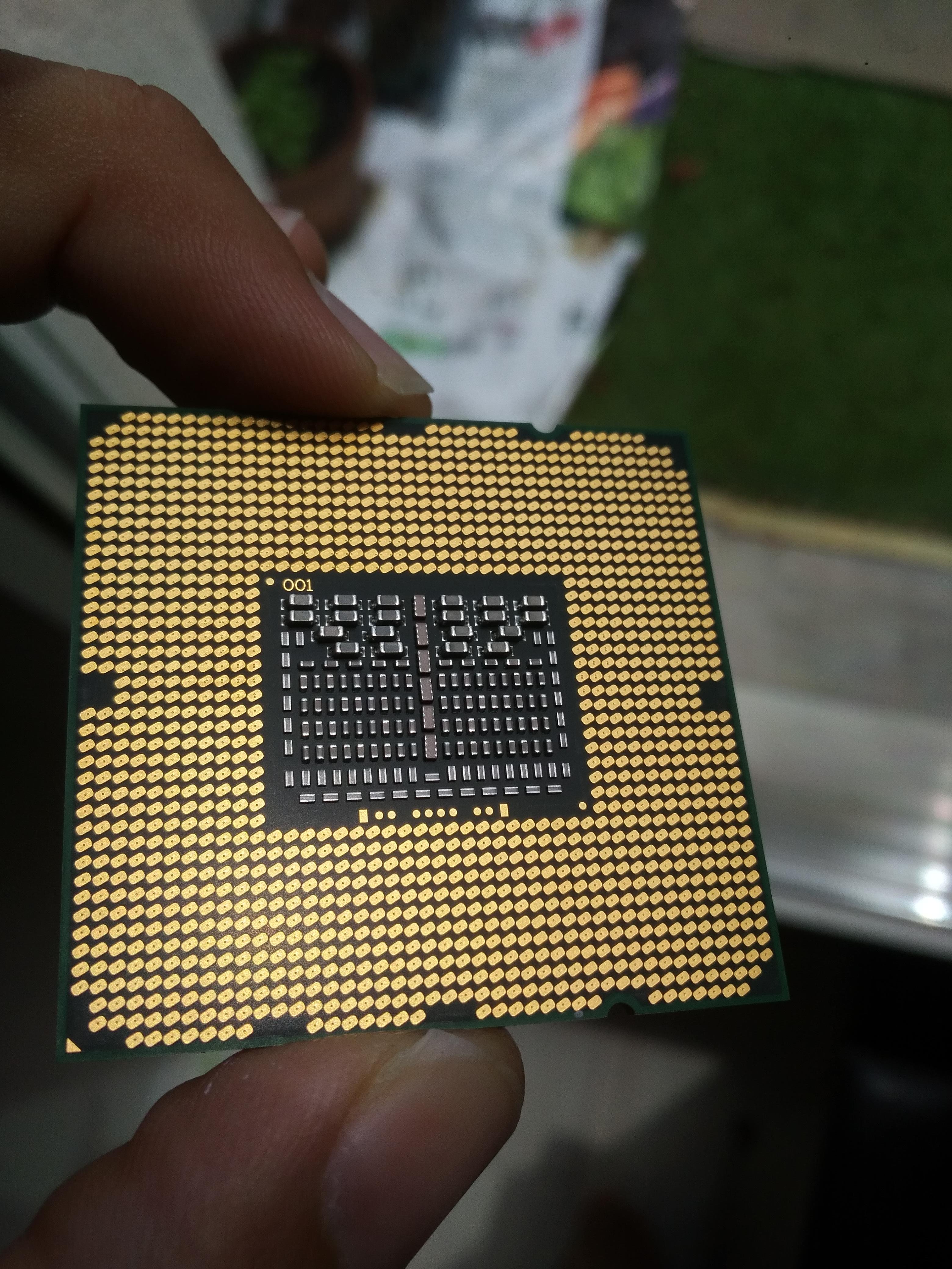

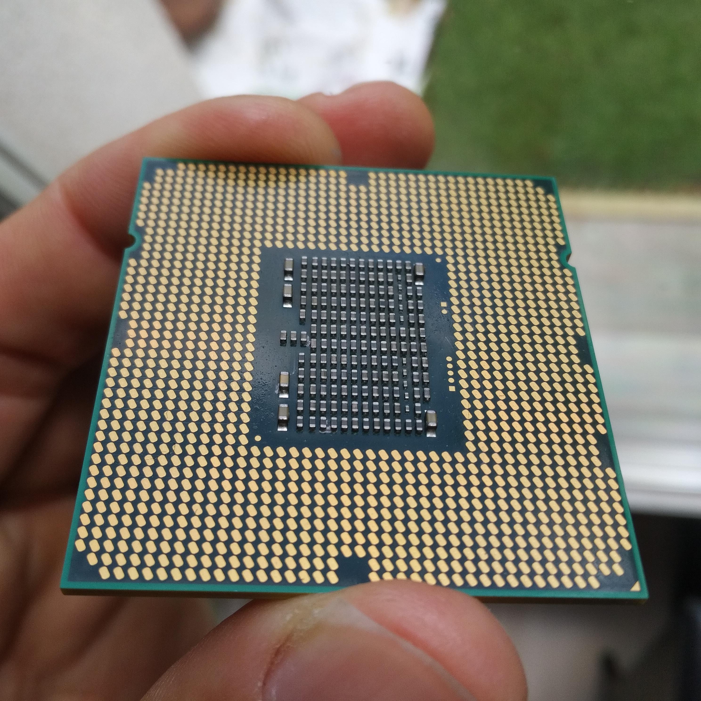

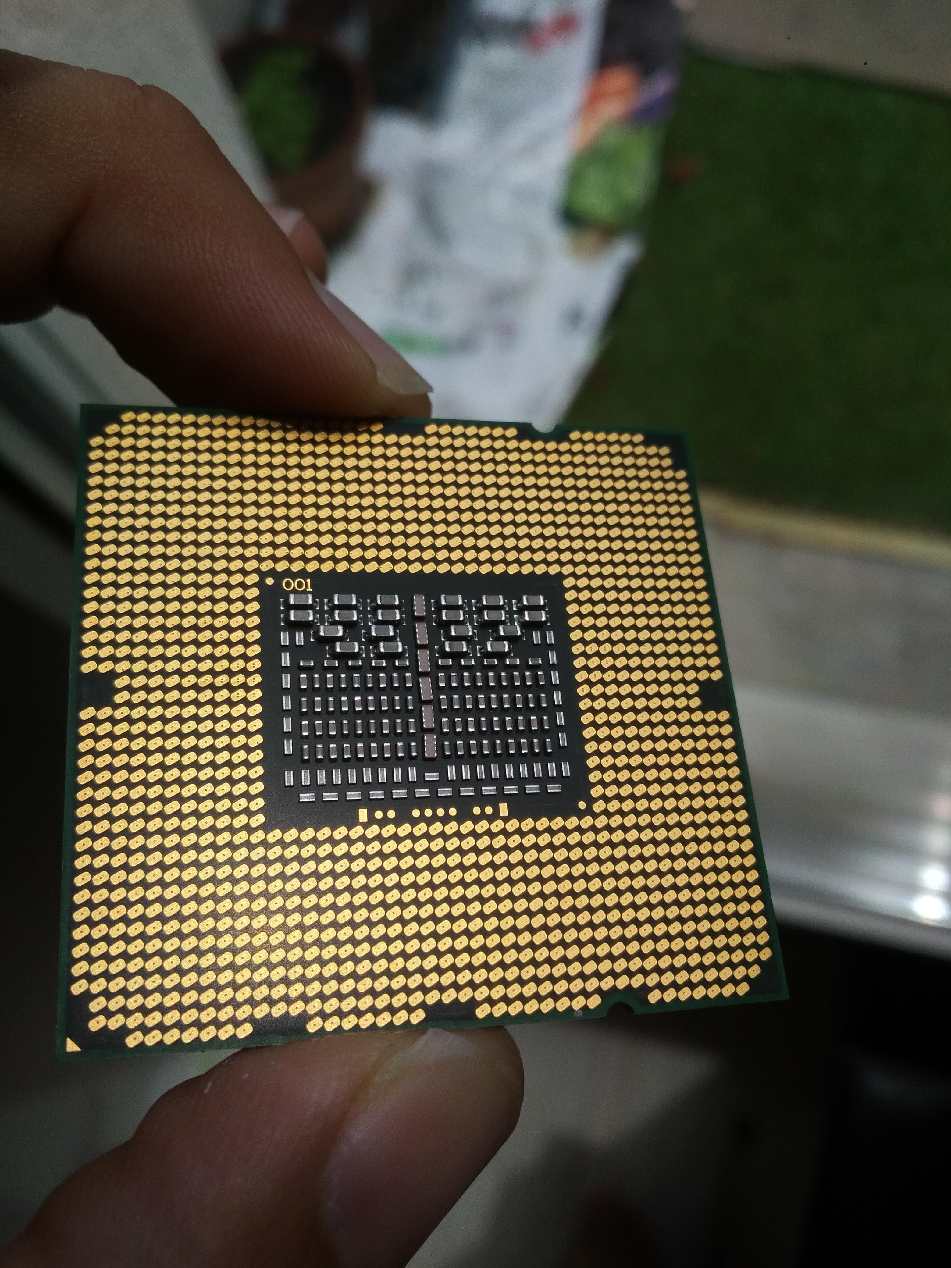

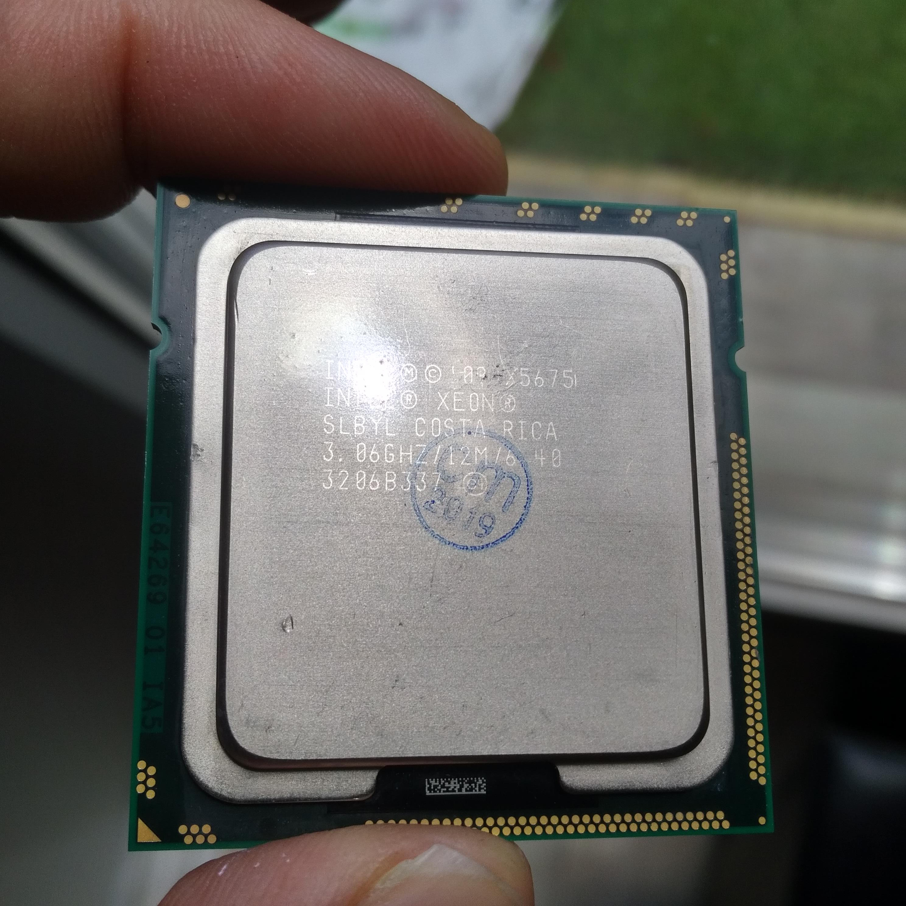

For info, I am trying to reinstall the cpu with a new cleaning of both surfaces, here are the pics x5675.jpg w3520.jpg w3520-back.jpg x5675-back.jpg
For the 144..... bootrom I need a metal compatible graphic card (I have a sapphire radeon rx 580 nitro + but I am waiting for the power cable, so for now I am stuck with apple original nvidia gt 120, and with it if I am not wrong, there is no woay to update firmware because mojave installer tells me I need the card)
For info, I am trying to reinstall the cpu with a new cleaning of both surfaces, here are the pics View attachment 841230 View attachment 841231 View attachment 841232 View attachment 841233
Your problem is not BootROM related, all MP5,1 firmwares support your X5670.
You could have a defective processor, socket problem or maybe your RAM don't like to work with a 1333MHz Xeon - I know it's weird, but I have some old Kingston DIMMs that work perfectly with W3540/W3565 and don't work with X5680/X5677 at all.
Reactions: dustwashere
If I understand you well, the verbose mode reporting cpu unsupported coulb be the RAM incompatibility ? Wouldn't be a verbose ram problem ? Anyway I reinstall the x5675 and then try the ram reverse back to the 1066 mhz
It's one of the possibilities, but probably it's a defective CPU or something on the socket. Btw, you can't control RAM speed with a Mac Pro. Firmware checks the SPD and sets the speed accordingly with the memory controller support (1333MHz/1066MHz/800MHz for 1333 Xeons and 1066MHz/800MHz for 1066 Xeons).
No luck , reversing to 1066mhz ram sticks did not change, did pram reset again, still cpu unsupported verbose mode.
Seems the cpu is not working, trying to contact the ebay seller from China ...
