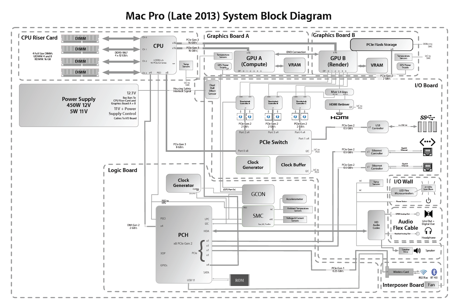

does E7-4890 V2 work on a mac pro 6,1?
Sorry if this has been asked already.
Only 32 PCIe lane available, seems not possible for 6,1. There is no user accessible BIOS setting to re-allocate PCIe lanes.
According to the Block Diagram, the 6,1 BIOS setting should be base on 40 PCIe lanes.
But if you can get this CPU for cheap, and have good return policy (or re-sell it). You may try it and report back if it works :D
Anyway, I assume you willing to take the risk that's a 155W TDP CPU, 25W higher than the E5-2697 V2.
Whats the worst that can happen?
No idea, possible unstable system, overheat, kill the logic board, etc.
Anyway, Just look into more details, E7-4890 us socket LGA-2011-1 (R2). But the 6,1 has LGA-2011 (R). So, you can save yourself some time for testing, it won't work.
