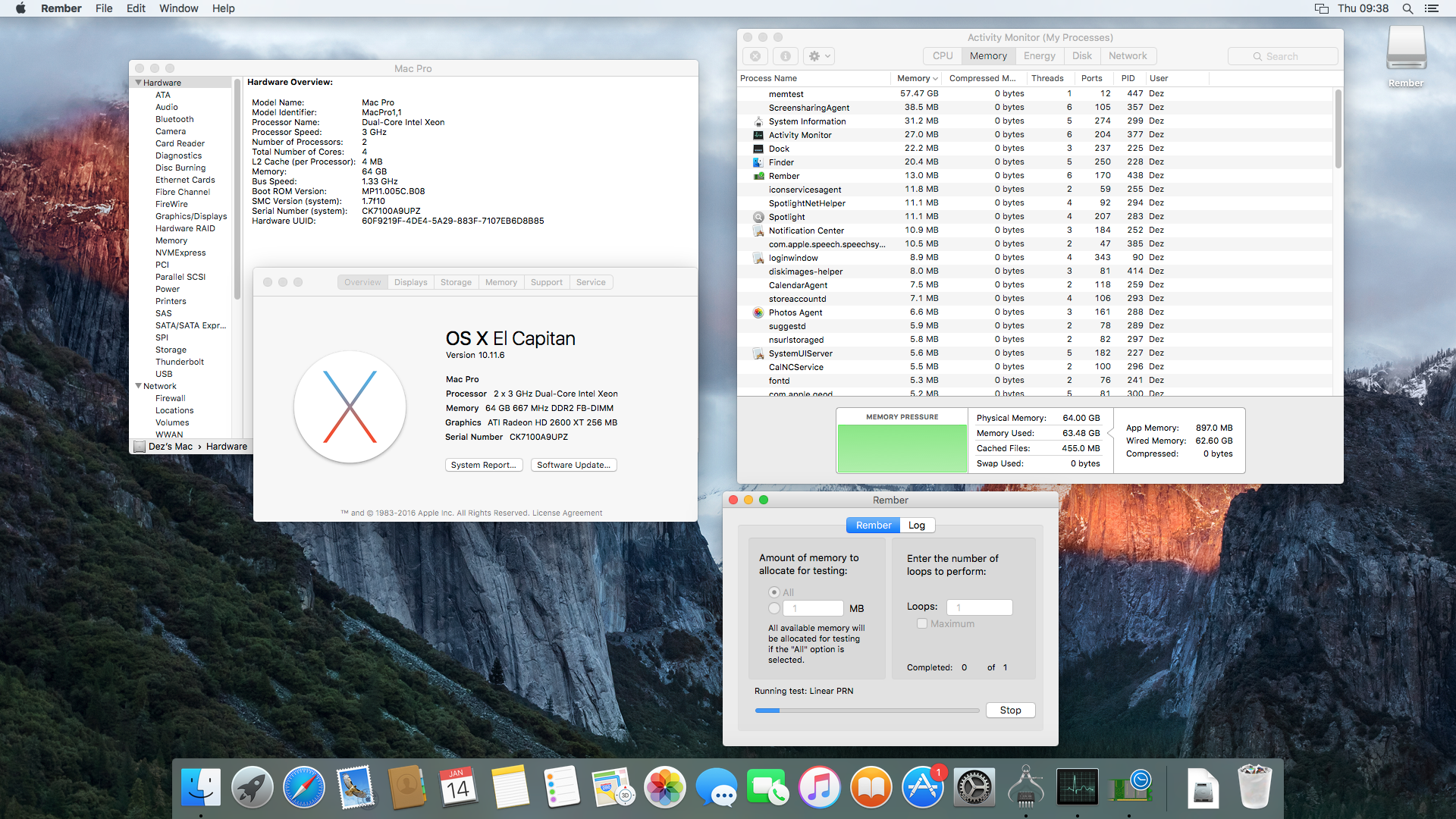

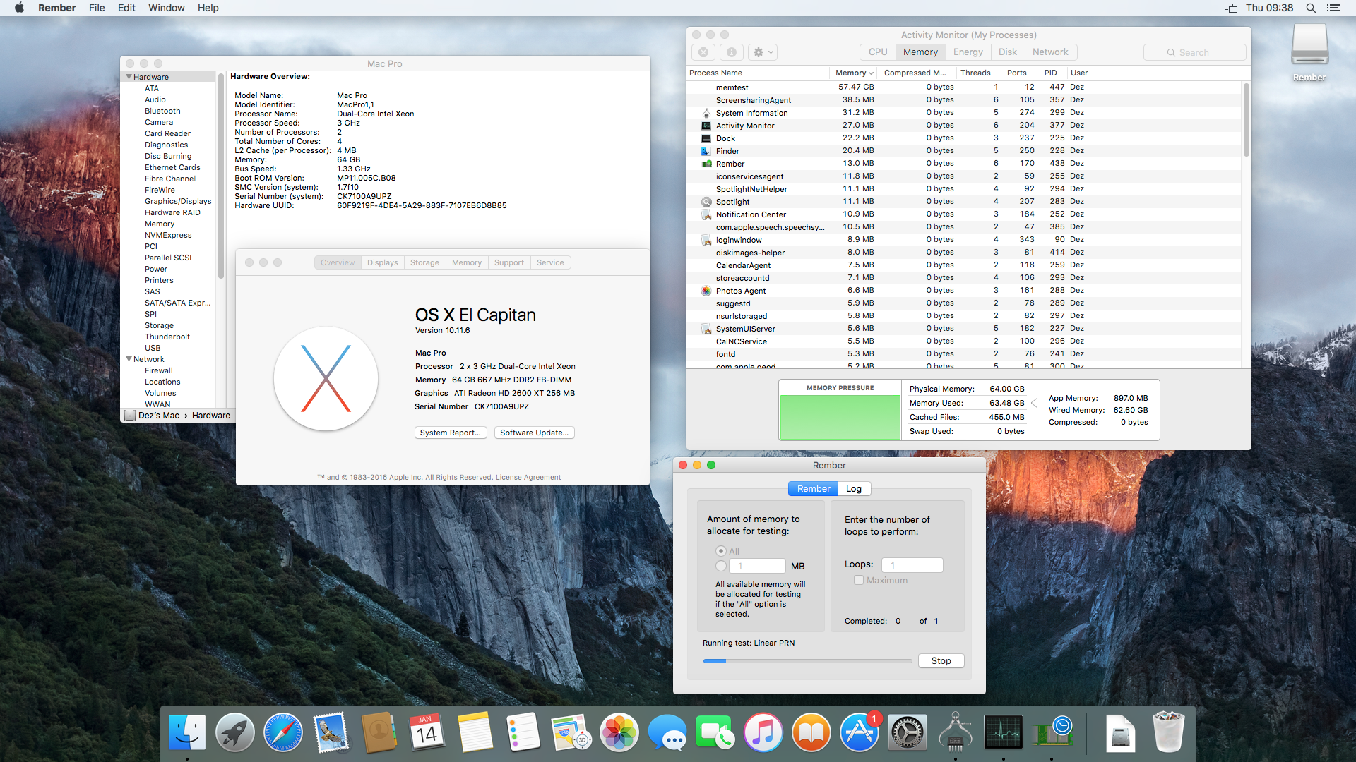

pleased to report that 64GB of RAM works in a MacPro1,1 without having to flash its firmware to MacPro2,1 firmware
this is something I have been wanting to test for a few years since it was discovered 64GB works with the 2,1 firmware, as I dont actually recall anyone actually tested the 8GB 2Rx4 sticks on a stock MacPro1,1 but for some reason it says in the Wiki on the first post/page that you need the MP2,1 firmware
a friend of mine did test 64GB of RAM in a MacPro1,1 for me a couple years ago when buying the RAM for his MacPro2,1s but he was not able to do in depth testing
but I finally got/found 8 2Rx4 8GB FB-DIMMs for cheap and I am pleased to report they do indeed work in a stock MacPro1,1 🙂
curiously older OS X versions like snow leopard will show 64GB in about this mac but only have 32GB usable (have to wonder if its a limit of the 32bit kernel mode SL runs in when running on a MP1,1), OS X El Cap has no problem using all 64GB as demonstrated above
and windows 10 64bit also saw all the RAM http://valid.x86.fr/229gxw
I also own an Xserve1,1 and I hope to test the 64GB of RAM in that machine as well 🙂

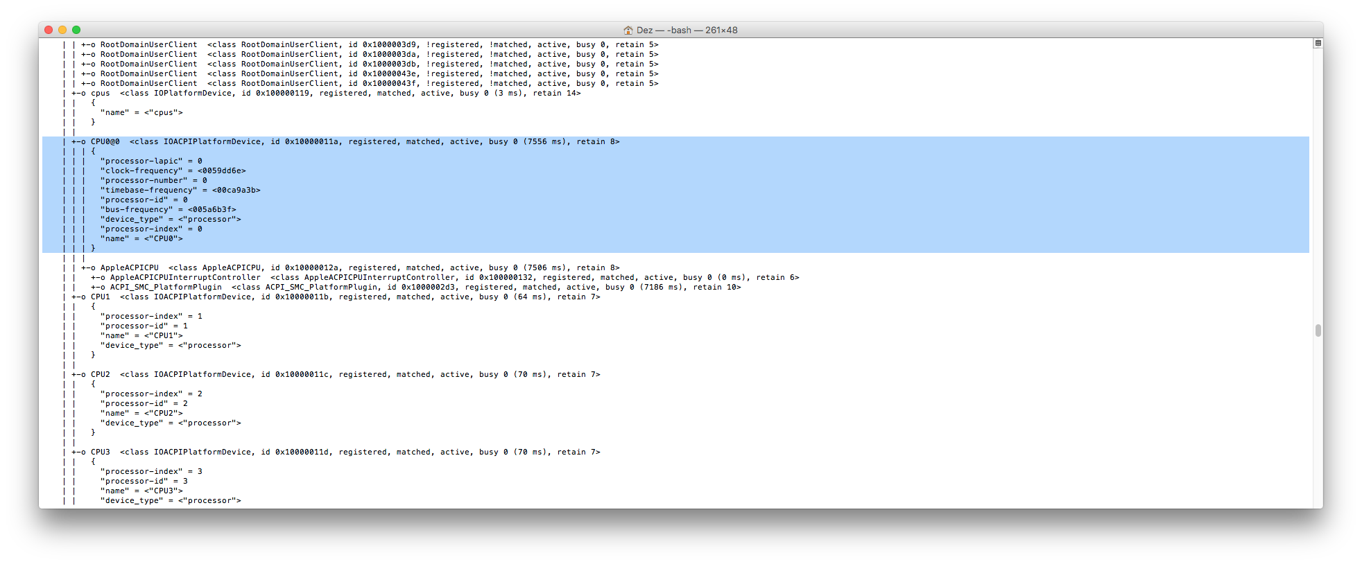

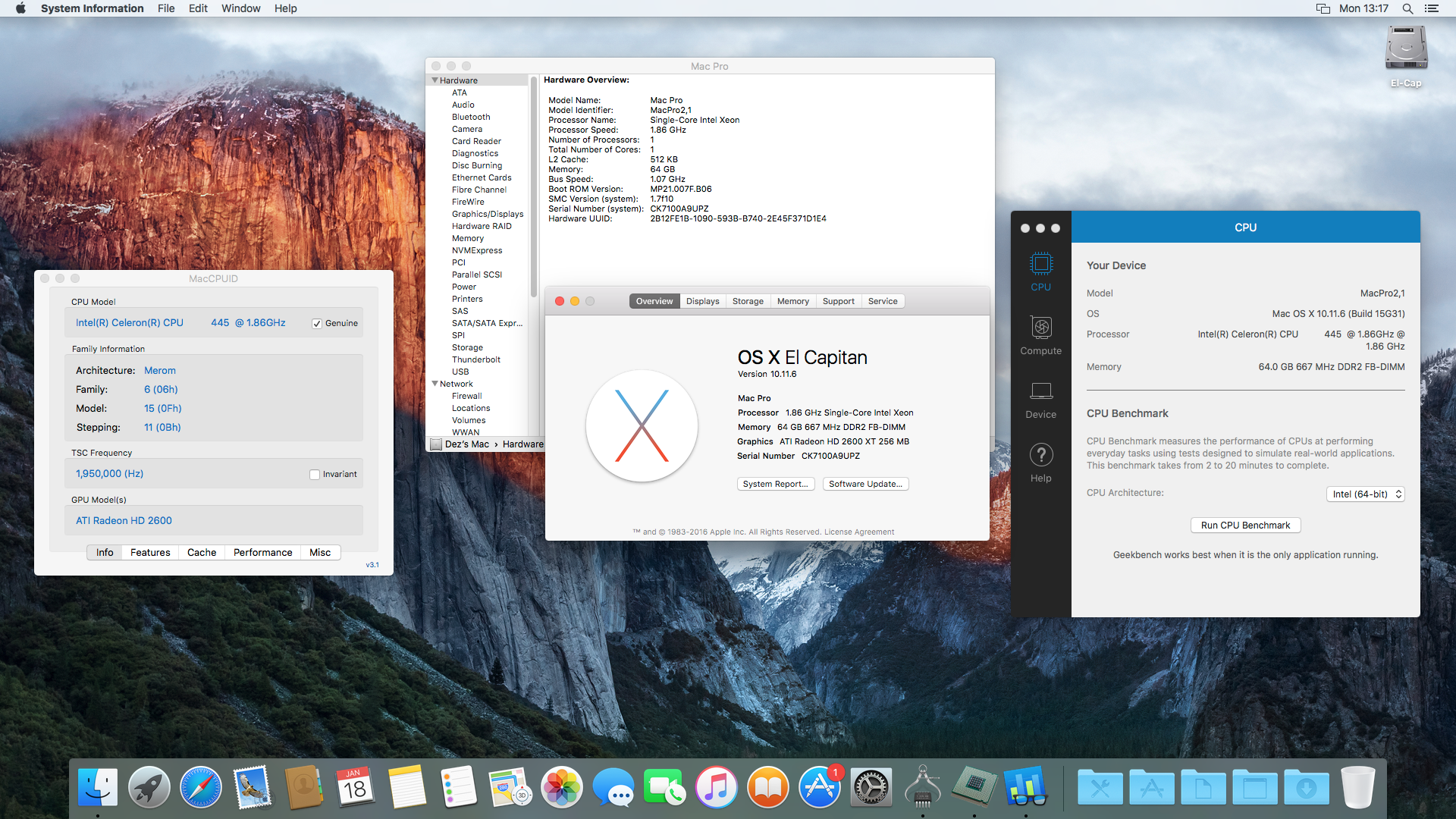

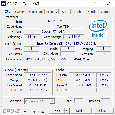

im pleased to report the Intel Celeron 445 CPU works in a MacPro1,1, LOL, I had known about this CPU for many years now, and had always been curious if it would work in a Mac Pro, its a weird single Core Socket 771 Celeron, but is based on the same Arch as the Xeons used in the MP1,1/2,1 so I wondered if it would work, well recently I finally got my mits on one and can confirm and indeed it does indeed work, with all 64GB of RAM too, hows that for unbalanced LOL
it shows up as a Core 2 Solo in about this mac, because the MacPro1,1 Firmware does not know what this CPU is, so does not set an appropriate cpu-type number in firmware on boot (which is how OS X's about this mac figures out what CPU name to display)
now normally this would result in an an "Unknown" in about this Mac, exactly like Quad Core CPUs in a MP1,1 on stock firmware, but for the earliest of Core 2 based CPUs about this mac will actually try and guess what the CPU is even without the cpu-type value from the firmware
it is curious that Core 2 Solo is string about this Mac has since no Mac shipped with a Core 2 Solo, as a side note there is also a "Single-Core Intel Xeon" string in about this mac again curious that it is there since no mac shipped with a single core intel Xeon, I wonder if I flash this MacPro1,1 with MacPro2,1 firmware if it will report a Single Core Xeon cpu-type value instead (which I will try at some point) the Core 2 Solo/Single-Core Intel Xeon strings might also be from back in the day when you used to use CHUD tools to disabled CPU cores, which sometimes would change what about this mac would report

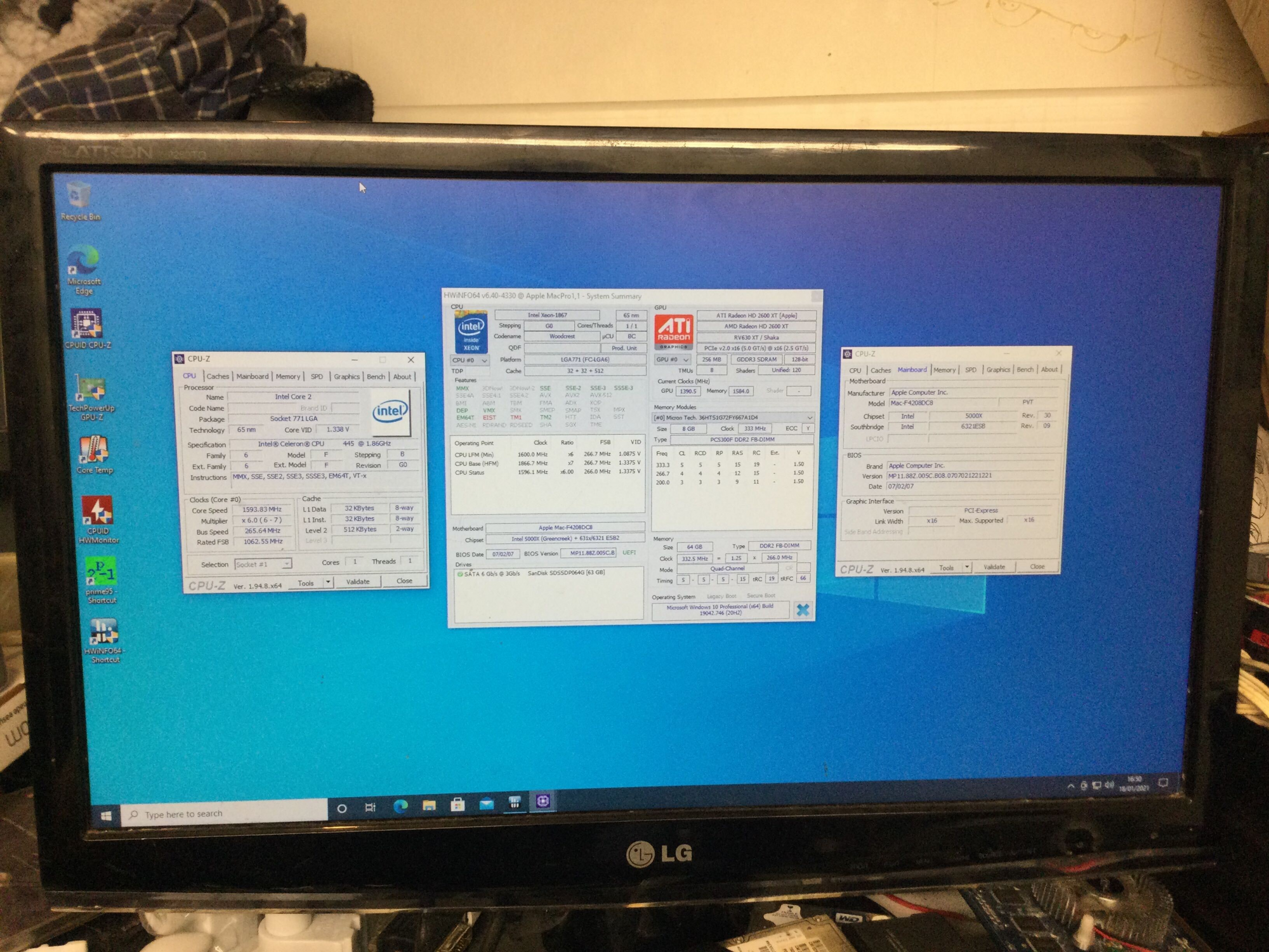

heres what windows/CPU-Z etc make of it for those curious

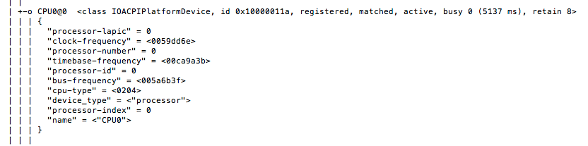

looks like I was right on the money, flashed the machine to MacPro2,1 firmware and now indeed a cpu-type is reported and it is the Single-Core Intel Xeon Value
this is on the MacPro1,1 firmware
and this is on the MacPro2,1 firmware 🙂 (note the extra cpu-type string, which as above tells About This Mac what to display)

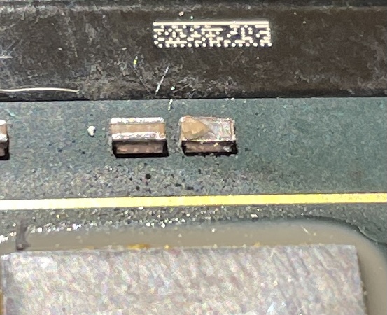

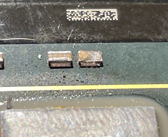

Compare the delidded xeons with the original xeons. They need to look 100% identical to be perfect. So no fiddling with torque. The spacers secure the sockets. If youre not sure measure them.
I polish the die and cut all of the black seal off and also polish the remains. And just screw the heat sink down as it was a 5.1.
dont do this if the xeon is too thick, you will bent the socket pins.
Knock on wood I got not a single build with problems. And I did quite a few...

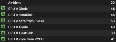

Having said that does anyone know what the the optimum temperature is for an X5680? Mine currently run in the 60-70 deg C range?
Thanks again to all the posters on this forum for the collective intelligence!

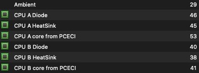

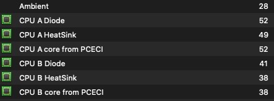

Hi, I have changed the 2 processors in my Mac Pro 5.1, from the 2 Intel Xeon x5620 at 2.4 GHz, to 2 Intel Xeon x5680 at 3.33 GHz. They work perfectly, what I noticed is that the temperature has risen about 6 ° C on average. Now they are over 50ºC and with the old processors over 40ºC. Is this normal? Is it ok that they are over 50ºC or do I have to put thermal paste on them again? Thank you very much and greetings!
View attachment 1880449View attachment 1880451
you have chosen the processors with the highest current consumption (tdp 130w), therefore they will get warmer than the old ones (tdp 80w). your temperature is however not critical.
