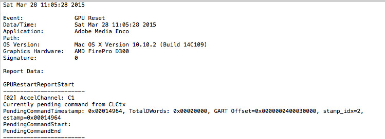

Here is one while converting video in Adobe Media Encoder....somehow there are missing letters in Application name in this LOG....
