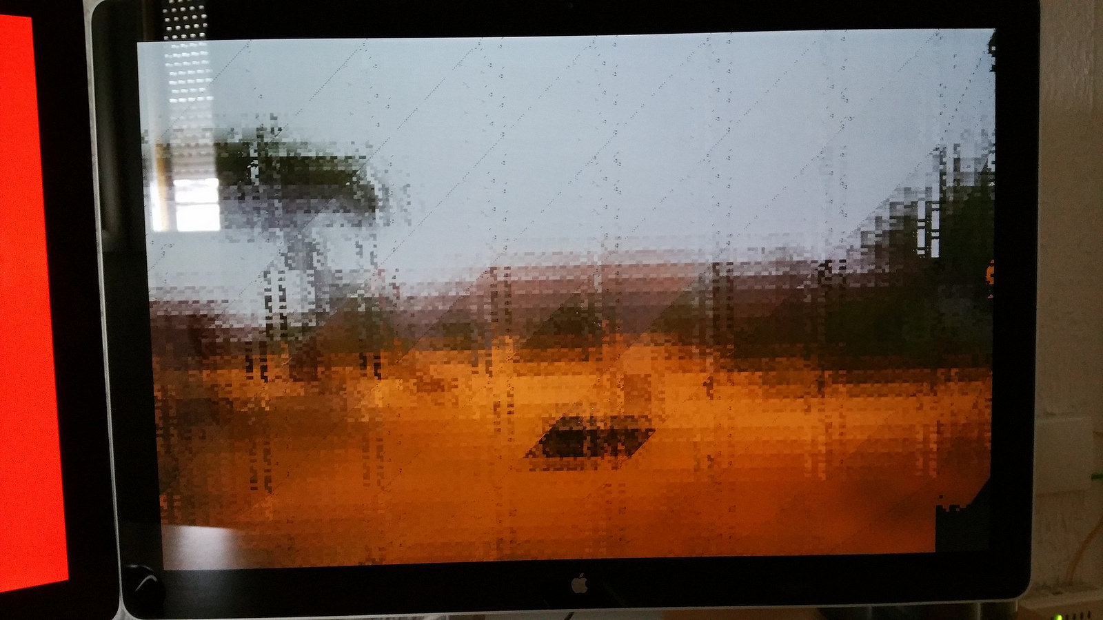

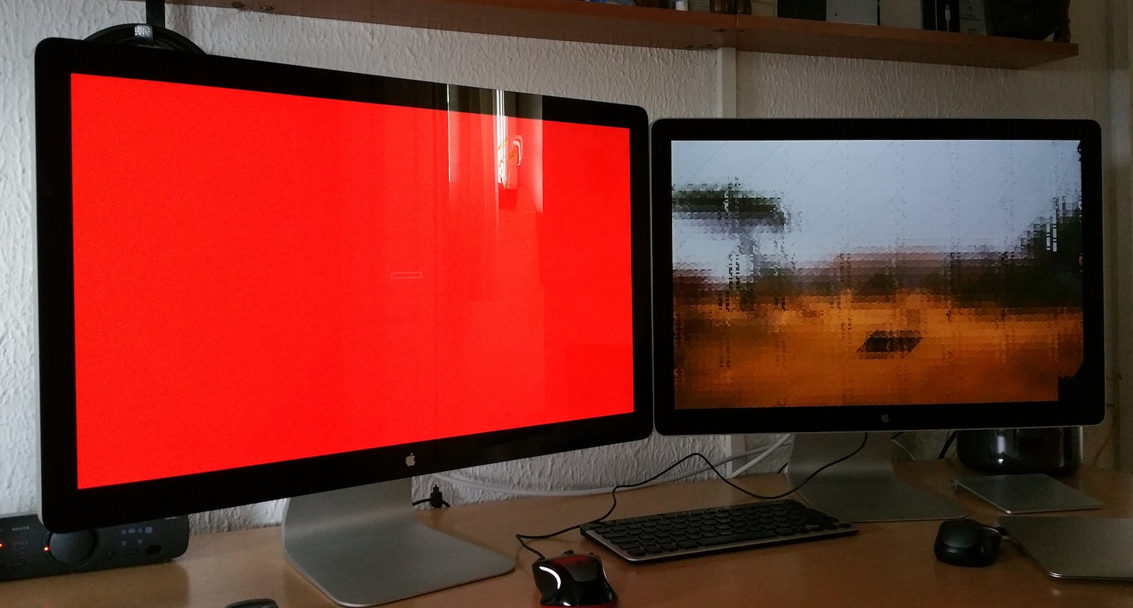

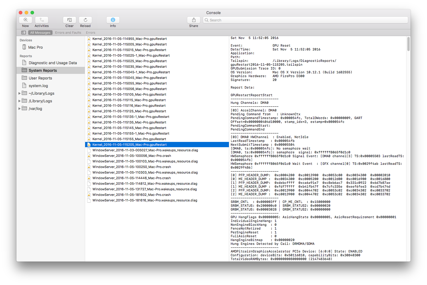

My new trashcan (macOS 10.12.1) just killed my day. Machine never had any problems for 10 months at previous owner (a friend). Only difference is that there are two Cinema Displays connected to it (27 + 24 inch, because I am multitasking freak) instead one MiniDP BenQ monitor.
Pictures speak for themselves:
Those gpuRestart logs were written in background when this below happened on my monitors....red, then white with artifacts, and the right one became pixelated and distorted....
WindowsServer wakeups happened later and were handled with forced log off.
This is just cataclysmic.
There must be some logic why this is happening.
Software, my friend. Something is rubbish about how the trash can handles the signals from the GPUs to displays which causes the tragedy. Also you have to bare in mind that Microsoft Windows 10 is not supporting Thunderbolt 2 for its... problems. So I would guess, its a mixture of TB2+Software problems.
Edit. Nope, after thinking about it, I think it is more to do with Thunderbolt 2 controller, rather than anything else.
Yes - there is some logic, Bax - Screenshot number two (the right one). Exactly one of my crashes. Missed the left one, because I only have one monitor. (Dell P2415q, running at native resolution). Do send these screens to Apple...

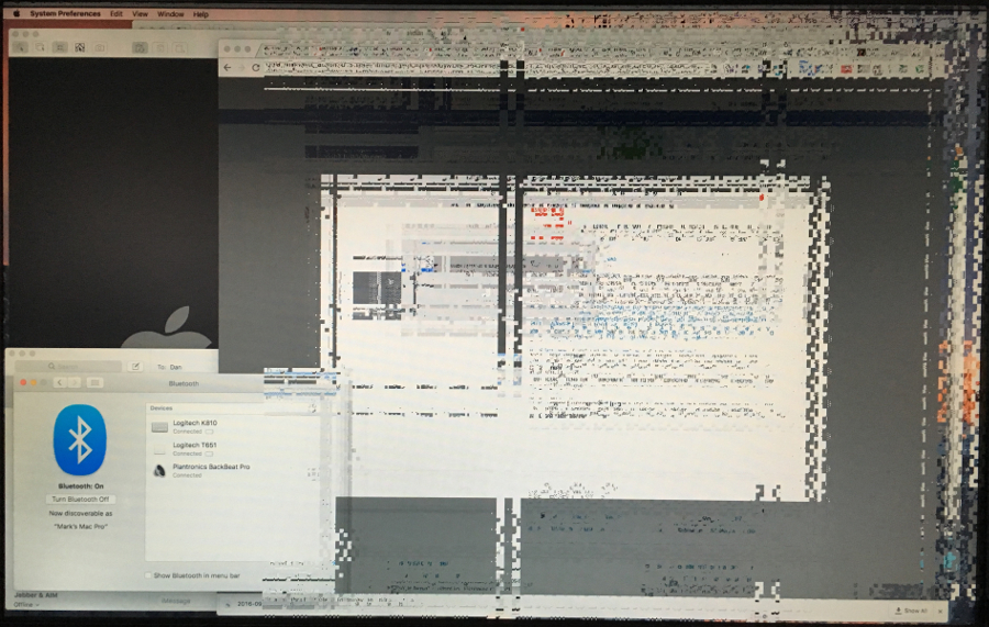

My original Mac Pro had it's D300 cards replaced and was in for Genius Bar analysis several times since December 2015. They ultimately replaced it a few months ago.
Recently, the replacement had a GPU restart loop for several hours. I was SSH'ed into it and saw .gpuRestart files repeatedly generated.
So, I followed up with Apple Support but they didn't respond for 2+ weeks. After calling them back, they insisted I get it checked out at the Genius Bar since it was a different machine. To no surprise, it passed all their tests but they wanted to take it and run extended tests. I refused since they had the other machine for 2 weeks and didn't find anything.
Apple uses the same rigid support playbook. Showing them documented threads & articles doesn't seem to matter. The 'sysdiagnose' output I send is never addressed. They just say they want to get it working for me.

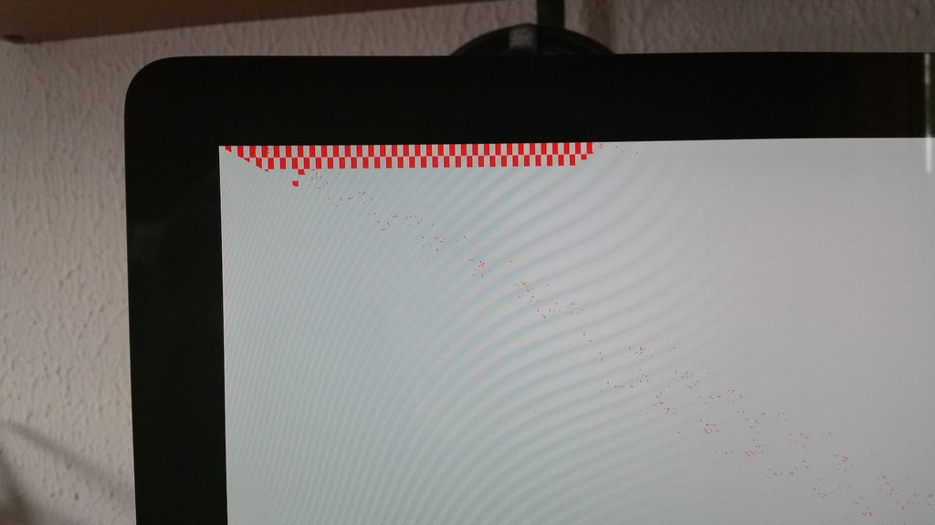

Adapter Type: Apple Mini DisplayPort To Dual-Link DVI Adapter
Adapter Firmware Version: 1.02
I just confirmed that a Dual-link DVI adapter below firmware 1.03 can cause flickering and wake from sleep issues (https://support.apple.com/en-us/HT203352).
My firmware issue will probably not apply to most of the users on this thread but it raised my suspicion that the freeze issues experienced in OS X 10.10 or later are related to the software implementation of Thunderbolt 3 and USB 3.1.
