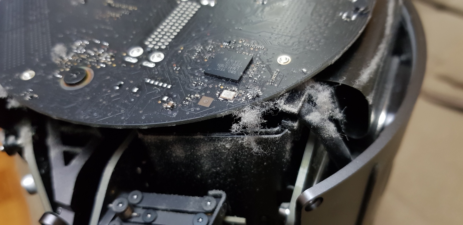

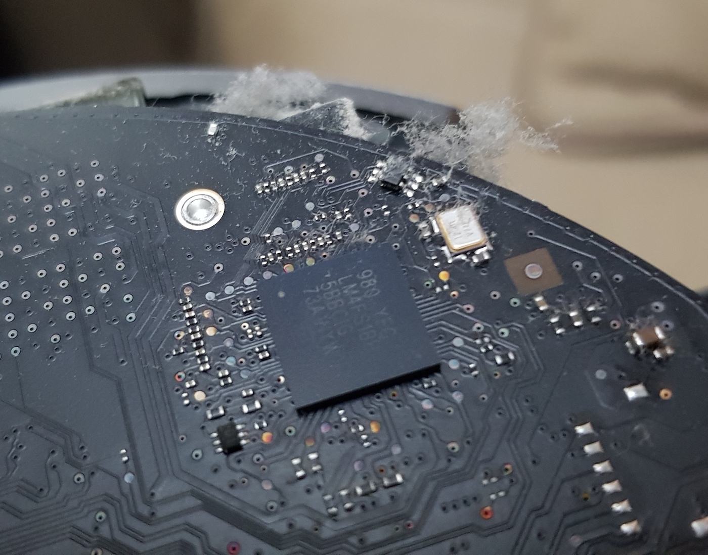

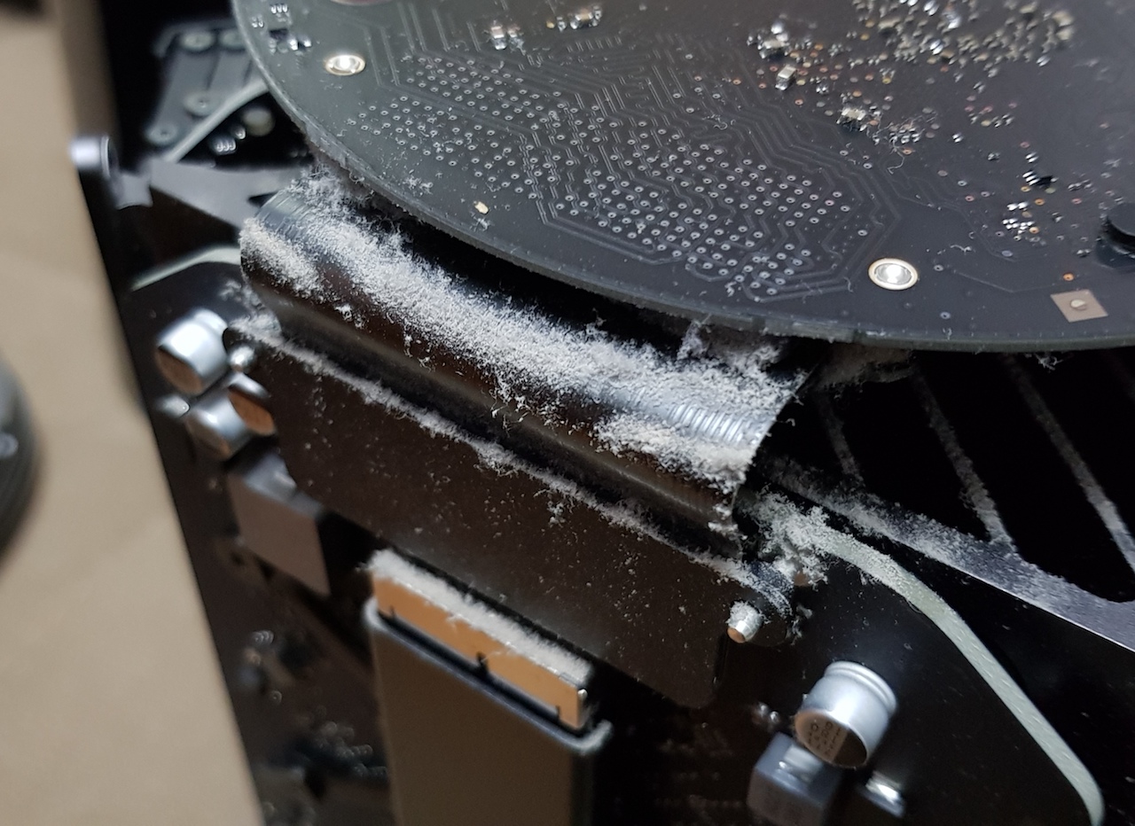

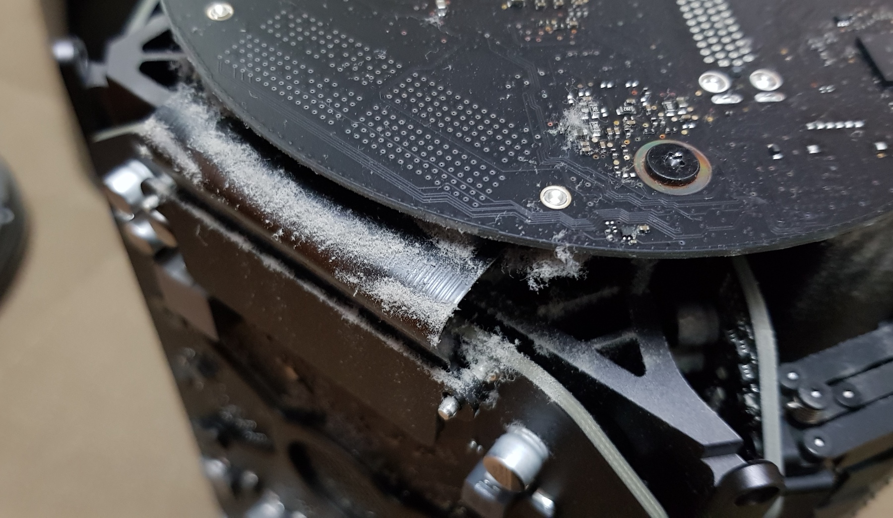

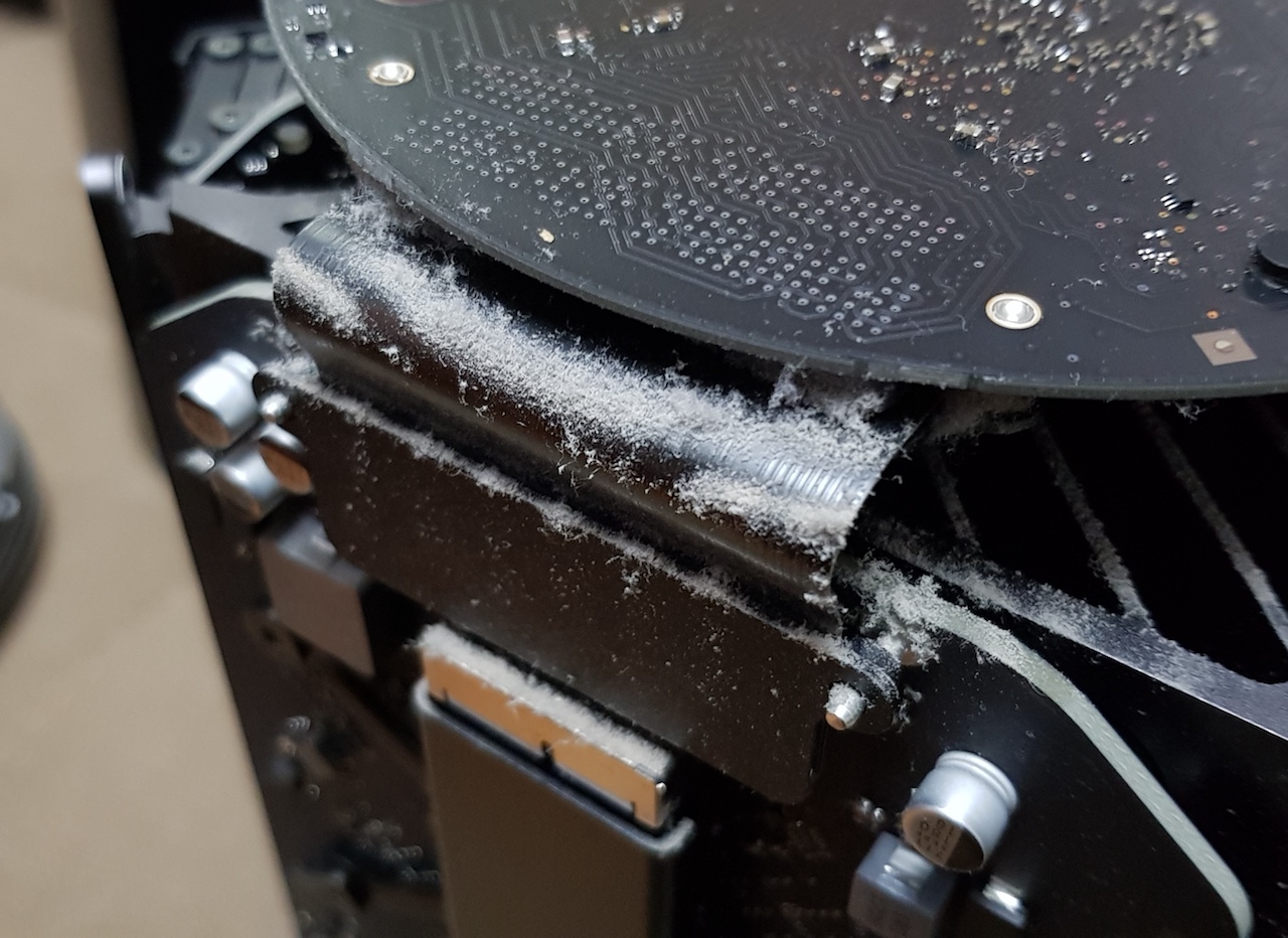

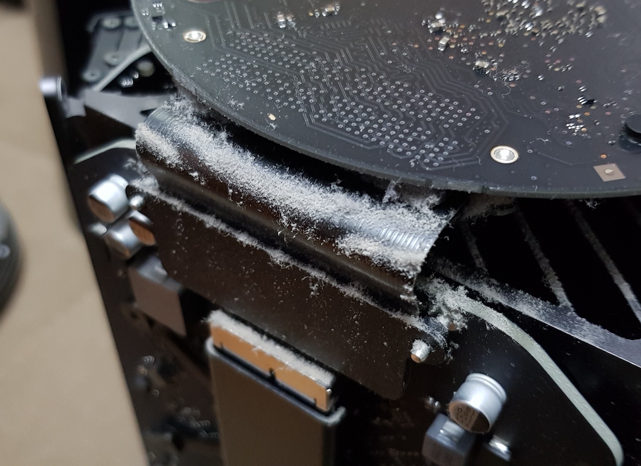

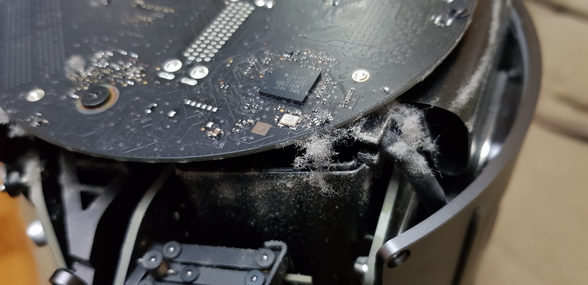

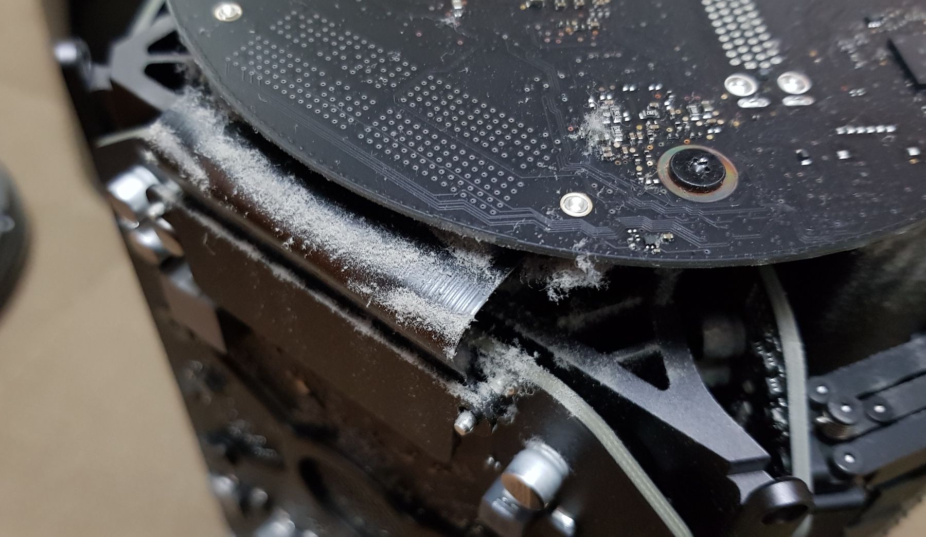

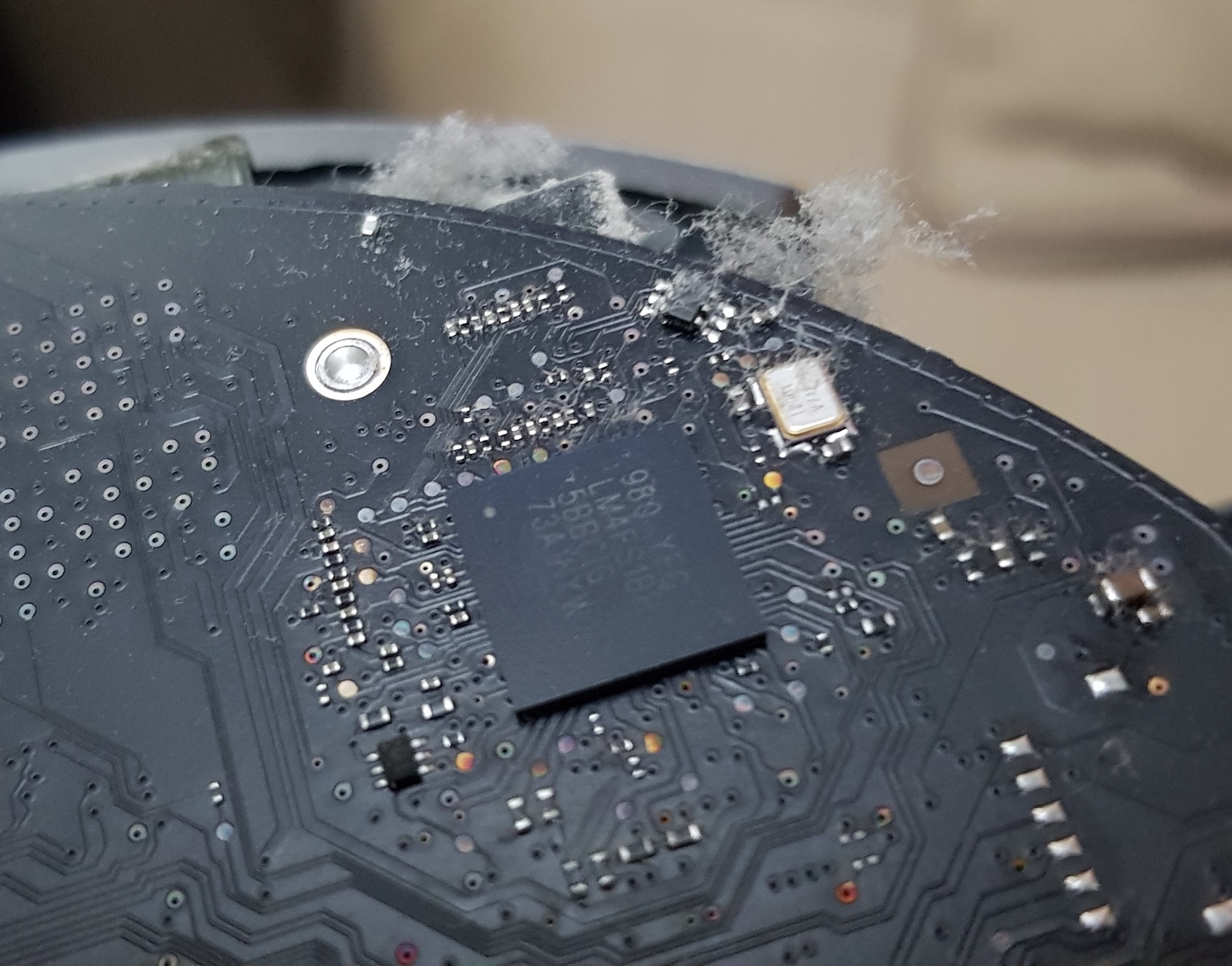

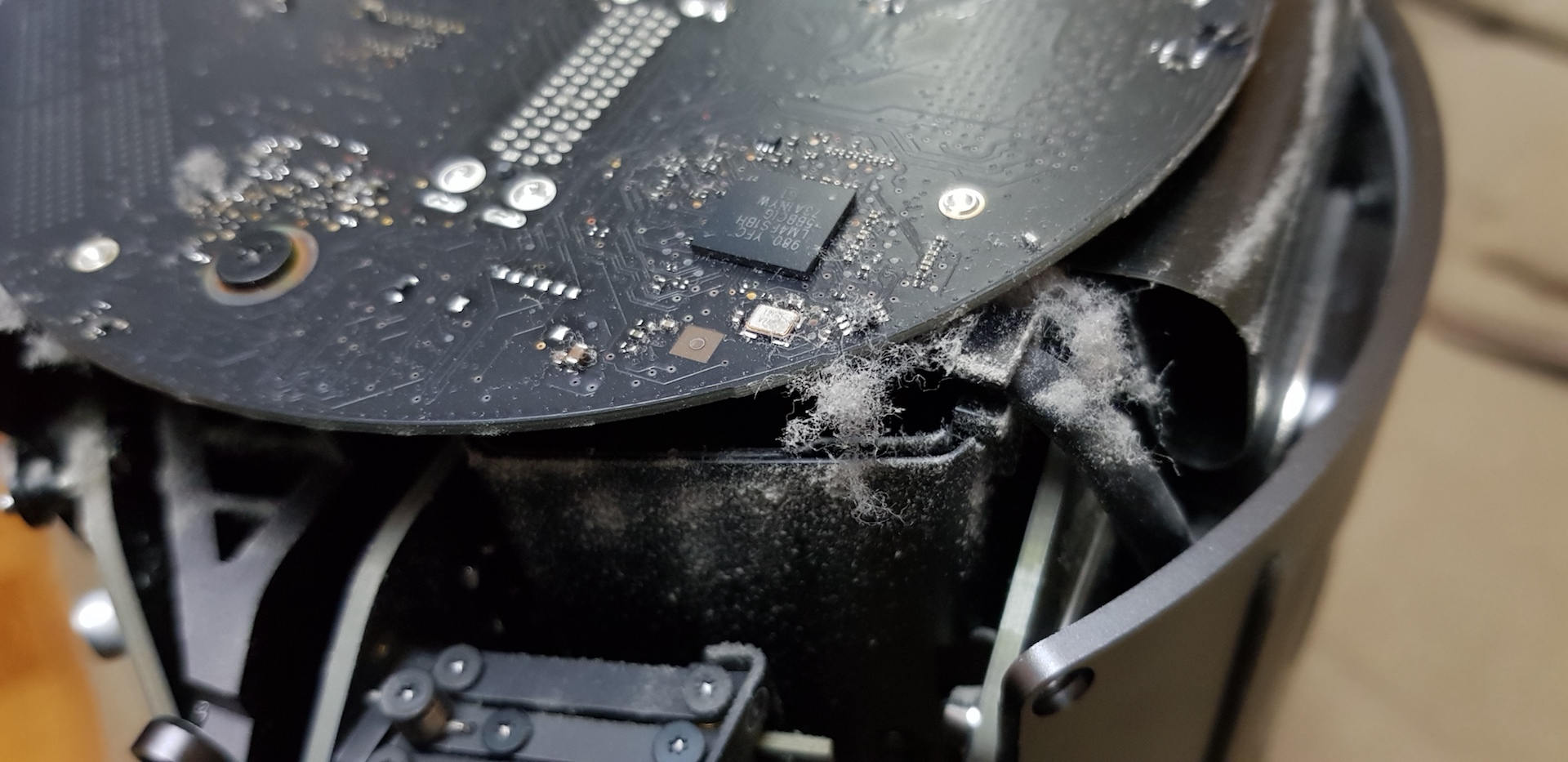

There is also a interesting point regarding Mac Pro usage. If its not in some clean machine room, it can very easily fill with dust. You can see dust piling up on the bottom openings, because of the airflow. I don´think that it can be problem for the flat interconnections but it can be for the rest of the electronics.
Really? Damn.. I still haven't taken the top of my 6,1 since I got it a couple of months ago. I'll take a look. Dust or heat can't be a cause of the issue though IMO since I had lockups from day 1 - midway through the first install infact!
So yeah.. machine is on 24/7... inbetween serious use it spends most of the time idling and playing music with VLC. In the past month, I've had to reboot once or twice. Infrequent enough that I'm not acting on it at the moment. I did lose some work in Studio One that could not be recovered or reproduced. That doesn't want to be happening again.
