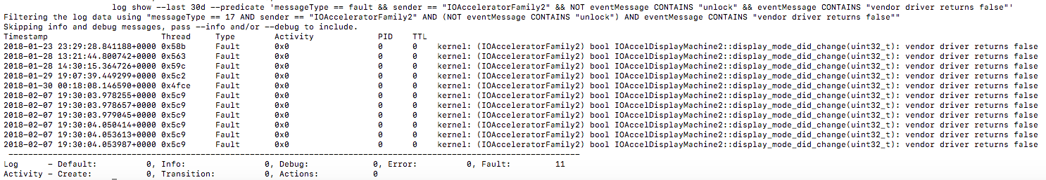

I modified Kris' terminal code to just show 'vendor driver returns false' logs, as these occur every time I have the lockup.. YMMV
CODE said:
log show --last 30d --predicate 'messageType == fault && sender == "IOAcceleratorFamily2" && NOT eventMessage CONTAINS "unlock" && eventMessage CONTAINS "vendor driver returns false"'
This gives me a clean list of basically the timings when the machine goes down.. this is from yesterday. Curiously, it produced several instances in one go.. reattempts? Machine chimed twice when rebooting..
Seems like I will have to escalate this with Apple can't have this machine crashing whilst working, it's discouraged me from installing my DAW and associated plugins. Does one need to setup a genius appointment via online chat? Never used Apple support before.

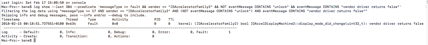

Damn. I was on a roll. Two weeks with no crashes since the cards were replaced and just now I got the same error as @FilthyMcNasty:
Code:
panic(cpu 4 caller 0xffffff7f8b7666a0): "bool IOAccelDisplayMachine2::display_mode_did_change(uint32_t): vendor driver returns false"@/BuildRoot/Library/Caches/com.apple.xbs/Sources/IOAcceleratorFamily_kexts/IOAcceleratorFamily-378.14/Kext2/IOAccelDisplayMachine.cpp:478
