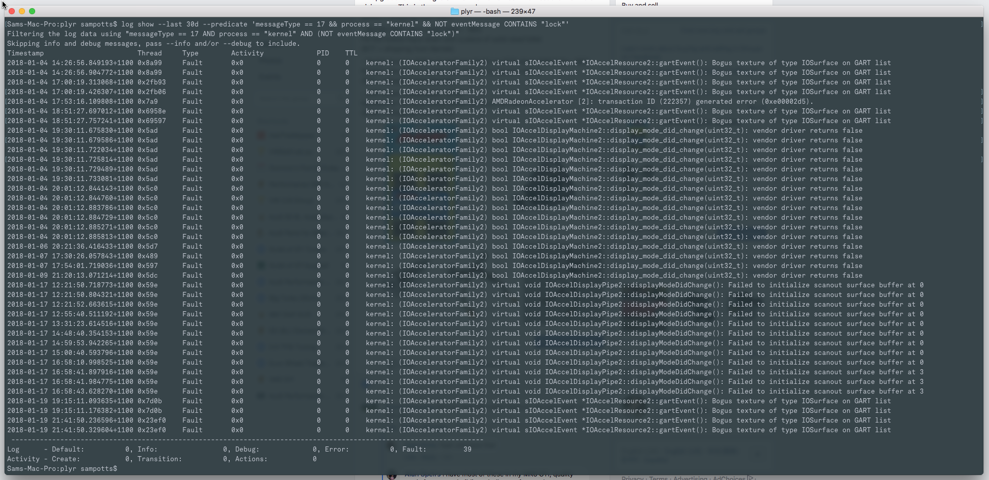

Turns out there ARE log messages when the D300 crashes. They are just very well hidden.
In my case, the following three error messages ALWAYS coincide with a freeze:
kernel: (IOAcceleratorFamily2) bool IOAccelDisplayMachine2::display_mode_did_change(uint32_t): vendor driver returns false
kernel: (IOAcceleratorFamily2) AMDRadeonAccelerator [2]: transaction ID (28871) generated error (0xe00002d7).
kernel: (IOAcceleratorFamily2) mach_vm_address_t IOAccelResource2::lockForCPUAccess(task_t, enum eLockType, IOOptionBits, bool, uint8_t, uint8_t, int32_t *): after pageoff, sys memory data still invalid or non-linear
kernel: (AMDSupport) --> GPU register 7598 read failed. Returning cached or generated value 4000311 instead!
To list such errors from the last 30 days, execute the following command in the Terminal (and have some patience):
Code:
log show --last 30d --predicate 'messageType == fault && sender == "IOAcceleratorFamily2" && NOT eventMessage CONTAINS "unlock"'
This doesn't explain why the freezes are happening, but it might be helpful in proving to Apple that there's something wrong.
Edit: Optimized log query and added additional error
In my case, the following two error messages ALWAYS coincide with a freeze:
To list all such errors from the last 30 days, execute the following command in the Terminal (and have some patience):
Code:
log show --last 30d --predicate 'messageType == 17 && process == "kernel" && NOT eventMessage CONTAINS "lock"'
I believe the time I see on these logs is associated with when I return to the computer, not when the freeze occurs. Eg computer froze 19:02 (as shown by screensaver).. I return to computer at 19:07.. log shows latter time.

My Mac Pro does not freeze (it's only about three months old). However I did check the logs for the message:
I did not see this message but instead I see
kernel: (IOAcceleratorFamily2) AMDRadeonAccelerator [4]: transaction ID (789802) generated error (0xe00002d5).
While trying to find out what the meaning of the error codes is I found this website. According to this site the meaning of the error codes is:
0xe00002d5 -> kIOReturnBusy / Device Busy
0xe00002d7 -> kIOReturnOffline / Device Offline
So it seems like the GPU or some subsystem of the GPU which should handle the display did not wake up.
Reactions: Kris Kelvin
@tomvos Nice work. What GPU do you have? I didn't find a single kIOReturnBusy in the log of the last 30 days.
Based on the error code kIOReturnOffline, it looks like my Mac Pro simply lost the connection to the GPU. As @FilthyMcNasty said, the errors might just be a symptom of a crashed GPU and not an indication as to why it crashed.
Reactions: tomvos
