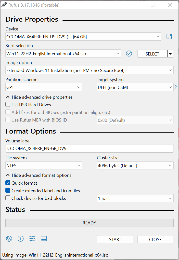

You don't do it explicitly.
Make sure you download Rufus 3.17 from here (AFAIK the later versions have the patching ability removed by the request of Microsoft).
Set it like this:
Reactions: Amethyst1
Hello,
Thanks for this I have used Rufus to finally create a bootable Windows 10 USB drive that is recognised by holding the Alt key on power up, so this is progress.
