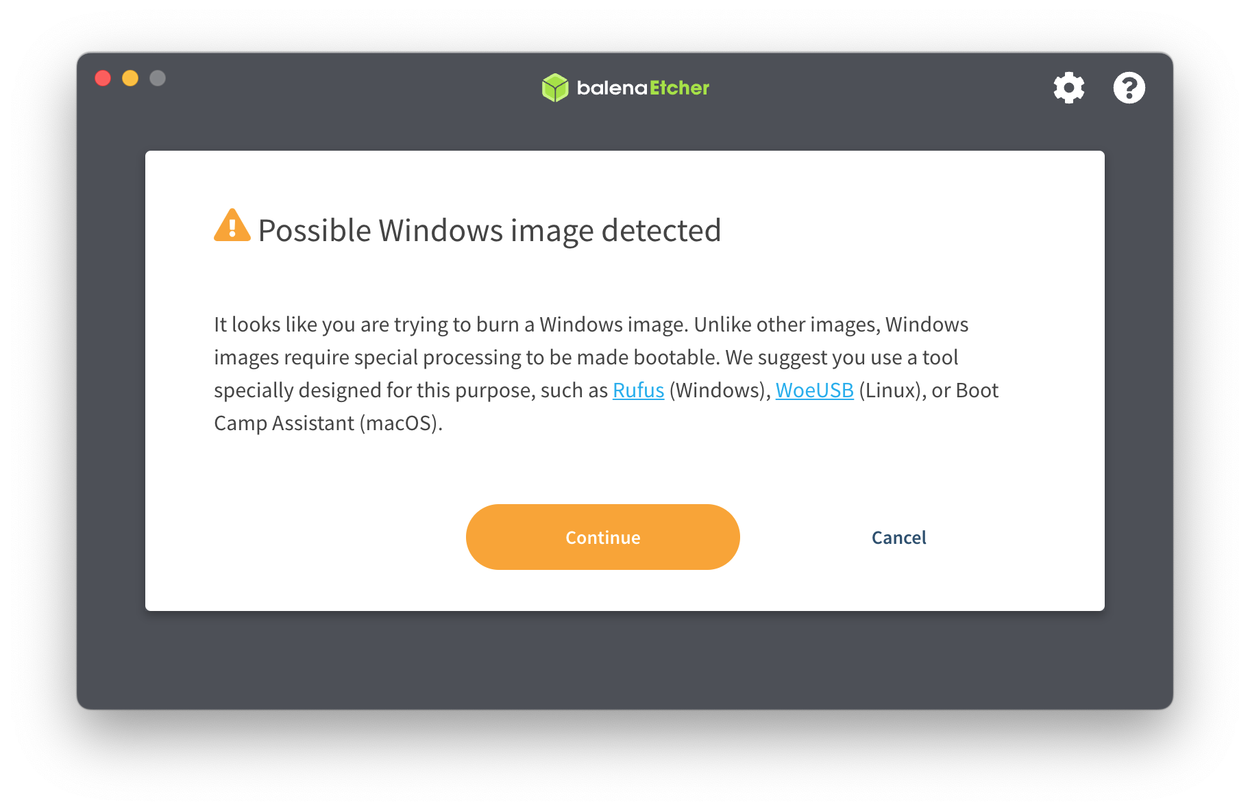

as when I try to use Etcher to create a USB with the image, Etcher comes up with an error indicating that the Partition table is missing from the ISO??
You have been told to use Rufus. Why are you using a tool that clearly states it is unable to properly create a Windows USB installer when already told what to use?
Initially, the only way I could get a bootable USB was by using Etcher....... so I am now going back to recreating what i had initially that worked.
