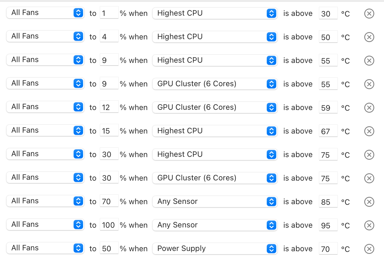

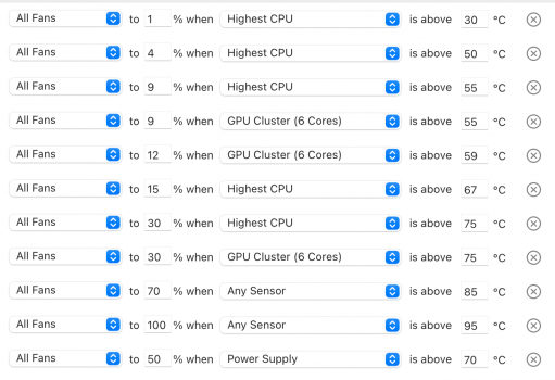

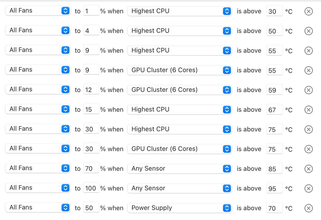

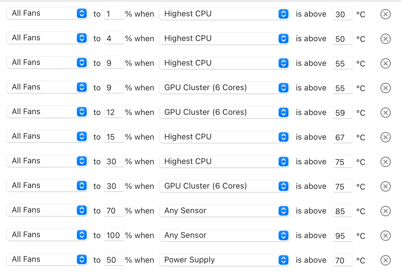

In TG Pro, you have to go into preferences and then to the Fan option. There, you have the tick the box to "Use Auto Boost instead of Auto Max". You may also need to install the fan helper if you haven't already. The you need to set some Auto Boost rules in the section above. You can delete what is already there and start again.
Add a rule and select 'All Fans' from he first column, then change the percentage, then elect 'Highest CPU' from the next drop down, and finally add a temperature. Then add another rule etc.
I am still experimenting, but based on the temps when running some high CPU and GPU tests, I currently have the CPU set to 1% when above 30C (this sets it to around 1130 RPM for most of the time during general use). Then I have 4% for over 50C which ramps up the speed ever so slightly if things get a bit warmer with the CPU - but to be honest I may get rid of this one! Then, the important one is 9% when over 55 - this one kicks it up to Apples 1320 (ish) when everything is under load. I actually also then have more set above that just in case e.g. 15% above 67C - but, it has never reached that even under load for 30 minutes!
I then also have a couple set for the GPU - so in the instructions above, instead of selecting 'Highest CPU' select one of the GPU clusters - I deleted the first on the list as that is the one that seemed to get a bit hotter for me. I have 2 main rules set - 9% for over 55C and 12% for over 59C. Again, with apples speed I never went above 58, so the 12% is just incase. There is no need to set any lower speed.
I also have a couple of safety nets just in case - I have one set to 70% for Any sensor over 85C and one to 100% for any sensor over 95C. Oh, and a Power supply one set to 50% over 70C - again just incase!
The one thing to say here, is that I am in the UK and it is spring, so temps are still not that warm - I may have to revisit things when things start getting warmer. But basically, just run the fans at Auto and see where the temps stand at idle and then under load and adjust the 'above' temp as needed.
So currently, unless I use my one app that uses 100% CPU for about 5 minutes when exporting, the fan runs at around 1100 and then pops up to 1300 for that. Seems to work very well. Currently, typing this with the fan at 1100, max CPU at 37C and Power supply at 32C. So, I really do wonder why on earth Apple feel the need to set their minimum to 1300!
EDIT: I realised a screenshot of my setting would probably have been easier! 🙂
In about a week of using the machine under normal circumstances, where I'm on calls, there's stuff going on in the background, I have music on etc, I never hear the fans. Occasionally, when things go quiet, I'll hear a noise and realise its the fans from the Studio, but I can live with that.
