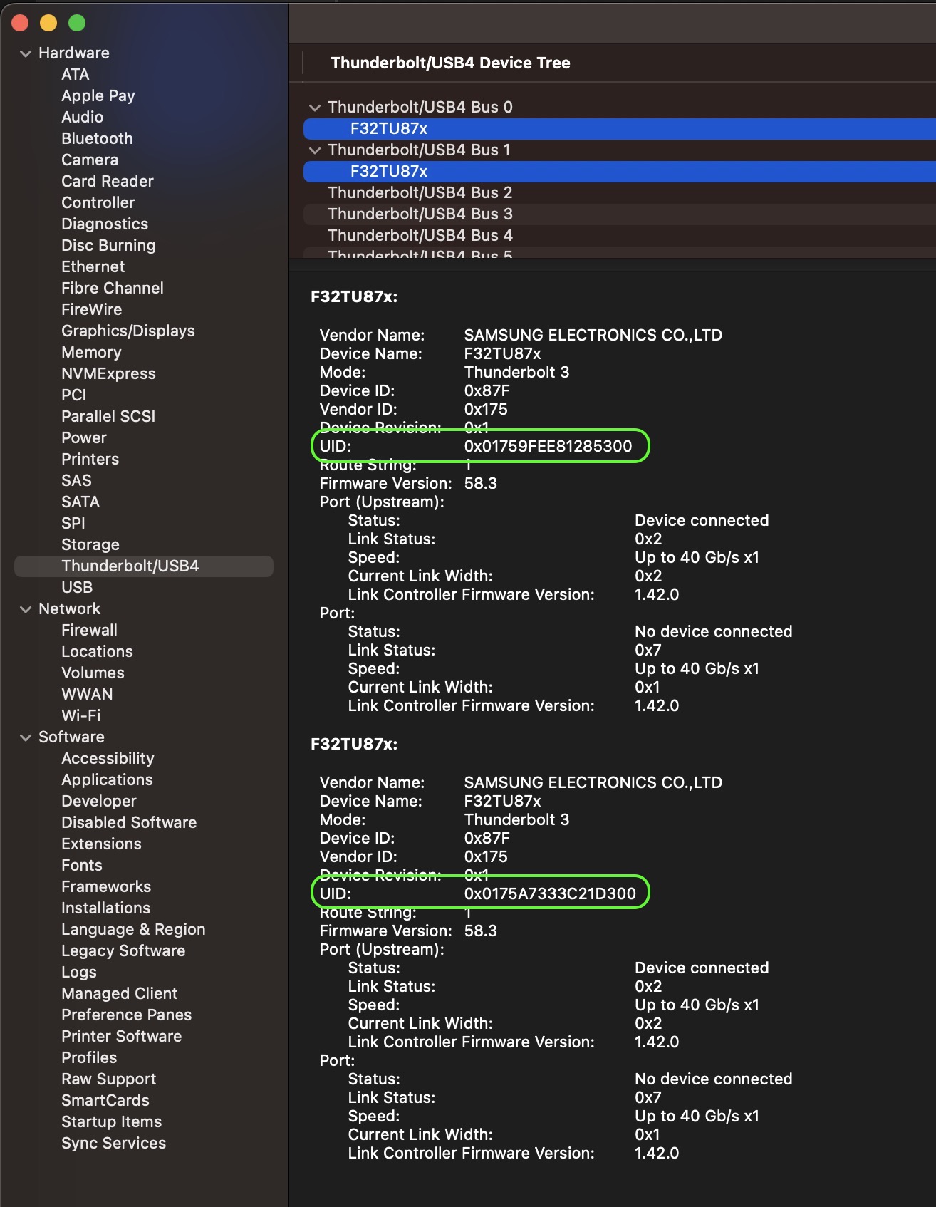

Each monitor, in the System Information app, under the tab called "Thunderbolt/USB4" shows the 6 buses, and the two monitors connected to the first two, as you can see in the screenshot:
As you can see, almost everything here looks the same, even the UIDs look very similar. They both end in 300. But they are still unique. And that's what the system uses to tell them apart. So it's definitely possible for macOS to keep one of them always as main and the other as extended.
