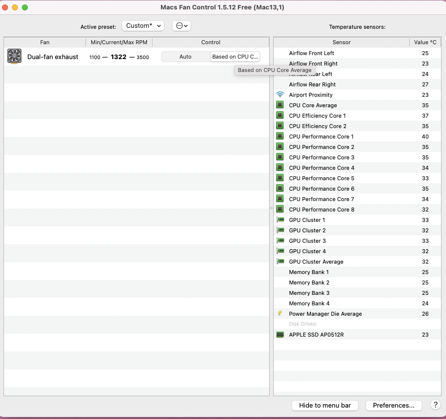

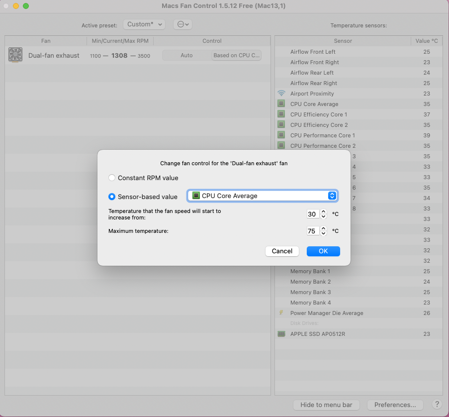

Using Macs Fan control we can make fan speed dependent of component temperature, for example I made it based on CPU Core average temp, it works but it is not instantaneous it's smooth

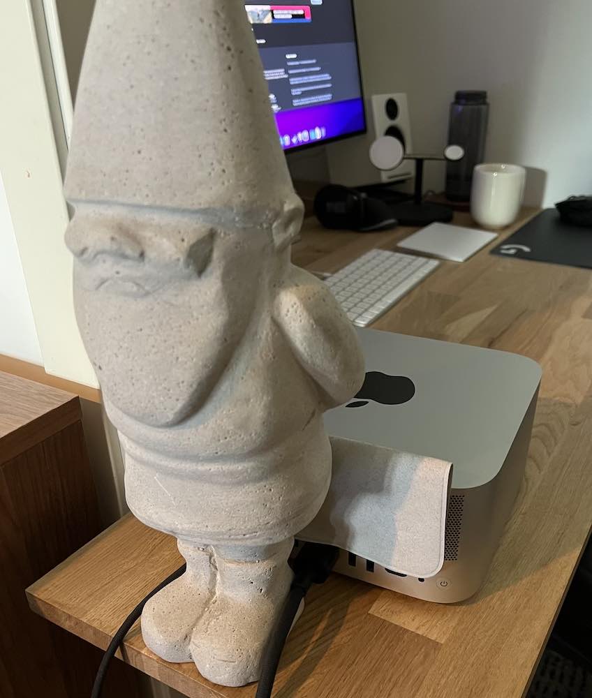

I've discovered the perfect solution to when I want to just browse the internet in silence! :D Obviously this is what the Apple Polishing Cloth was designed for /s :p
Weirdly, I've been watching the temps and fan speed in Macs Fan Control after having the cloth there for 15 minutes and they haven't really changed at all. I wouldn't try this under load though - and no, I'm not actually going to do this long term.
The fact that the cloth silences it is strange because I think it's not the fans that are loud (or at least that's not what's annoying me), it's so much air being pushed through the tiny case holes. I wonder if it would be possible to add a grill or something to break the air up while still allowing it out.
I do wonder if it's just the airflow through those holes too, they're kind of small in comparison to most PC's, even if there are a lot of them. But that doesn't really explain how so many can't hear it.

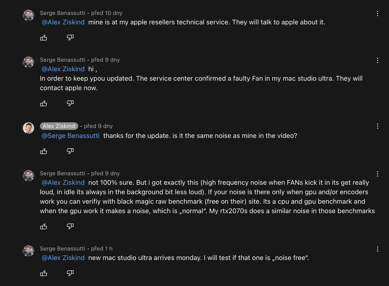

I was chatting with a user who has a noisy Mac Studio. He tried covering up half the ventilation holes and the noise was the same. Mine is noisy is on one fan. What if some units have both fans broken? Then they would be really noisy. 🤔
Since there is also a coil in the electric motor, this problem could be all coil whine and whistling when changing RPM.

I'm here because I want a solution to my issue. There are two possibilities here: a) I have a defective machine and therefore should return it, or b) This is normal for the Mac Studio and I need to work out if the extra performance is worth the extra noise compared to the M1 Max MBP which is literally dead silent at idle. Hearing from other people who have this issue is incredibly valuable to me.
I also want to know if Apple has / will acknowledge the issue and might be able to fix it with a firmware update down the line.
