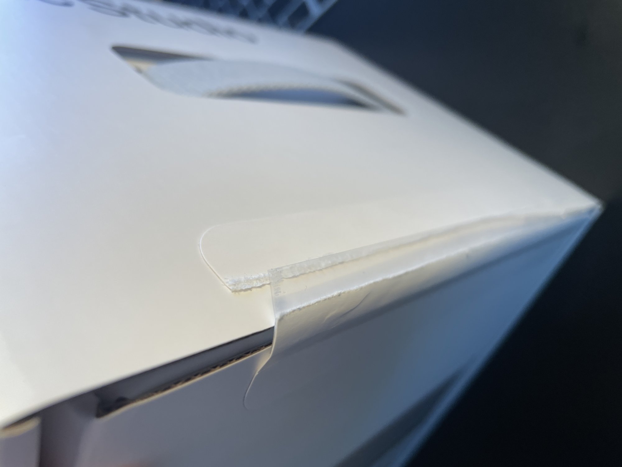

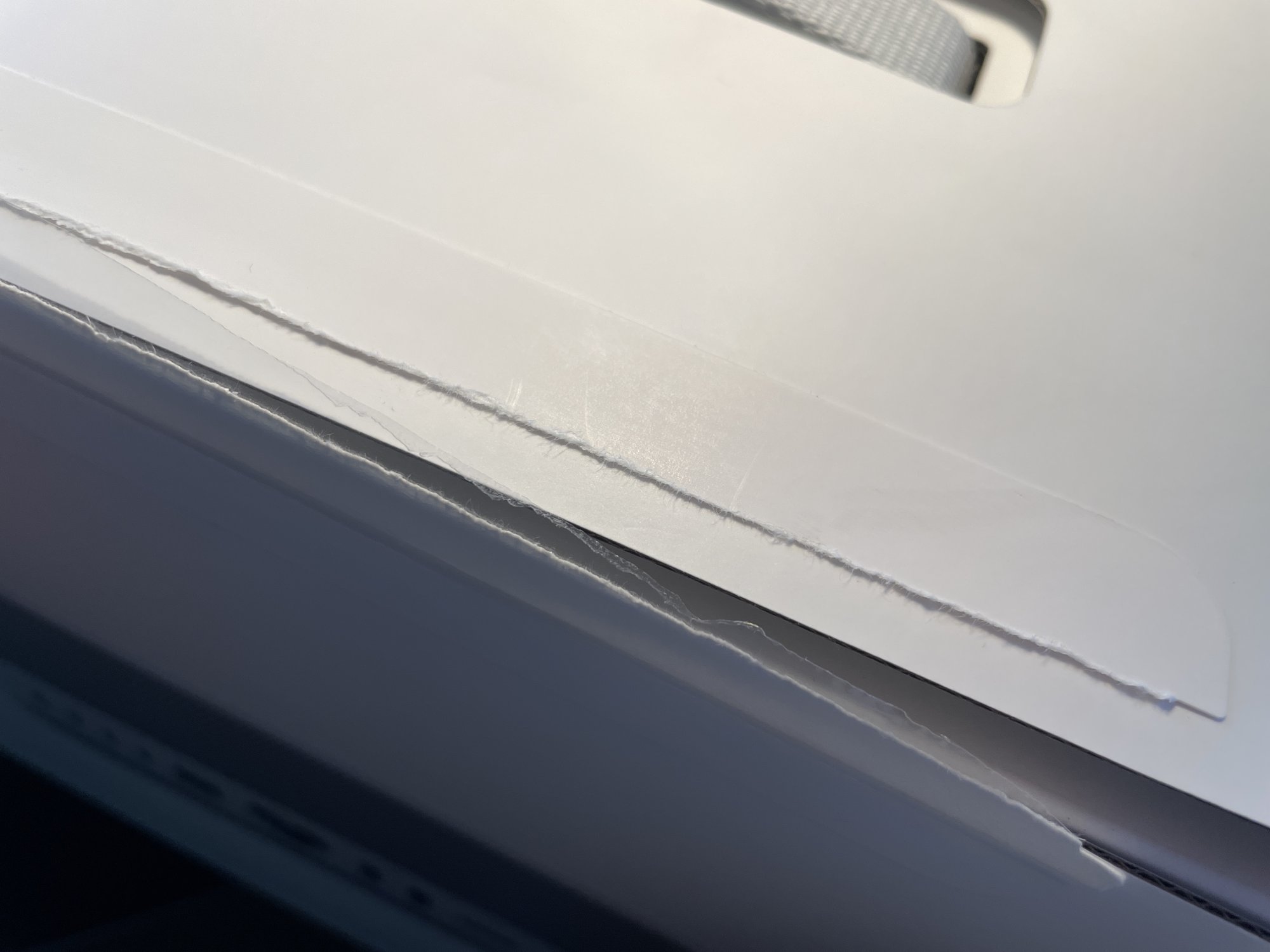

Also, I have a gut feeling that they are re-packaging some returned units and sell them again as brand new.
My second one came with an additional hard transparent tape underneath the usual paper "pull" tab, I noticed the difference right away when unboxing (the first one didn't have it, if I'm not mistaken).
That , together with the odd suddenly change in delivery date (my second one jumped suddenly in delivery date and came 2 months earlier than quoted) ... makes me a little paranoid.

After all my experience (just my personal one, it might not be the overall "rule") it feels like the quiet units are really ... a jackpot :confused: (just my 2 cents)
That is how Apple stocks their refurbished items. If you buy refurbished, you're likely getting something that someone bought and then returned.
I still think this is related to the different PSUs in the Mac Studios. We know there are at least two different PSUs, and I just wish we could pinpoint which one a particular unit has.
Not the refurbished ones (that's obvious) but the brand new ones.
I have a feeling that they are re-packaging the returns and sell them again as brand new. They are sending them to the factory, few tests, re-package them and just sell them again.
So basically, those "whinny" units returned and then bought again "brand new", will still have the same components inside.
That's why I said I don't think apple will silently fix things ...
Reasons for my thinking:
- I got my second unit in a different "seal" compared to the first one (the second one had a hard transparent tape underneath the usual paper "pull" tape, like it was double sealed). Maybe I forgot how the first one was sealed ...
- Out of the blue, the delivery timed jumped by 2 months early, a week or so after I received my original delivery "quote" (that's not something that happens "unpredictable", it's obvious that they made some decisions to cause that)
- As of now, there are zero Mac Studio's in their refurbished store ... and we know that they have a lot of returns (I am on my second unit, there are users on their third)
Anyway, it's just speculation and I might be paranoid :)
