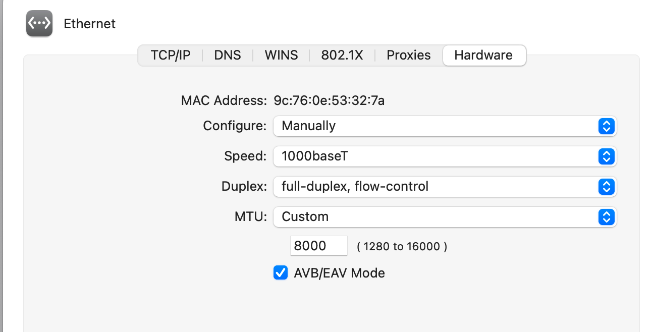

This appears to be a driver issue from Apple's side and can be corrected unis the settings below that were reported by a user on Apple's forums and verified to correct the issue for me:
I'd like to point out that I had this same issue and used this fix but didn't change the MTU from the default and it works fine. If I had to guess, it seems to be disabling the energy efficient ethernet setting that's key. It's the only setting I have different from what the auto mode was choosing.
Also I didn't have this problem with a wire directly to my router, it only started happening when I put a small D-Link switch in the mix that I use at my desk to connect several devices. So I suspect this is more than *just* a driver issue, could be a compatibility issue at the driver or hardware level, and it could be the mac or the other device it's connected to. I don't care enough about this energy efficiency feature to try to figure it out, good luck to anyone who tries.
Same here, well nearly - I also switched to 1GB while I was at it, since that's my network speed anyway. I didn't want to mess around with the other stuff unless it was essential, and so far it doesn't seem to be.

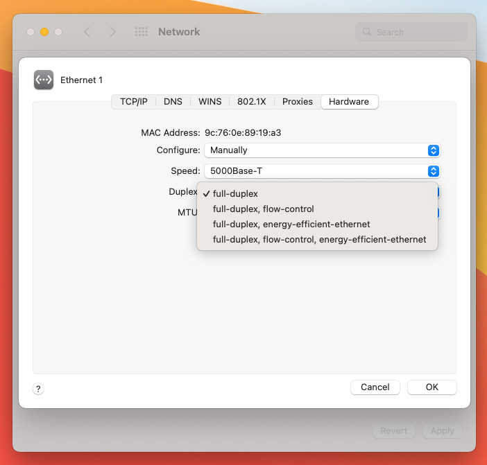

I connected my Mac Studio to a QNAP 10G switch and the computer started dropping its network connection almost immediately. Disabling “energy efficient” fixed the drops for me.
kfscoll
macrumors 65816
Nov 3, 2009
1,147
139
How do you change that?
Pick one of the drop-downs here that doesn't say "energy-efficient-ethernet."
Also, the only two multi-gig devices I have are my Mac Studio and my QNAP NAS. The Mac Studio has the 10G ethernet port of course and my NAS has a 5Gbps port. When I connect both devices to the two 10G ports on my switch (the other four ports are 2.5G), I can saturate the 5G port when copying files from my Mac to my NAS, if I manually set the Mac's network speed to 5000Base-T as shown above. If I manually select 10GBase-T instead, the transfer speeds to my NAS drop to sub-1Gbps. So, at least with my switch, I have to be careful to manually select the network speed on my Mac that matches the max network speed of the other device connected to the 10G port on my switch, else the two devices and/or the switch don't negotiate the speeds correctly and default to 1G.
This seems like a switch issue, but I don't have any other 10G switches (or 10G devices, for that matter) to test out. I do have a 10G network card for my NAS on order so I'll try 10G again on the Mac when the NAS is also 10G...hopefully I'll get transfer speeds greater than 5G (I doubt I'll be able to saturate the 10G link).
Enabling flow control on your switch would probably solve this.
bobcomer
macrumors 601
May 18, 2015
4,949
3,697
Thanks! Real intuitive there Apple, he he says embarrassingly. :)
I only have 1G switches that don't support energy efficiency, so I haven't seen the problem. I have seen that cause problems where I work and with Windows machines. So I always disable it now.
