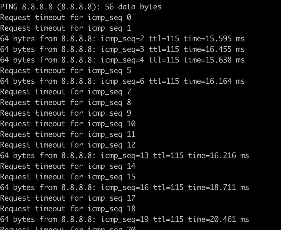

Getting intermittent pack loss on 10GbE M2 Studio ethernet port after coming out of power-saving mode. Taking out ethernet cable and plugging it back in fixes it until next time. But very annoying. Connected to Unifi 10GbE Flex XG.
Will have a look at debugging over the next week or two and let you know what fixes it, if anything.

For the sake of closing this out for me... I resolved my persistent ongoing issues after trying all sorts of things. What finally fixed the problem was dumping my NetGear CAX80 router with its flawed 2.5GBE port and replacing it with a Motorola MT8733.. There are loads of people on the NetGear forums having problems with the same port on this router, all of them unacknowledged by NetGear. So I am done with using their routers after perhaps 20 years.

Packet loss appears to have been fixed. To fix the packet loss I set the Studio ethernet port from auto-negotiation to manual 10GbE, and it hasn't occurred again since.
