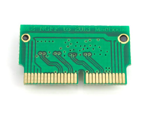

Yes, you'll need a Sintech adapter because the Air from mid 2013 to present use the same SSD.

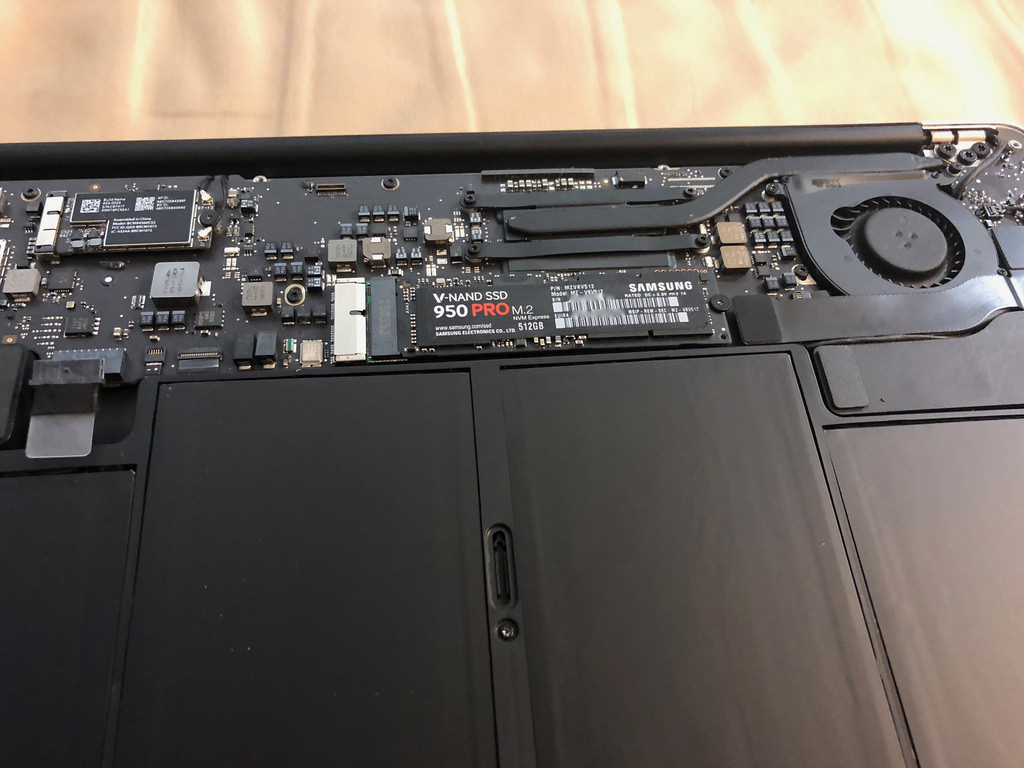

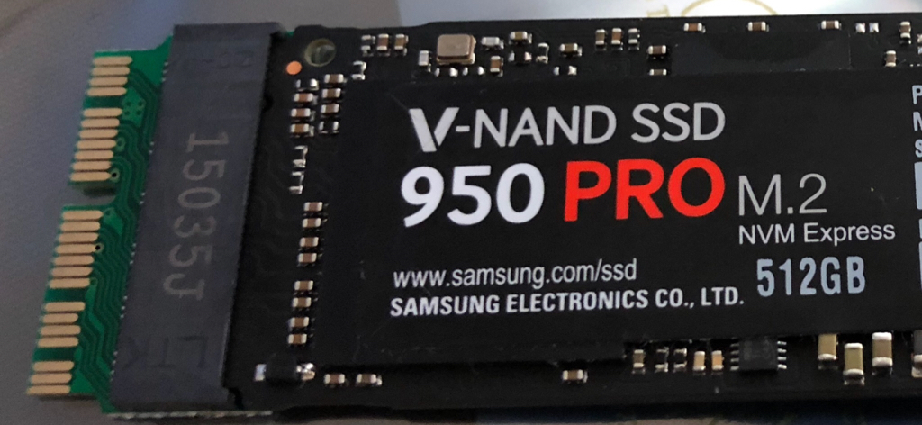

I put this in my MacBook Air, formatted it in APFS then installed High Sierra and did all the updates. So far I haven’t experienced any issues.
I put this in my MacBook Air, formatted it in the APFS format then installed High Sierra and did all the updates. So far I haven’t experienced any issues.

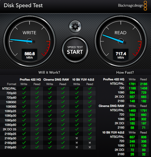

(i) With your NVMe m.2 950 Pro - have you tested your read/write performance in High Sierra

(v) Did you got an adaptor for the SSD? If so can you recommend one? I am asking as those that I found do not talk about 2017 models of MacbookAir

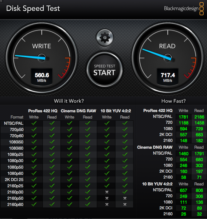

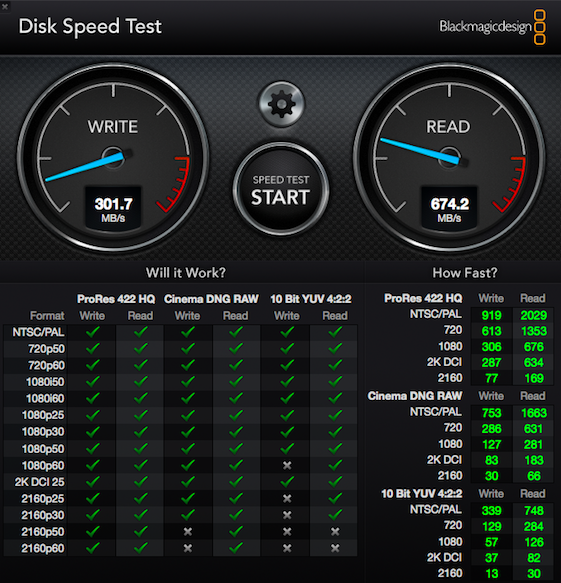

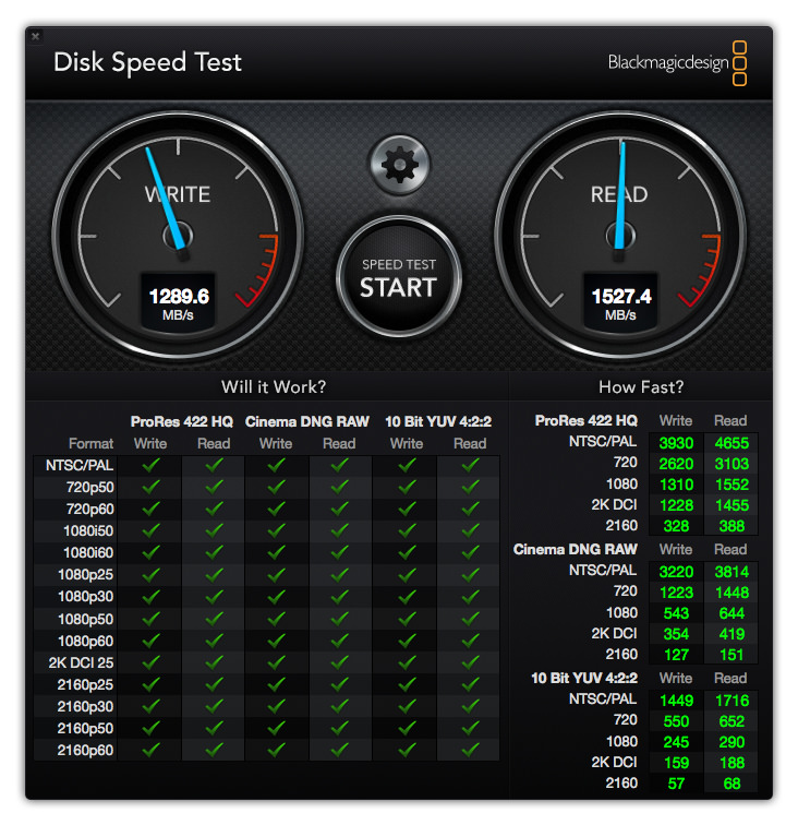

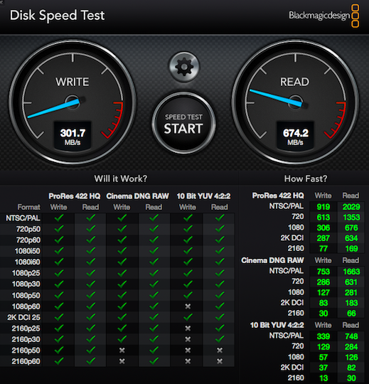

I ran Blackmagic Disk Speed Test on my Samsung 950 PRO NVMe drive this evening and came up with this result...
I should have run Blackmagic Disk Speed Test when I had my Apple SSD in before installing my 950 PRO but unfortunately I did not. The new drive is much faster and I'm pleased with both the faster performance and larger storage capacity of this drive 🙂

I chose to do a clean install. Fresh install of the OS and all application software. I made a bootable High Sierra install thumb drive and booted off of it to format my new NVMe drive using Disk Utility software. The whole process of setting up the NVMe drive was easy once I had it formatted in APFS...

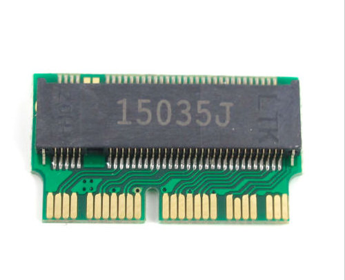

(v) Did you got an adaptor for the SSD? If so can you recommend one? I am asking as those that I found do not talk about 2017 models of MacbookAir.

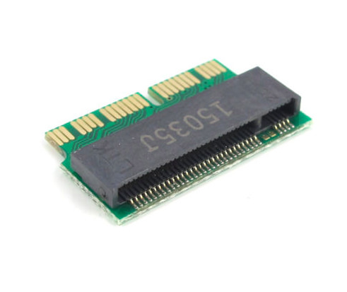

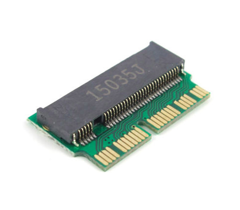

Yes I got an M.2 to Apple adapter for my MBA. Here is the link I used to get mine...
https://www.ebay.com/itm/112615200702?ul_noapp=true
However this is for the 2013, 2014 and 2015 versions of the MacBook Air... I would "assume" that this should work with the 2017's as well... but that's only a guess... hope my answers help!

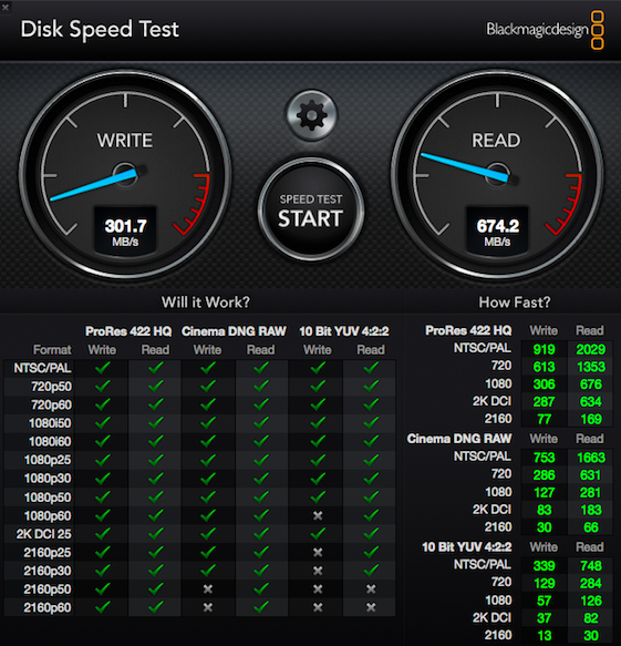

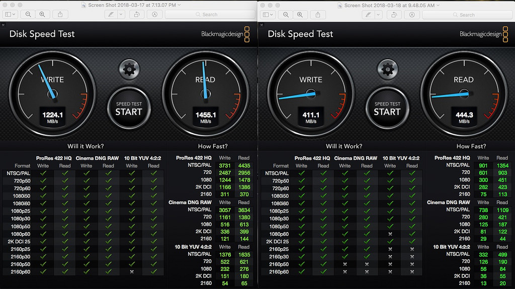

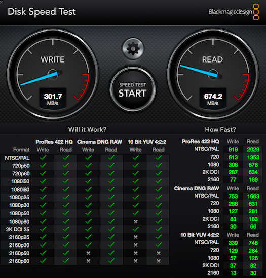

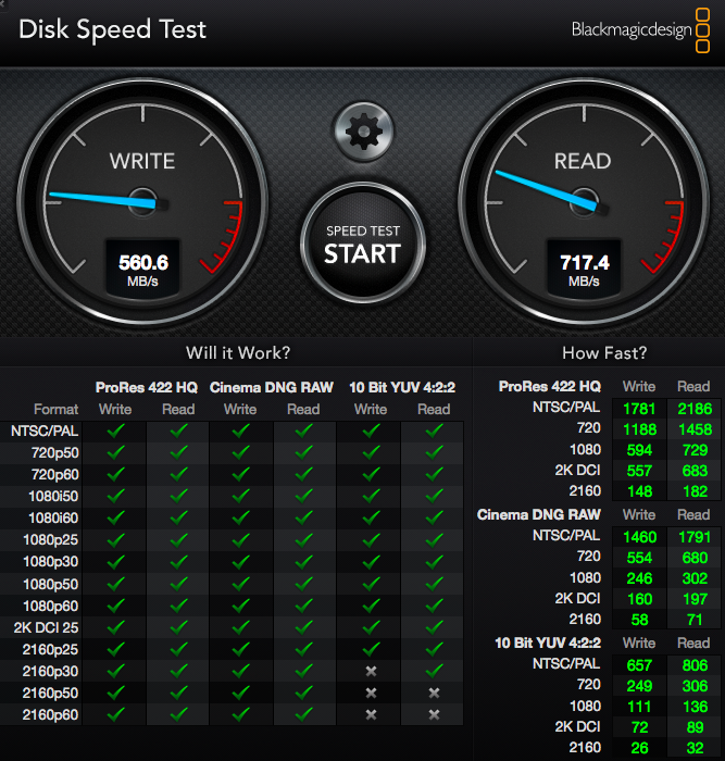

This is the drive comparison I ran between my MacBook Air with Samsung 950 PRO NVMe drive and MacBook Pro Retina 15 inch with installed OE Apple SSD drive.
My MacBook Air on the left and my MacBook Pro on the right
After looking at the test results above it makes perfect sense to upgrade to the NVMe drives... I plan to upgrade my MacBook Pro as well...hope all this info helps!

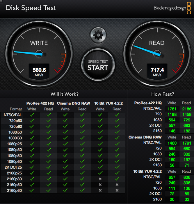

Just upgraded stock 256GB SSD to Transcend JetDrive 820 960GB and I have to say that I'm not impressed at all. New drive speed is only slightly faster than the original one, not 950Mbps as advertised... What's worse, new SSD consumes slightly more energy, so it's depleting the battery faster. Any idea what could be wrong?
stock 256GB Apple SSD
Transcend JetDrive 820 - TRIM OFF
Transcend JetDrive 820 - TRIM ON

I will start out by saying that I'm not familiar using the Transcend JetDrive 820 960GB. Not sure what is going on with your setup unfortunately.... not sure if anyone else does???
I just posted results with the Samsung 950 PRO and adapter that I used. So far this setup has been working very well for me.

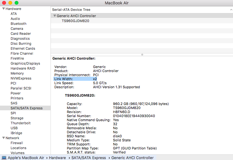

Could you please check on your MBA whether you have AHCI controller Link width x2 or x4?
I assume this is the root of my problem. Thank you
