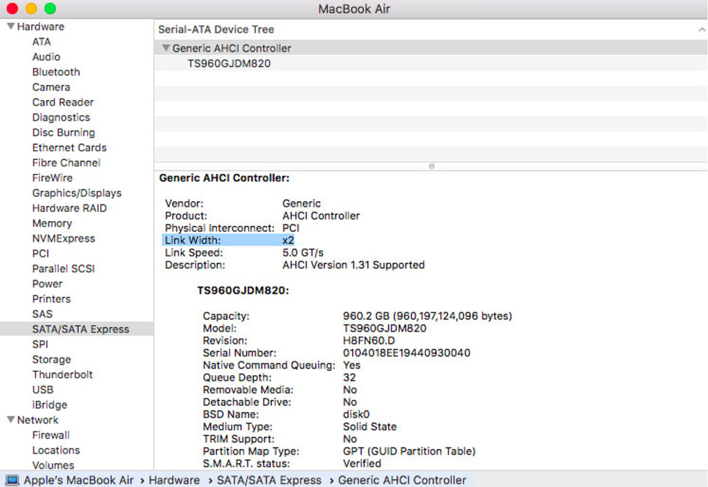

Could you please check on your MBA whether you have AHCI controller Link width x2 or x4?
I assume this is the root of my problem. Thank you

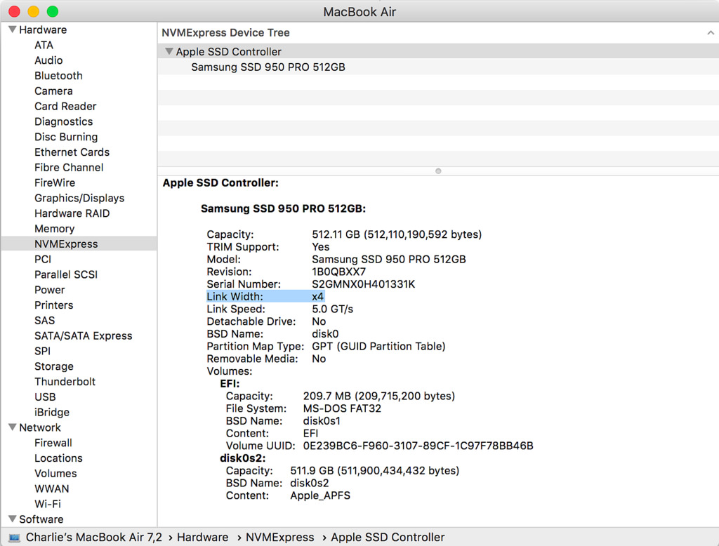

Okay duncho,
You can see how my MacBook Air is set up is different from yours. I see your issues right now and I'm sure you will as soon as you see my picture...
I'm not on SATA/SATA Express. My drive is an NVMe drive so it's on NVMExpress. I think the Link Width is automatically set by which Express channel your drive resides...

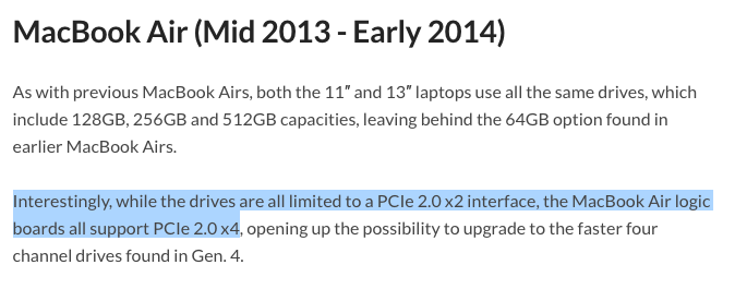

Well, now it's clear :) Good that I clarified this, otherwise I would be unhappy with my SSD selection. My MBA is 6.2 (mid 2013) so no wonder why chipset has x2 link width only. Thank you for your help!!
[doublepost=1521849132][/doublepost]So I researched a bit more about it and found out that MBA motherboard supports x4 controller speed. TurboJet SSD has support for x3 only, that is why I have x2 only :|
Looks like I will return the drive and buy the one you have, BUT - I don't want to upgrade to High Sierra :(
https://beetstech.com/blog/apple-proprietary-ssd-ultimate-guide-to-specs-and-upgrades

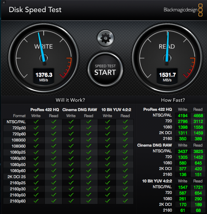

Well I have been running my setup for about a month now so I ran Blackmagic Disk Speed Test again just to see how my NVMe M.2 drive is performing in my 2015 MacBook Air...
Here's my setup:
- Sintech M.2 Adapter
- Samsung 950 PRO M.2 512GB NVMe drive
- Mac OS 10.13.4 High Sierra
this is the result of my Disk Speed Test today:
Still pleased with the performance of this Samsung 950 PRO M.2 drive. After a months usage, I still have not had any issues regarding sleep, power on start up or anything else for that matter. The Sintech adapter I am using with this Samsung drive has been perfect so far :)

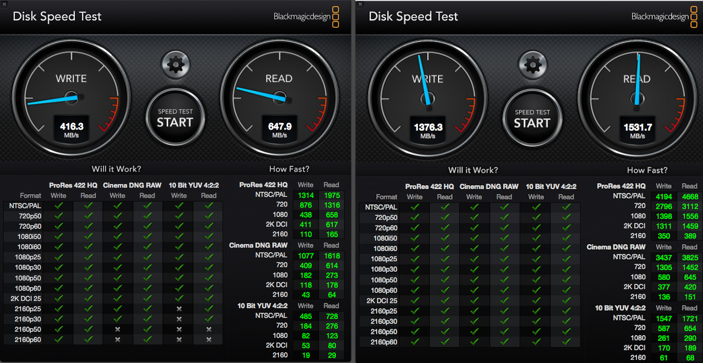

Tonight I reinstalled my original Apple 256GB SSD drive so I can show the actual performance of this drive compared to my Samsung 512GB NVMe M.2 drive.
The Apple drive is on the left and the Samsung drive is on the right.

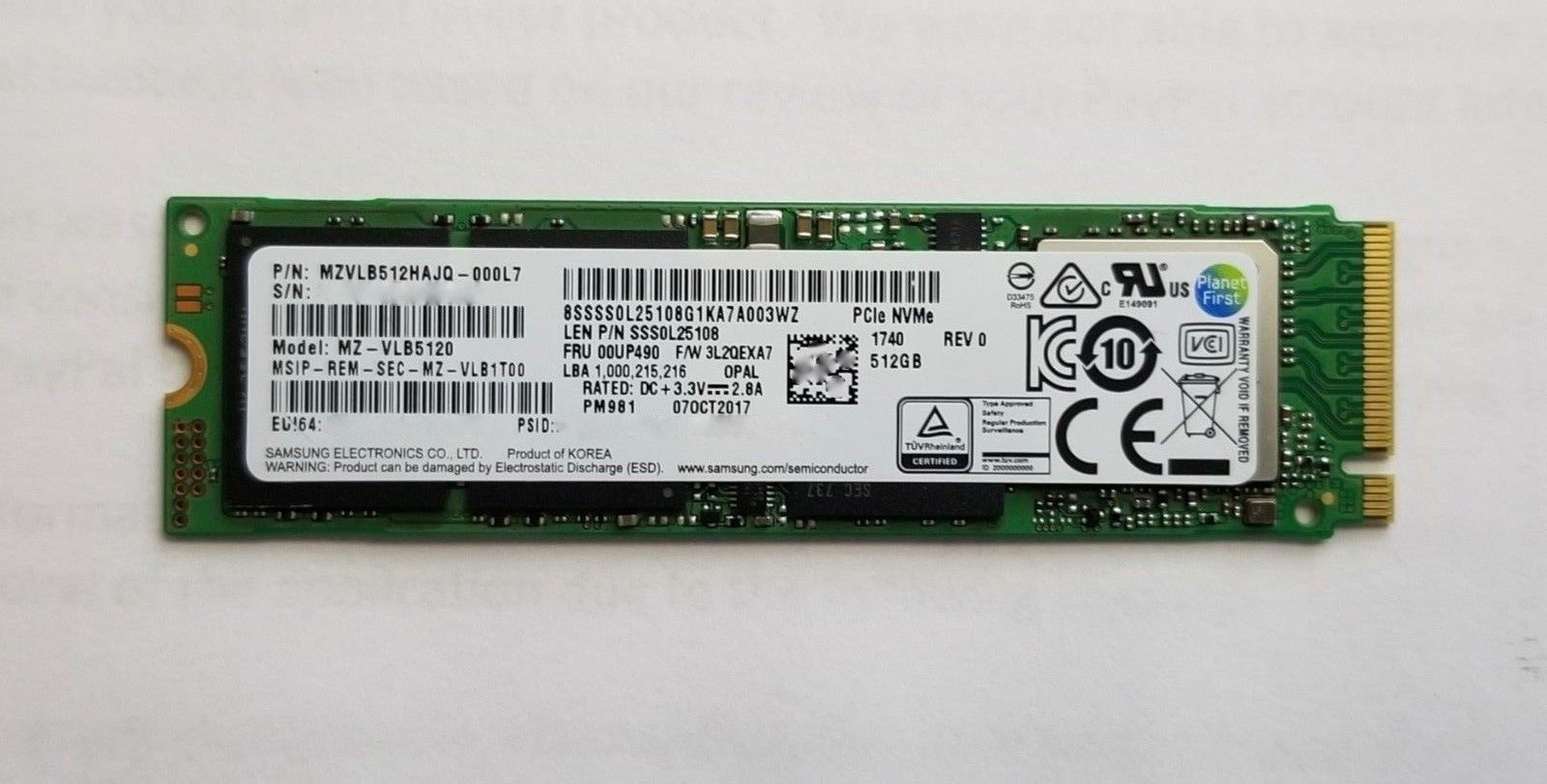

Here's another Samsung M.2 NVMe SSD I'm going to try in my MBA...
  • 512 GB Samsung PM981
  • M.2 (22x80) PCIe 3.0 (x4) NVMe SSD, PCIe Gen3 8Gb/s Interface, up to 4 Lanes
  • Read 3500MB/s
  • Write 3000MB/s
  • Samsung Phoenix Controller
I'll soon find out if this will work on MBAs:)

The Samsung PM981 does not work. I have reviewed efforts from the MacBook Pro forum and they have reported that the Samsung 960 PRO/EVO does work but I have not confirmed this for the MacBook Air. I do know that the Samsung 950 PRO does work however. I'm using this in my current MBA.
