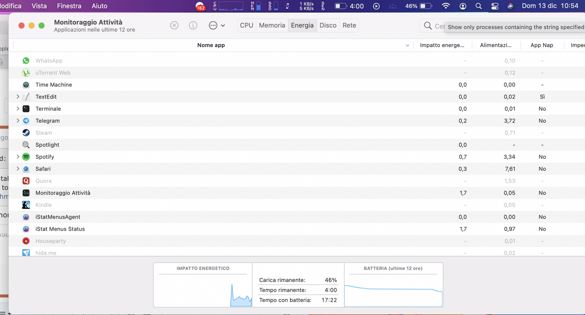

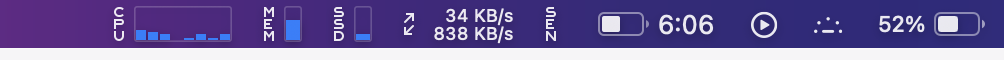

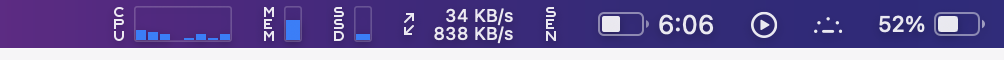

I have Tre tabs open on safari and Spotify in the background but I'm not playing music and brightness to 50%. Is it normal to have 6 hours left to 0%?

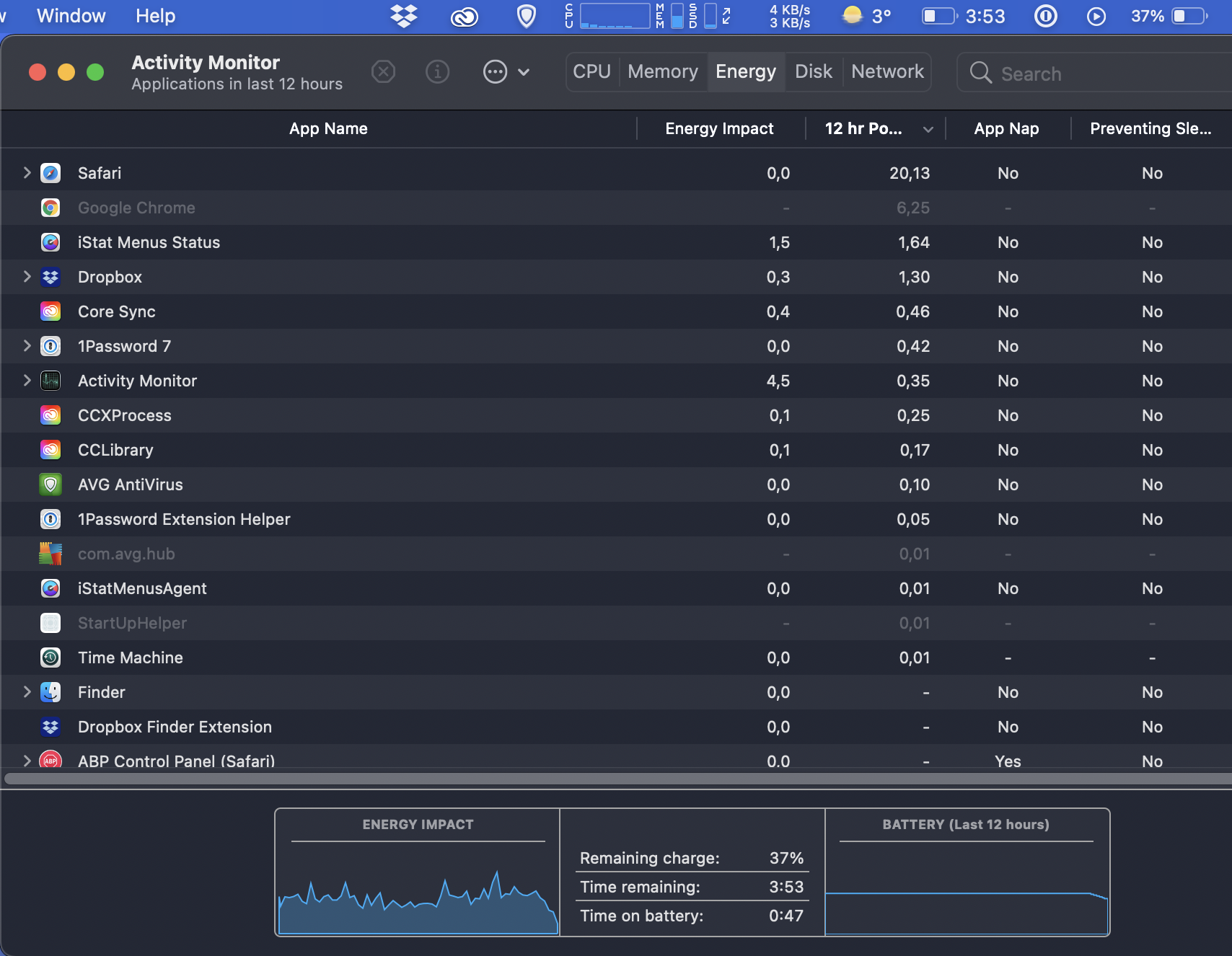

No, it's not normal. I think iStatmenu has still some serious glitches when it comes to M1 sensors

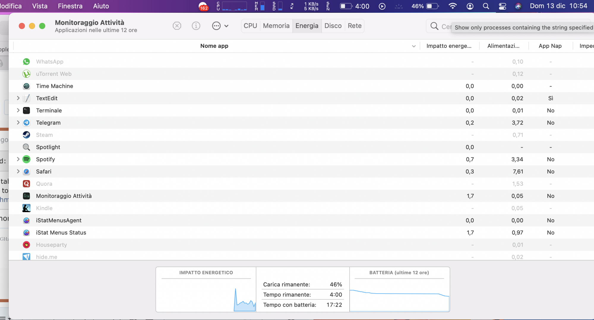

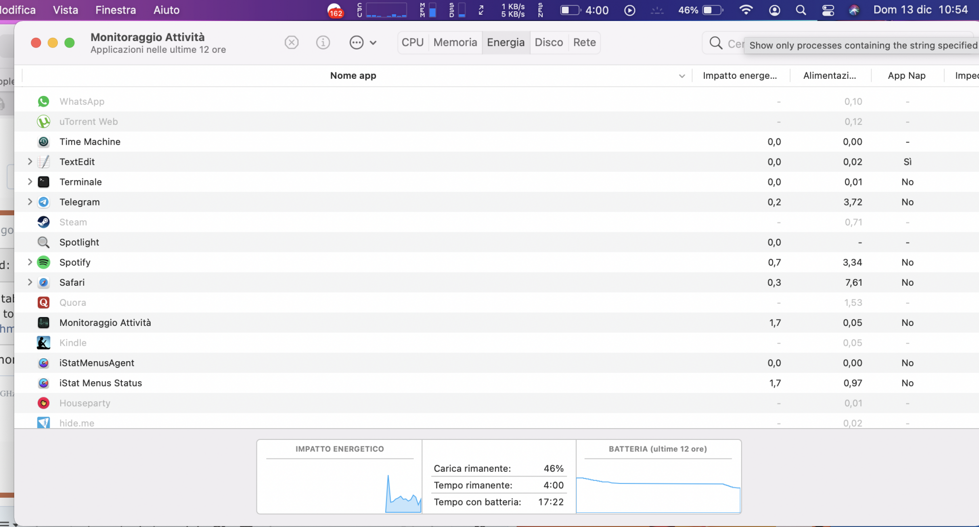

The hours of battery remain are increasing slowly but I can see that is the same with the activity monitor:

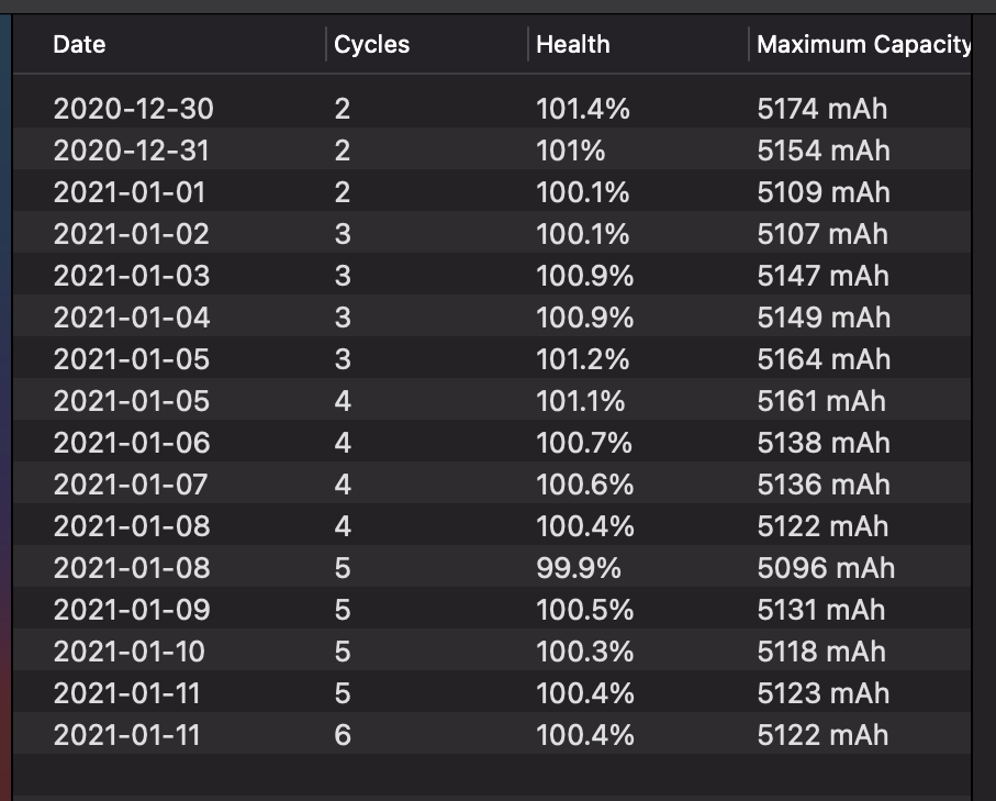

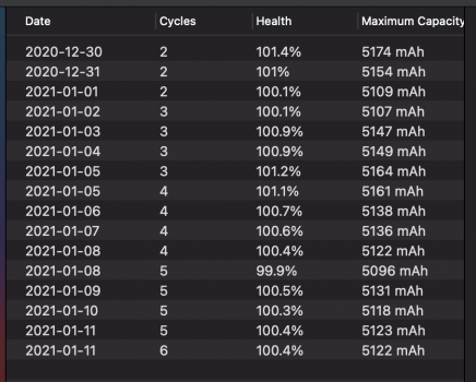

more or less the same here. The main iStamenu glitch is related to the battery health status that shows 2% (maintenance needed) on my MBA M1 with 2 battery cycles 😳
However I've just noticed that I had the brightness to 100% so now I see a more decent battery remaining. It is so beautiful the display to full brightness 🙂 (sorry for the English)

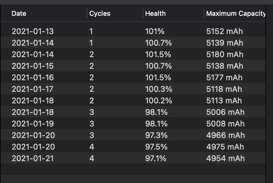

Similar situation here with my M1 Pro - 97% after 4 cycles, very disappointed.
Coconut reads the 'raw' battery info, you can get the same stats if you use the following in console and look at "AppleRawMaxCapacity".
ioreg -l -w0 |grep Capacity
Reckon this info can be used to raise the issue with apple as it's pulled from their console. Again, they are hiding battery data as the 100% we can see in system info is bogus!
I had two units, the first one had solid battery but a faulty ambient light sensor and I had it replaced. Now the second one has a Mickey Mouse battery 🙁
Apple is doing this for years. Many years. On my old 2010 MacBook Pro this already happened. Coconut and other readings said my battery was close to 80% health with a few months, the genius ran the test, and magically the battery was healthy on the 89-92% (I don’t remember the number exactly) so they didn’t aknowledge the battery was faulty.
This should be investigated by a consumers organization. You could try ti file a lawsuit in the US, as it seems its a good country to open a lawsuit and fight for a cause

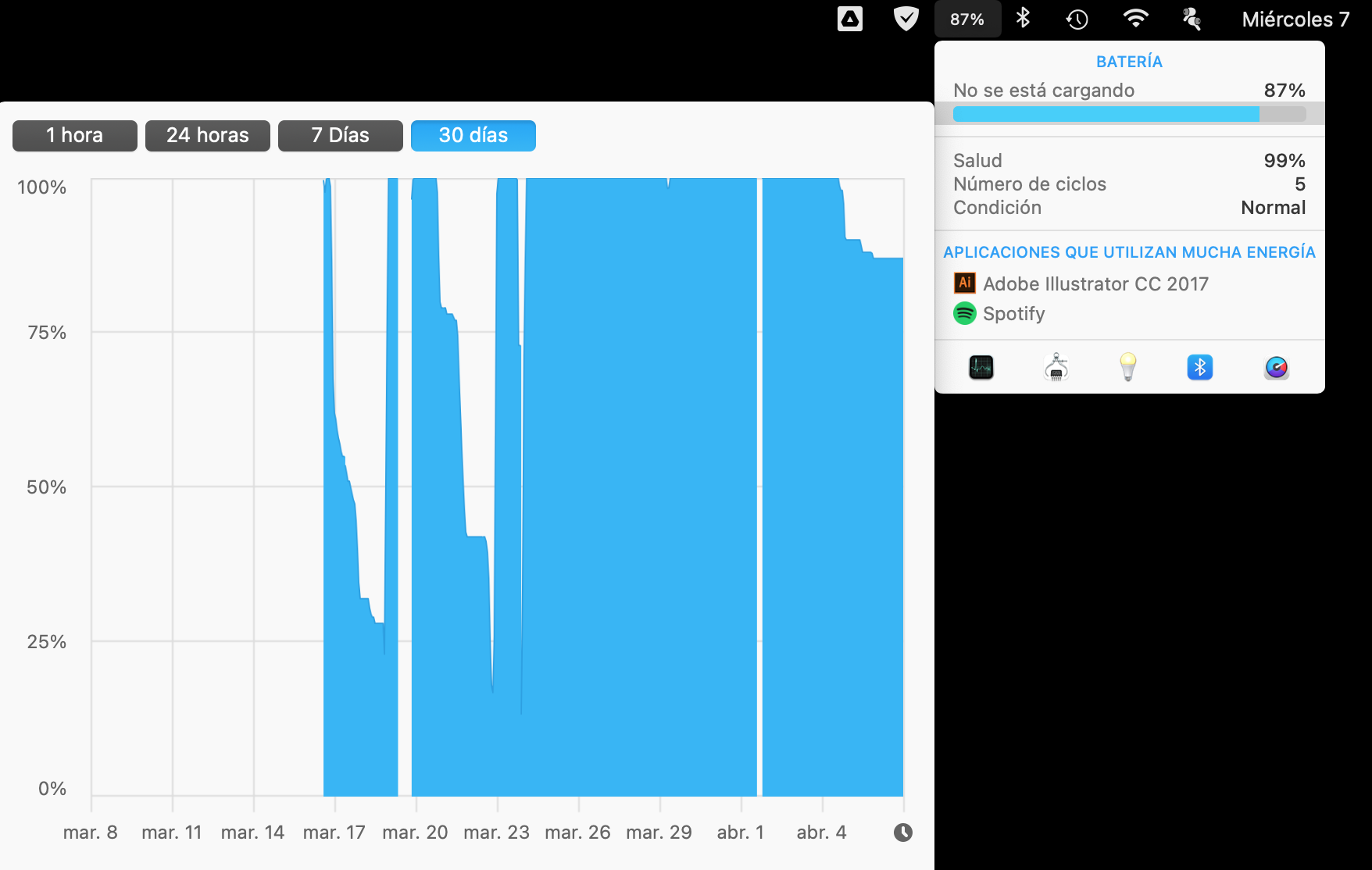

I have my Air M1 for almost a month now, I keep it plugged in at all times at home
I have it stuck to an usb3 dock that runs a 4k 60hz tv as a monitor and also goes to the audio system, apple bluetooth keyboard and mouse, never actually open the lid, interestingly the last 3 days its been sitting on 88-87% charge and says "its not charging" I assume is an automatic state designed for long periods of desktop use, since I have been using it but haven't physically touched it in 3 days.
Its been on 5 cycles for about a week now. One day I played stellaris unplugged for a few hours (3 hours tops) to see how long it would last (from 100%) but I got distracted and it went down to 0% and it took a whole cycle away and 1% battery health with it.
Id like to know if other intense desktop users have this same experience, I was tempted to unplug-plug-it-back to see what happens but I am more interested on seeing how far it goes like this, and how long it takes to do one cycle if plugged in all week consistently.
