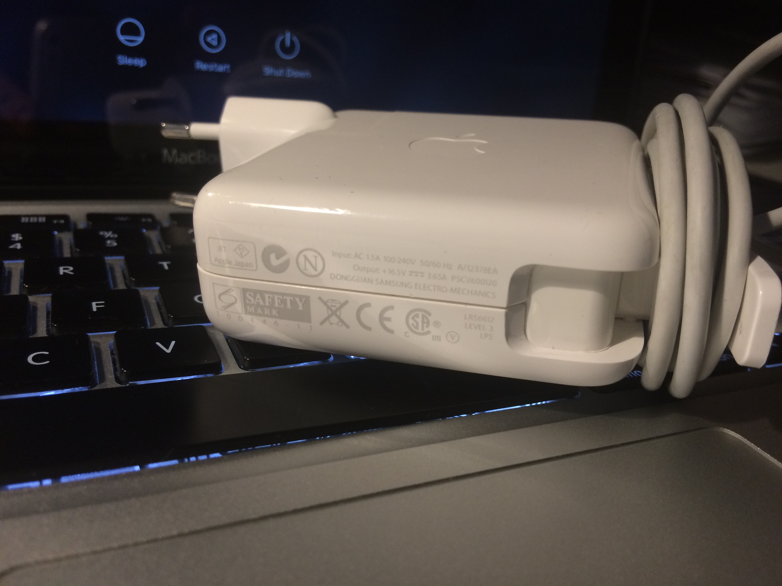

and my "original" charger looks like the fake one from video, light grey text.... could by fake charger ? i bought this charger as new original apple in third party store....
Charger is made by: DONGGUAN SAMSUNG ELECTRO-MECHANICS... it could by fake like this

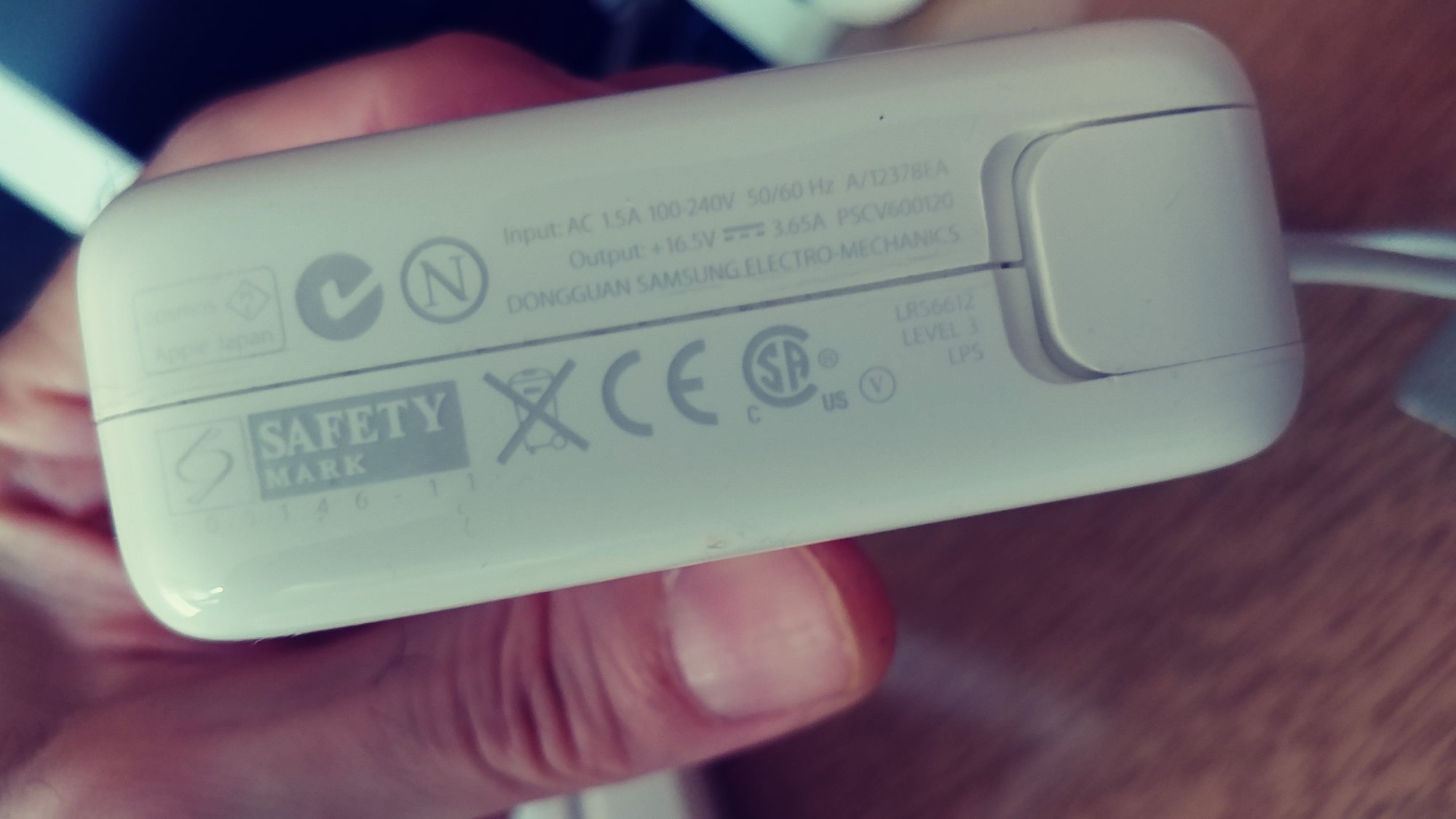

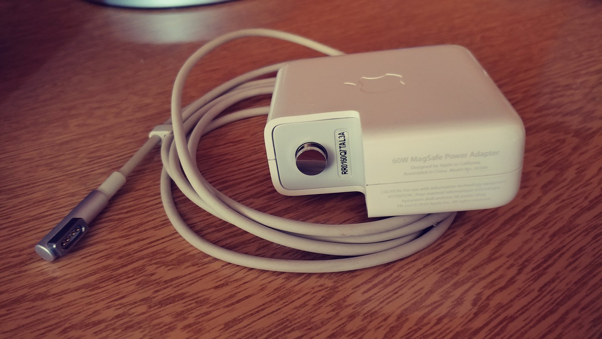

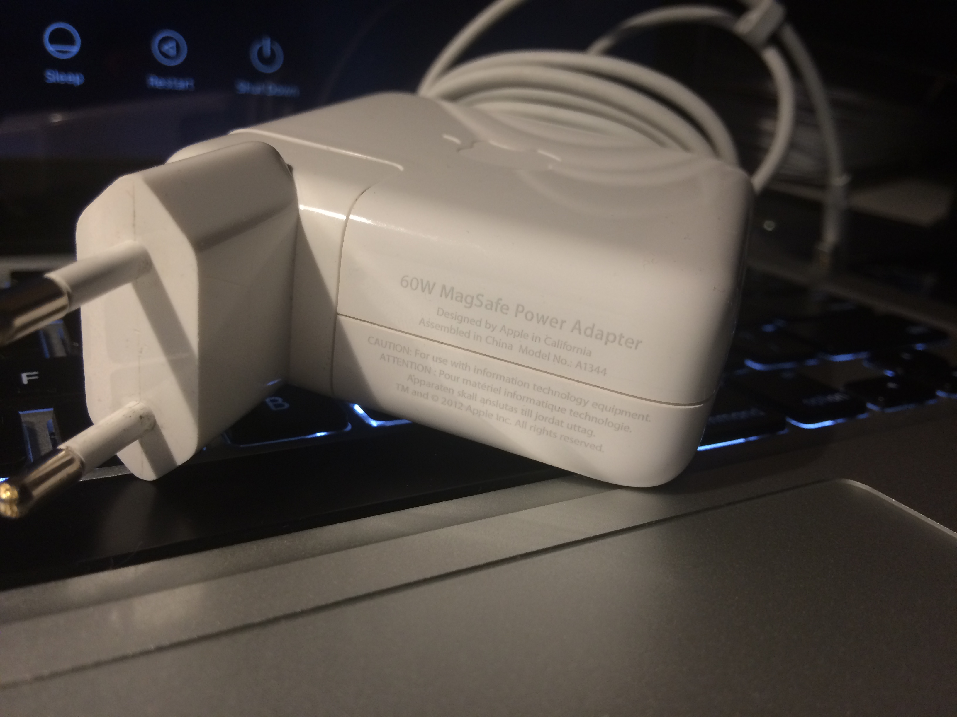

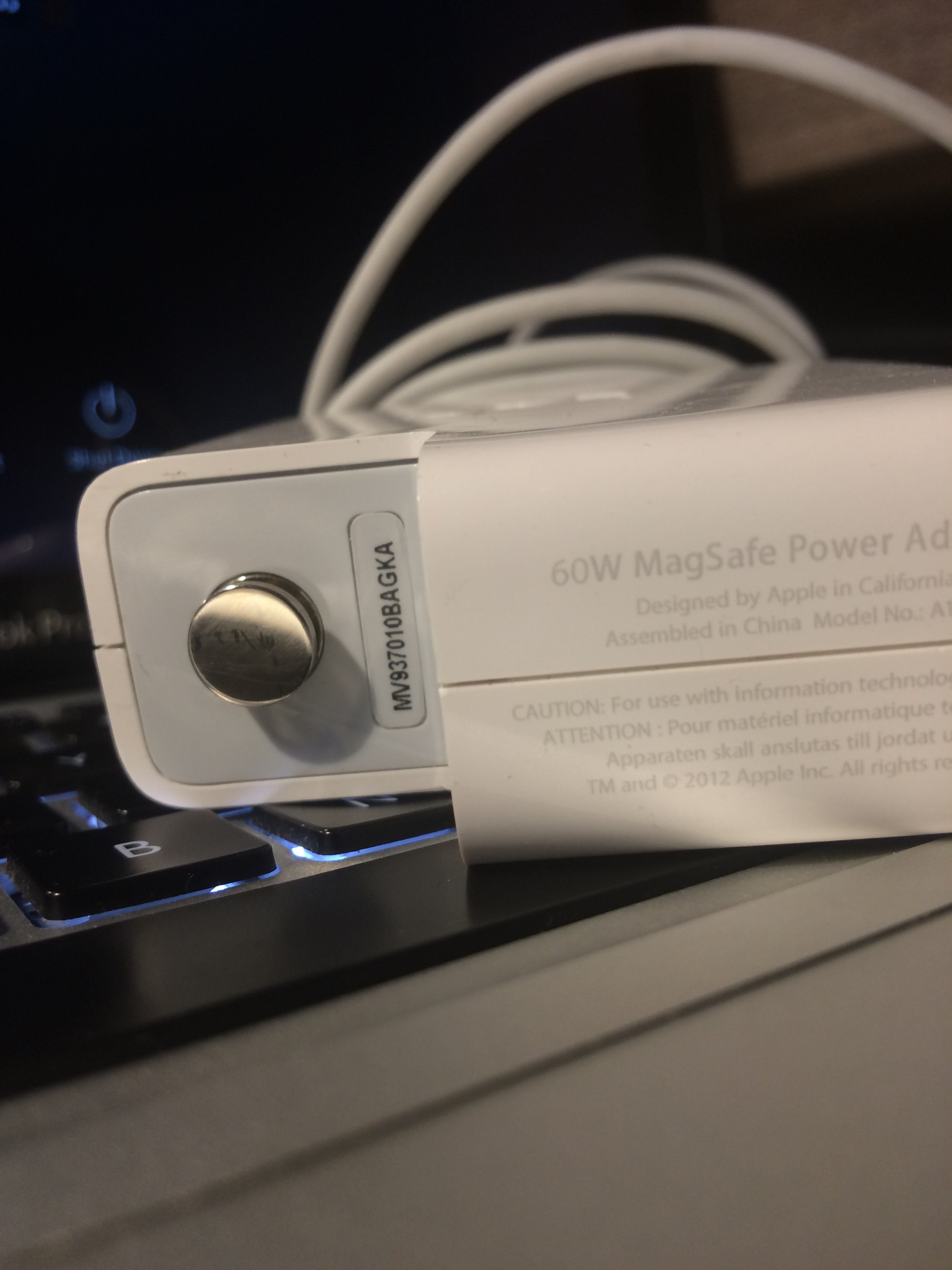

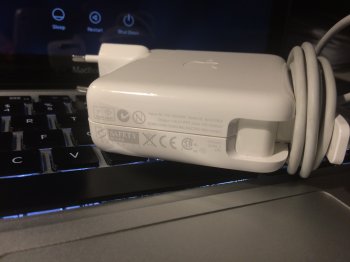

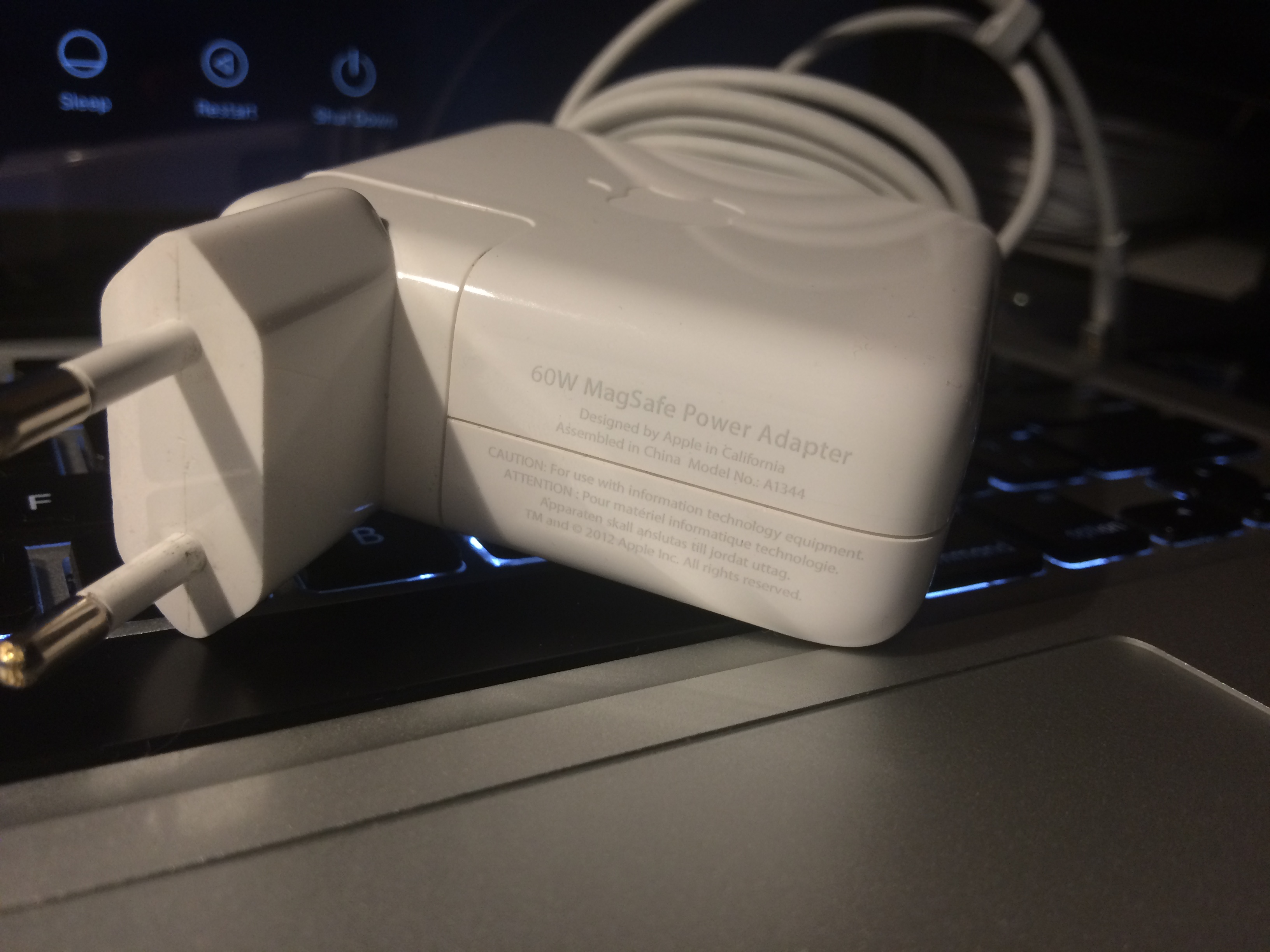

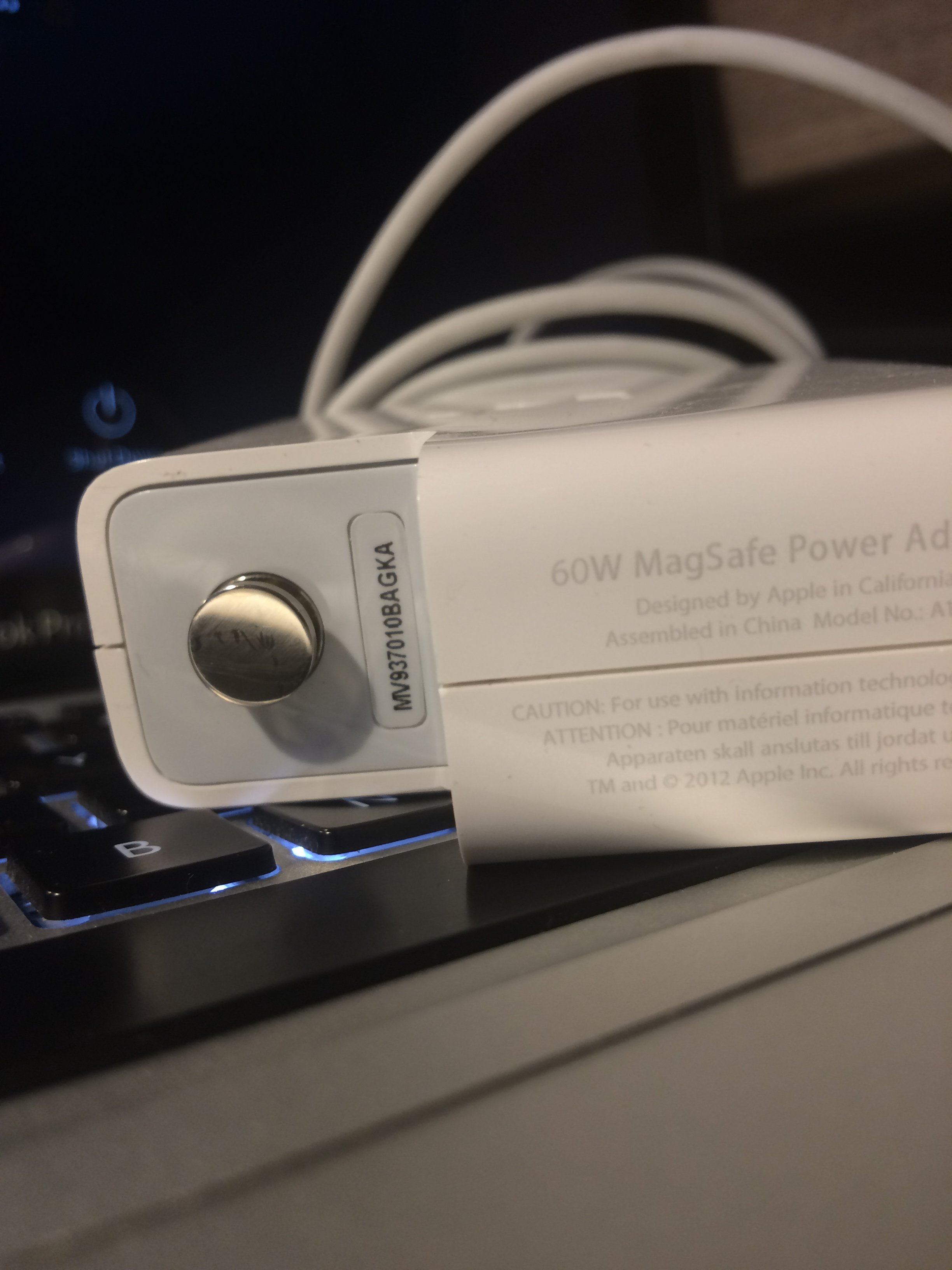

Post a picture of the writing on your charger?
Was your charger much cheaper than an original charger in Poland?

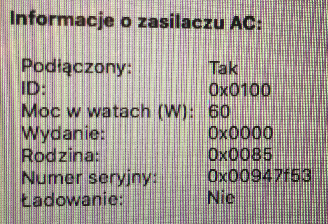

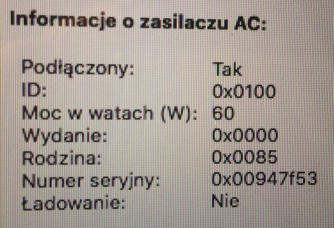

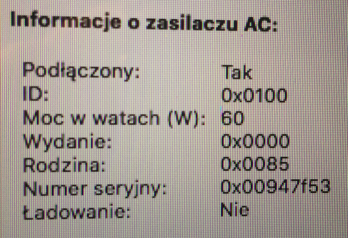

Look under about, system report, power. Is it recognized as a 60 watt charger and does it show a serial #?
The charger normally comes with a 6 month warranty?
When connected to the computer, did you see anything under system report about the charger?

i made some photos of charger and ac info.
What is wrong with my green light ? Hardware problem on motherboard or charger?

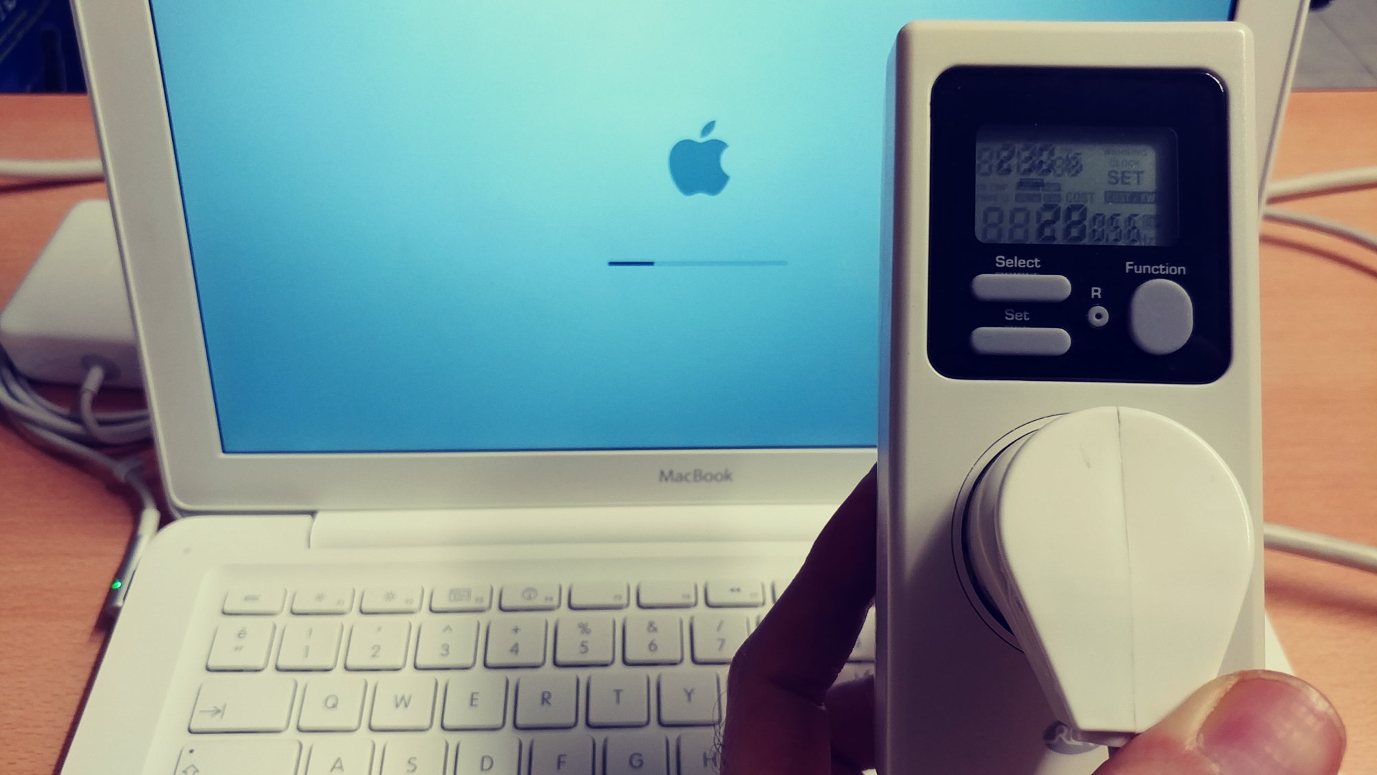

I've got a A1344 60W Dongguan Samsung make charger. I don't know if it's fake or genuine but it looks genuine.
Just one question: When I connect it to my Late-2009 MacBook whose battery is about %80 charged, it draws 14-15 Watts while charging the MB. I measure this with my Watt meter. The MB is not turned-on. Just its battery is being charged. Is this charging power of about 15 Watts normal?

Thank you for the comment. So, drawing 14-16 Watts for charging a turned off MacBook looks normal I think.
I've connected it to a Watt meter after I saw it being done in the video above. The reason I'm interested in adaptor's being genuine is because I consider selling it. It charges the MB in a quite reasonable amount of time. It doesn't get abnormally hot after a full charge. When the MB is fully charged, it draws about 25-30Watts during boot, Here it's seen to be drawing 28 Watts during boot.
When both the MB is not fully charged and the MB is being booted, it draws about 50Watts. I've seen 53 Watts maximum. This adaptor works in many circumstances quite well. Meanwhile, the 2006 Mac mini's were shipped with Dongguan-Samsung brand adaptors. The later ones 2007 and 2009 models were shipped with Delta Electronics brand adaptors. I have a Dongguan-Samsung brand Mac mini adaptör which I've been using for about 10 years. So it seems once upon a time, Dongguan-Samsung was a genuine Apple brand. So I assume, this Dongguan-Samsung MacBook adaptor is likely to be genuine. I stand corrected, though. Here are some photos of it:
You might wonder why I consider selling this adaptor for which I've said it's working quite properly. Yes it works properly but %95 of the time. Sometimes particularly when it's been working all day long and when nighttime comes, it just stops working! This happens only occasionally. Several times in the last 4-6 months, I had to use the MB from battery power during midnight because this adaptor refused to power. During those occasions (however rare they are) I couldn't make it work no matter what I did. I unplugged the adaptor, waited several minutes to ease it up, reconnected it no power. I shut down the MB so that it would draw less power, connected the adaptor, no power. I can't rule out the possibility of some malfunction on the MB or its battery, though because when I got this MB it had a swollen battery then I replaced its battery with a %75 to %80 healthy, genuine Apple battery and its MagSafe connector socket looks just a bit out of shape too. After I put the connector in its place sometimes I have to tinker with it to connect it properly. But those issues on the MB are minor ones. I think the adaptor is the faulty one, however slightly. So I've summed it up by saying it works 95% of the time. Anyone who doesn't use MB all day and night long, like I do, s/he might not event notice this little fault.
