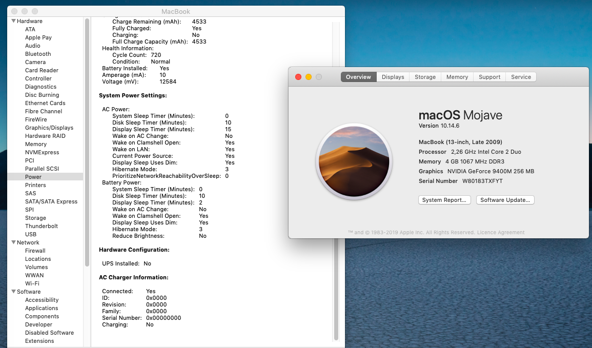

On this blogpost, one particular thing drew my attention. It was saying if the System Report>Hardware>Power>AC Charger Information displays Serial Number as 0x00000000 then it's a fake charger. I've connected my charger and looked up that number. Here you are:
The Serial Number is 0x00000000 (!)
