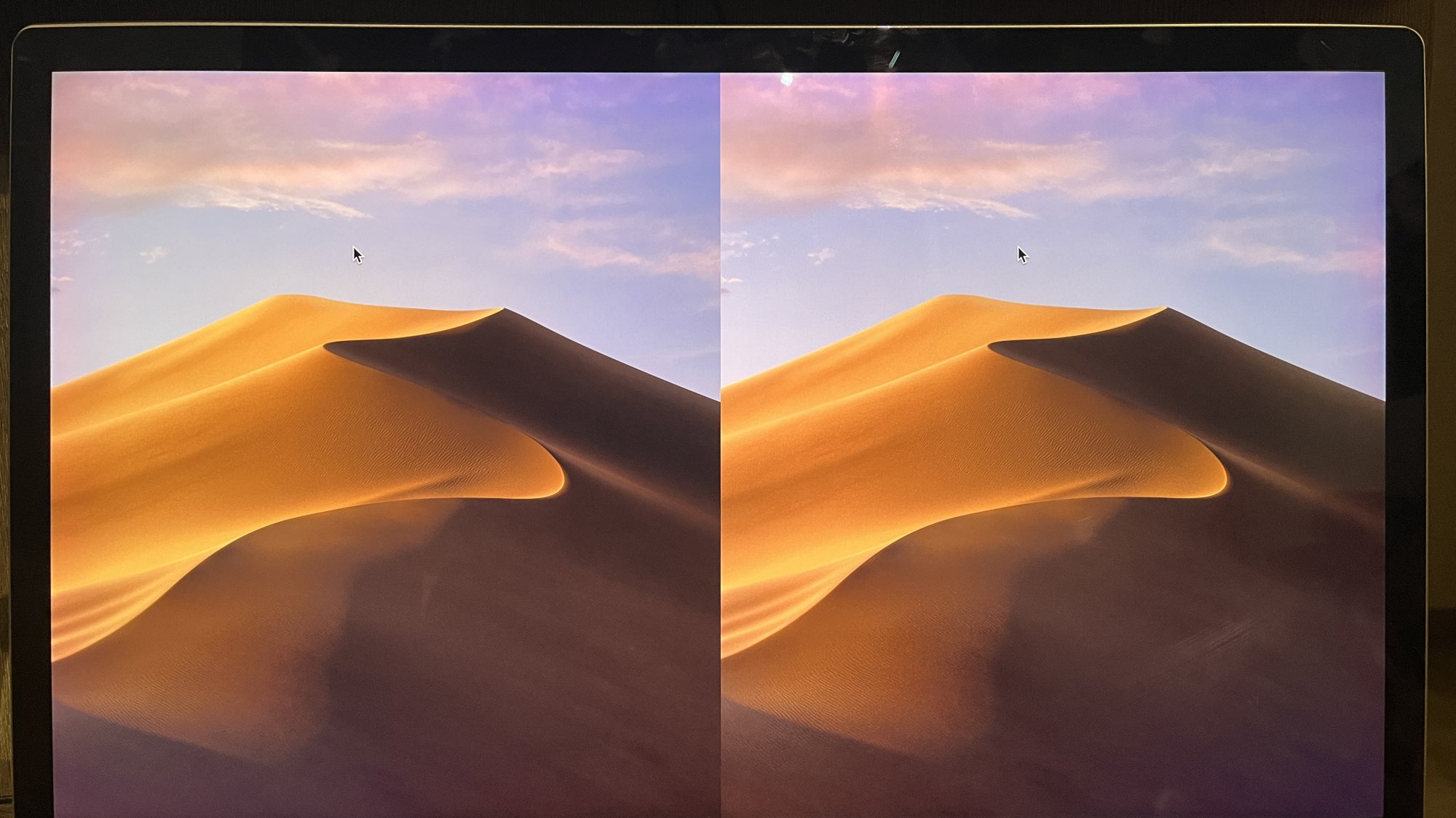

Edit : I found out that using 1 display port cable did solve the split-screen issue and I get a full 5K Image using the first display port of the DELL, hurray! Screen flickering is also gone after 2 hours of use, the dell had to get used to the 5K apparently. Still random disappearing of the whole image that comes back after 3,4 seconds, let´s hope it will also resolve by itself with time.
----------------- original post.
Sorry to revive this thread but I have still a problem with the M1 Macbook Air and the Dell UP2715K running under Sonoma 14.4. I am connecting the m1 to a StarTech USB-C to Dual DisplayPort 1.4 Adapter with 2 Display Port 2.1 Cables and should get a 5K image but the picture is only appearing as a split-screen on the DELL and the possible resolutions are :
2560 x 2880
848 x 480 (by défaut)
800 x 600
1280 x 1440 (HiDPI)
800 x 600 (HiDPI)
Does anyone have faced this problem and could find a solution for this?
2560 x 2880
800 x 600
1280 x 1440 (HiDPI)
800 x 600 (HiDPI)
me too has exactly the same issue, did you solved this issue ?
