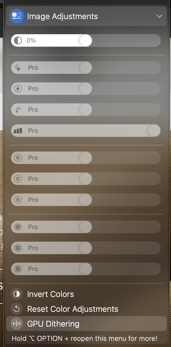

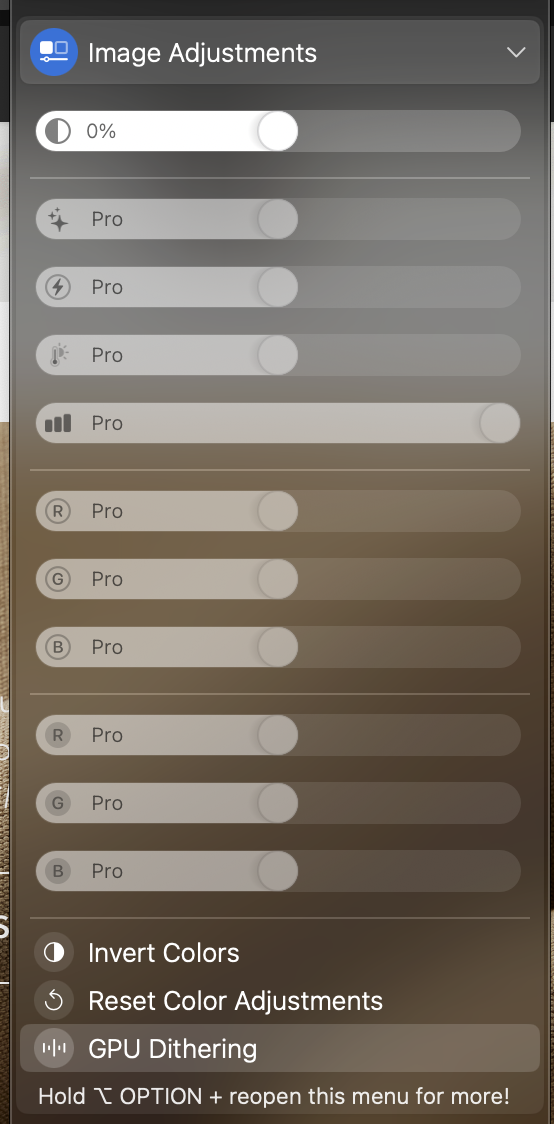

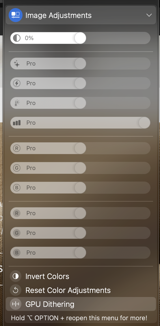

I think I've found a solution of editing the monitors EDID information using AW EDID Editor to remove the Ycbcr flag and re-uploading it with BetterDisplay. Been a couple of days with no flickering now.
Just now using BetterDisplay (current version), I was able to turn the flickering on and off(!) per display by turning "GPU dithering" off under image adjustments for my external displays. I will edit this if anything changes but it seemed to be a switch for this issue, turning it on and off at will which was crazy. It even sounds like the sort of thing that would cause this. Please try this and let me know, hoping this helps others! (I also hope Apple really fixed it as LostProgrammer said.)
drunk wrote:
"I think I've found a solution of editing the monitors EDID information using AW EDID Editor to remove the Ycbcr flag and re-uploading it with BetterDisplay. Been a couple of days with no flickering now."
Could you elaborate on this a bit?
Steps taken, in order?
I'm sure a more detailed "how to" would be a BIG help to a lot of folks with the same problems...

Sure, will report back tonight with the steps and screenshots!

Has GPU dithering toggled off per external display within BetterDisplay not worked for you? I haven't seen it not work yet. With this, I can toggle the flicker on and off instantly, it is not the same as how changing settings fixes it for a bit, it stays off permanently. It appears to me this is the root of the issue after trying everything under the sun.
I haven't a flicker/strobe a single time in months since I found that fix I posted above, with any display settings I want. This is across multiple Apple Silicon computers and every external monitor I've tried.
As a note, it has no effect toggling it on my built in display as that does not flicker, but for every external display, setting it has been the only thing I need to do to live a flicker-free life.
BetterDisplay in the Menu Bar > (Each External Display) > Image Adjustments > GPU Dithering set to OFF. Works in the free version too. I hope this works for everyone as it has for me 🙂
Didn't work for me
