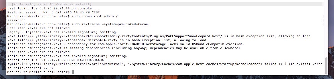

Updated my MacBook Pro 5.3 to 10.12.1 and lost everything USB after normal boot (worked fine in recovery partition boot). Reapplying post install patch threw "not a legit Sierra install" (or similar). Thankfully reinstalling 10.12. worked.
I also tried clearing caches, terminal messagges in the attachment...

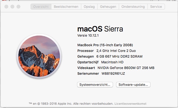

Hi,

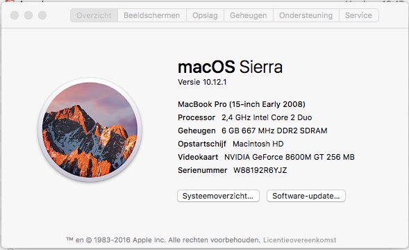

Just did the 10.12.1 update on a MacBook Pro 4,1 (Early 2008) using the AUSEnabler.
The result is an updated MacBook Pro.
I am using my iPhone 6 Plus as a hotspot connected by an USB cable.
I am not experiencing any USB problems...

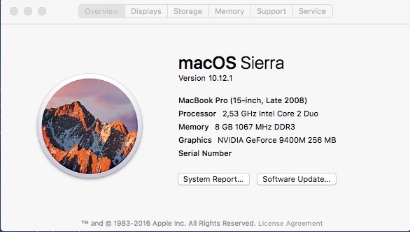

Macbook Pro 5,1 (Late 2008)
10.12.1 Update went fine (AUSEnabler)
Had trouble before when battery went flat and macbook turned off.
Mouse and trackpad didn't work after reboot.
-> Boot with patched installer usb drive, turnoff SIP with terminal ("csrutil disable")
-> Dosdudes Patch Tool > Force Cache Rebuild
Thanks for the help!
