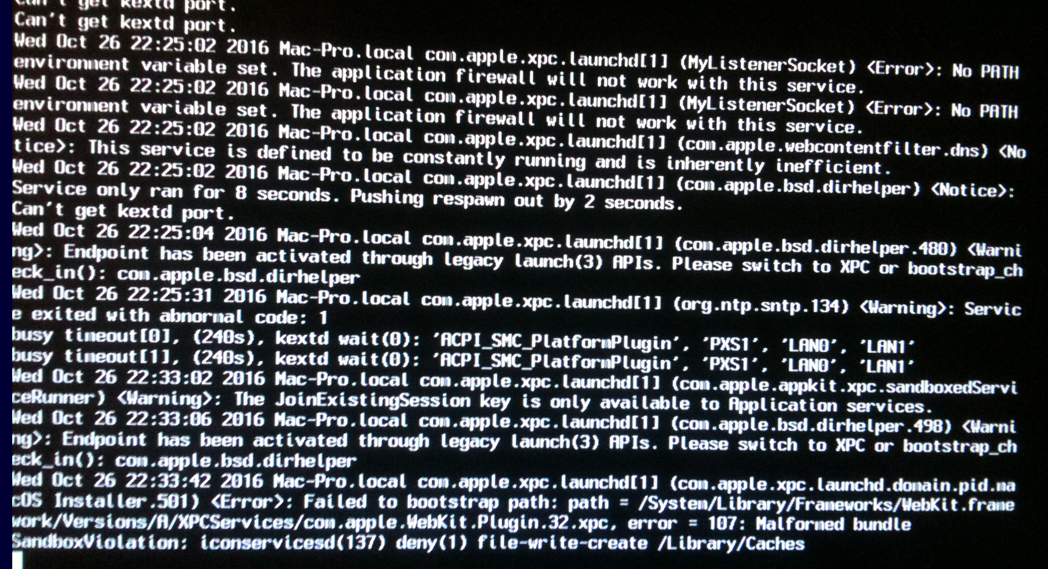

No problems with patched installer other than 1: Occasionally it gets stuck on language chooser
Stuck as in “hangs a while”, right? Not “throw up the error log full screen and require a forced restart AND complete redo of the USB stick’s software”. Do you have a 2009 Mac Pro as well?

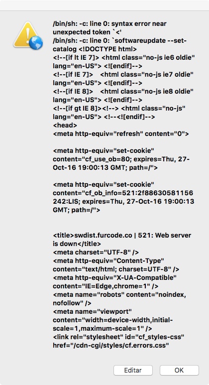

I'm not being able to run AUSEnabler. I'm getting an error everytime (photo attached).
How to fix this?

Stuck as in boot from USB to installer and instead of menu bar having installer options like disk utility, terminal, etc, it still has the language selection menu bar (even though language has been selected). It has happened a few times. I have just rebooted to USB installer again and it operates normally.

@foxlet's server appears to be down right now. Only option right now is to wait for him to get his server back up, or patch the dist file manually.
Reactions: CA3iR0
How to fix this?
You should be able to use it now.

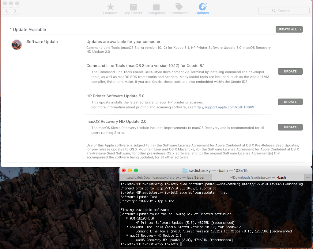

here is my terrible java attempt at a proxy which modifies dist files itself. set your catalog url to http://127.0.0.1:9432/1.sucatalog, then run it

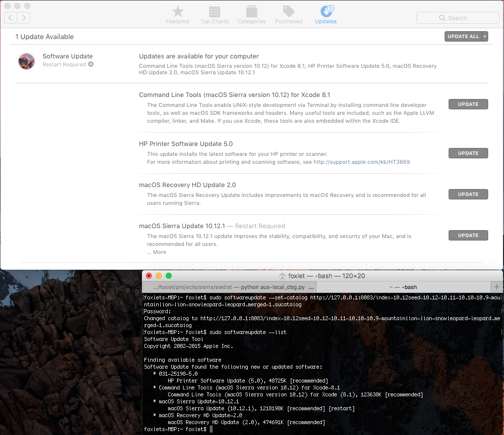

Testing it in Sierra, your attempt doesn't seem to work. It's only proxying requests and replacing the catalog's resource URLs, which isn't actually enough to present blocked Sierra updates under SoftwareUpdate (they remain missing).
I tested the local AUS server to make sure there wasn't some conflict in the way:
Reactions: CA3iR0

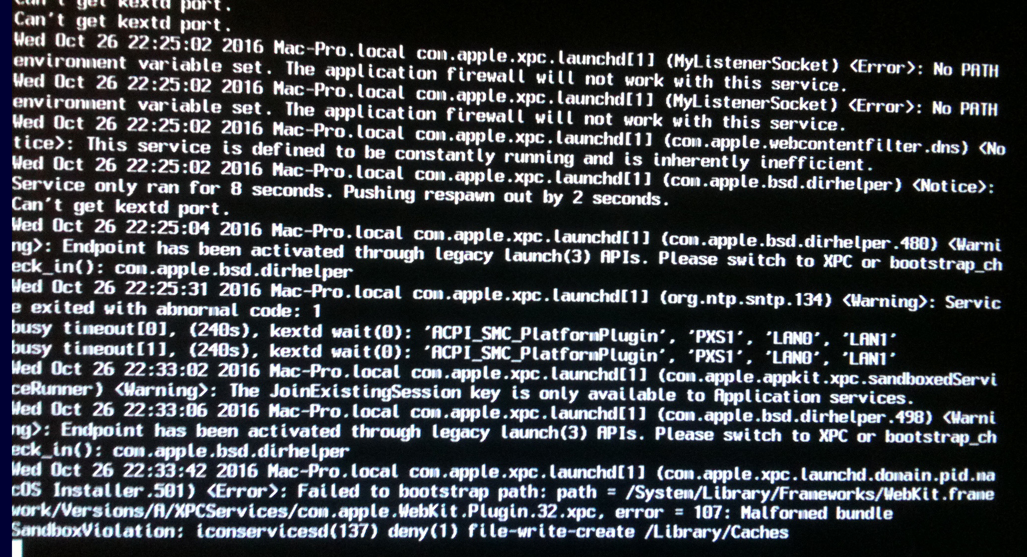

Hello!
Can't figured this out. my Mac Pro 3,1 won't fully boot from USB flash-drive - get the progress bar OK, but then it stalls even if left overnight.
I've patched per dosdude1's (carefully followed) instructions.
Have tried different USB ports (with only keyboard connected). Tried everything I can think of really. Same results no matter what - please see pic below. Thanks. Any help greatly appreciated.

Usually this issue is caused by an incompatible GPU... What graphics card do you have installed in your system?
Thanks for the prompt reply! Ohhh dude.... it's a Dell (literally).
ATI Radeon HD 5770:

Although I feared this might be the culprit I had no reason to really really suspect it, because it's done very well up till now. Don't suppose there's an easy solution other than to upgrade it. And, to what? (there's probably already been a thread about that, I think)
Thanks again though.

That's odd... That card should work fine. Do you still have the original Radeon HD 2600 or GeForce 8800GT card your machine came with? If so, I'd try installing that, and then give it a try.
