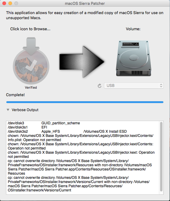

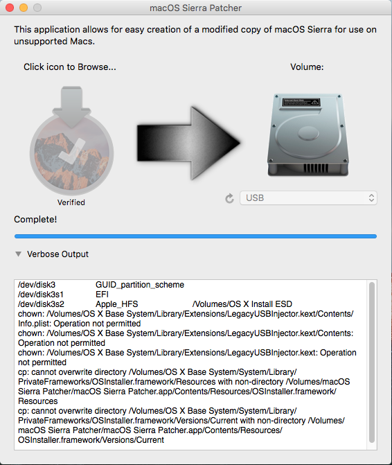

Is anyone else getting those errors? The operation appears to be complete, but then when I try to boot through USB, it gives me the prohibition icon. I already have disabled SIP, but no success. Would very much appreciate any help. Thanks!

Im also stuck at this very issue. Did you get any luck? Thanks!
Those errors are normal, and shouldn't cause any issues. What machine are you using? And at what stage does it show the "No" symbol (right after selecting the boot drive or after showing the Apple Logo for a bit)?

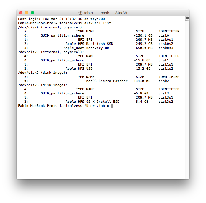

Hey, thanks for the reply.
I have a Macbook Pro mid 2009 running El Capitan, and the prohibition symbol appears to me right after hitting enter at the USB, so no Apple logo. What do you think it could be happening?

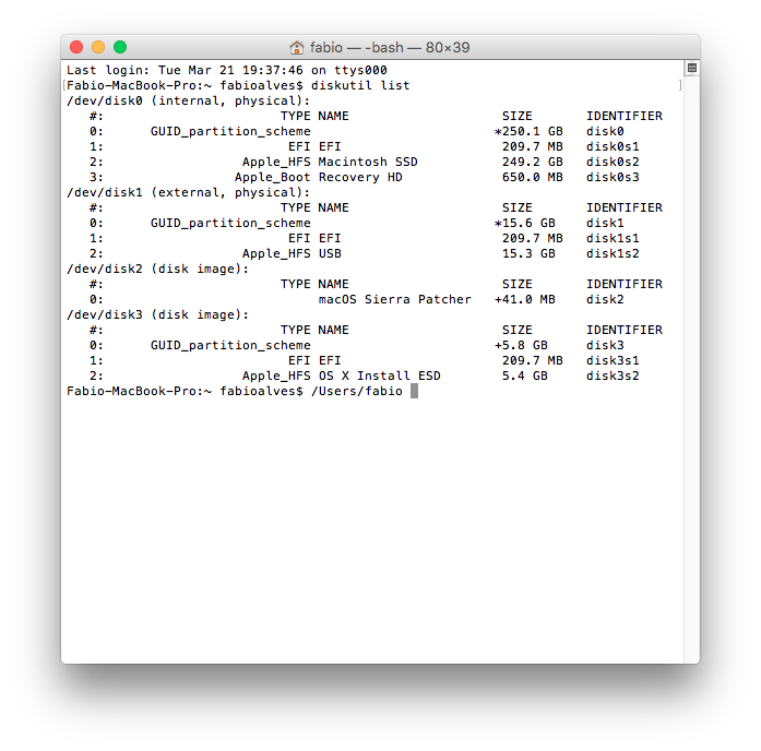

I have two screenshots that might help you identifying the issue. I'm not an expert, but when i run diskutil list command, it shows me that my USB drive is located at disk1, but when running macOS Sierra patcher, it appears that all the action happens at disk3. I hope this info can help you. And thanks.
View attachment 693062View attachment 693063
That's just listing the disk containing the macOS Sierra installer files (mounted InstallESD.dmg from the Sierra App). Once the patcher finishes, boot the drive, and hold "Command + V" while selecting it on the boot menu. It should show you a black screen with text. Let me know where it hangs.
Actually I've just managed to install macOS Sierra, I just ignored those warning messages that were given on macOS Sierra patcher, and the first time I got the "no" symbol, so I tried again and it worked like a charm, and everything seem to be working just fine, I'm just a little bit concerned about updating. I hope this process goes without any trouble. Thanks a lot for the support, you did a great job with this tool.

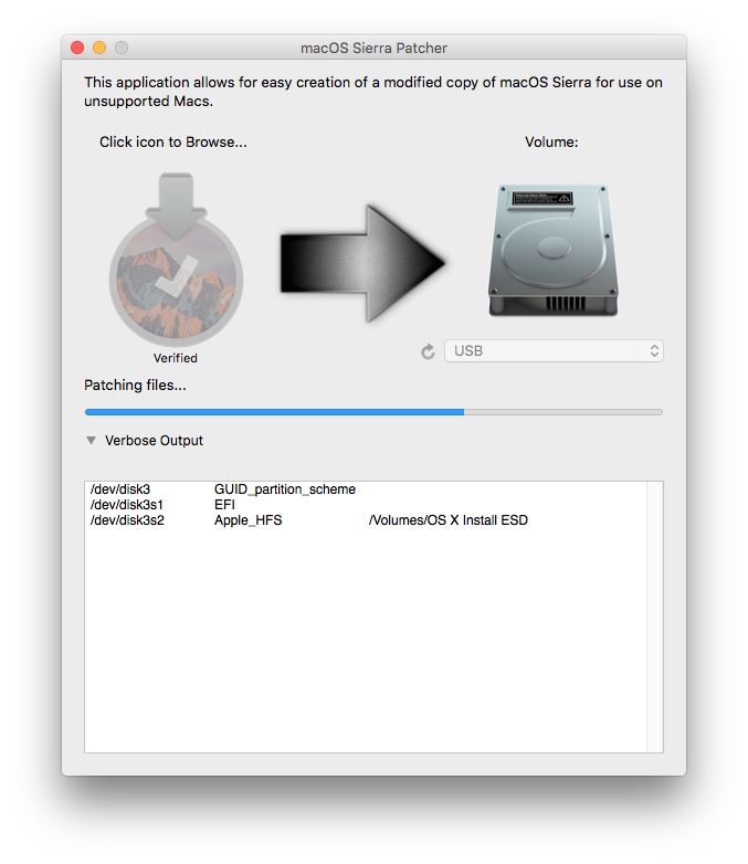

Installation went just fine, and everything is working, except for every time I close the lid Wi-Fi disconnects from the actual network, and I have to connect it manually, although it doesn't ask for wifi password everytime. Anyone got a solution to that?
Hi all,
I recently picked up a Mac Pro 3,1 that I hope will let me retire my 1,1 model, to run 10.12. It's bone stock 6GB/250GB SSD/ATI 2600XT graphics, no wifi yet.

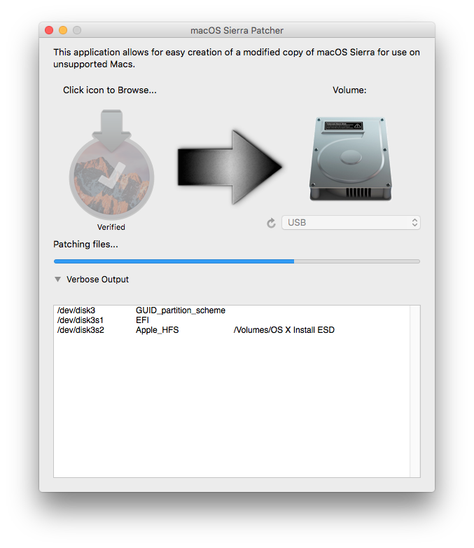

I'm trying to install the dosdude patch on a 27" 2011 iMac with a fresh, verified download of 10.12.3, latest dosdude patch, good 8GB USB stick that I've used to install many an OS X version. I'm coming up with the same errors as others have posted in the last page. Installs OK with the LecacyUSBinjector error, boot off USB on the Mac Pro ... boots up with a progress par ... and "no" symbol a couple of minutes later. I've tried to rebuild the USB several times.
Any tips? Thanks for making this a possibility.

Hi all,
JB

If you're currently running mac OS X El Capitan you should try disabling SIP. I've been told these sequence of errors are pretty normal, and shouldn't stop you from installing macOS Sierra, but I have disable SIP anyway, and then i've rebuilt the USB Drive again, and got the same errors, but it was possible to install it anyway.
Thanks, I'll try that - yes I'm running 10.11 on my iMac 27" still which is where I'm trying to install the dosdude patched version of Sierra. I'm also currently downloading the older Sierra installer from dosdude's site ... slowly.
