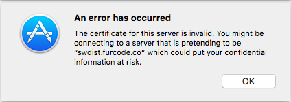

App Store just gave me:
An error has occurred
The certificate for this server is invalid. You might be connecting to a server that is pretending to be “swdist.furcode.co” which could put your confidential information at risk.
#host swdist.furcode.co
swdist.furcode.co is an alias for fox.furcode.co.
fox.furcode.co has address 46.101.206.7
my DNS are Googles being 8.8.8.8 and 8.8.4.4 and my clock date is correct/current.

I reverted back to Apple's SUS setting and received RDC 3.93 and iTunes 12.7 okay.
Can other please confirm if this is the case...

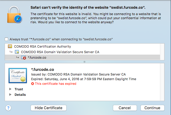

I too am getting this. It looks like the security Certificate may have expired back in 2016.
