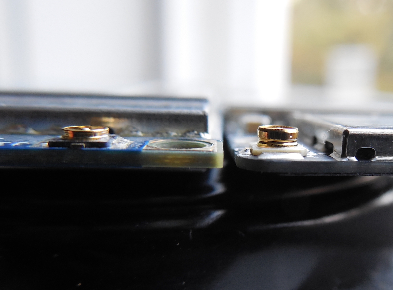

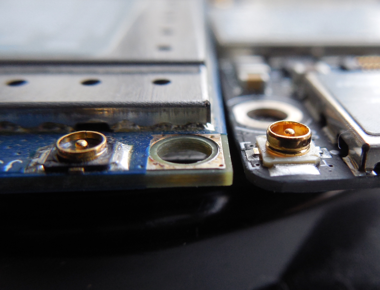

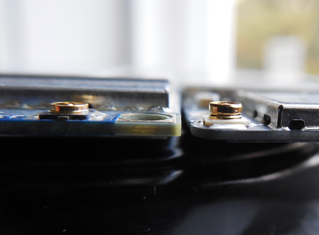

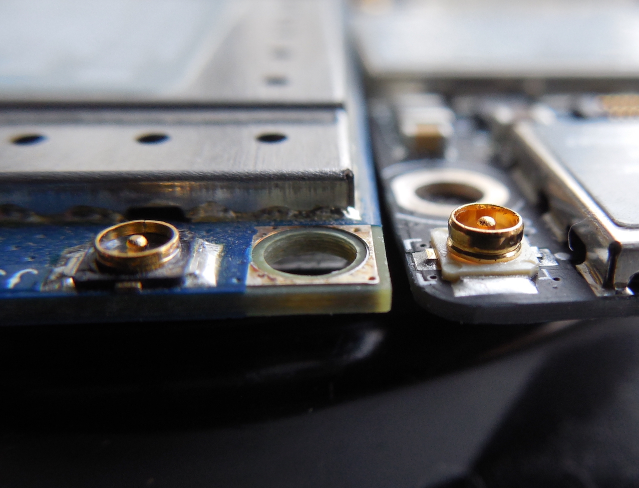

A1342 combo card coax connector is slightly different than the ones on Mac Mini 3,1. It is taller and the groove for the latching/click onto securely is lower (Thus doesn't click and easily disconnects). Diameters are the same (both 2mm outer).
I had no problems with 2 early 2009 Mac Mini. However, 2 late 2009 Mac Mini's antenna coax connector can't really grab securely onto the A1342 connectors. So it appears while early 2009 Mac Mini's antenna coax connector is slightly different than late 09 Minis.
See pics below. The shorter connector is on the 09 Mac Mini combo board and the taller connector is from A1342 with Apple part number 607-7153-A (607-5952A and 607-6503A are the same).
To get these to work, it is probably necessary to solder and change the coax connectors on the A1342 combo boards.

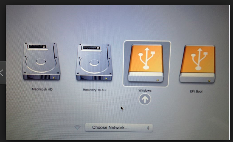

4) I think you did not press the alt-key after reboot. Try the following: Start the MacPro and press alt-key immediately and keep it pressed until you see volume icons appearing on the screen. Question: Do you know what I am talking about and did you ever do what I ask you to do? But If you did not install Sierra (see question 2) this is useless anyway.
5) If you have installed Sierra, did you also apply the post-install-patches?
I try to add a screenshot of what you should see after start with alt-key:

I don't expect to boot from the SSD, I am trying to install Sierra on it by booting up using the usb, utilities wasn't the right word, I meant the recovery page. Thats all I get when I press the alt key after reboot. I don't see any icons, my original hard drive running El Capitan is in the bin as its now packed up, so I am starting from scratch so to speak, blank new SSD and a usb with Sierra boot on it to install on the new SSD. Until I get Sierra on the SSD I can't do a post-install patch. If I can't get Sierra or indeed any other OS on the SSD them my mac pro is useless !!
