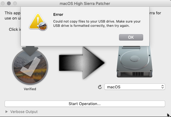

hi guys, sorry if this has been asked already. i'm just really stumped.
i'm on an early 2008 Mac Pro [ 3,1 ] trying to install High Sierra.
I'm stuck here:
i've tried different USB sticks / internal drives and i'm formatting it journaled + GUID
i also downloaded different versions of the patcher and High Sierra.
still nothing. can someone please help me figure this out ?
