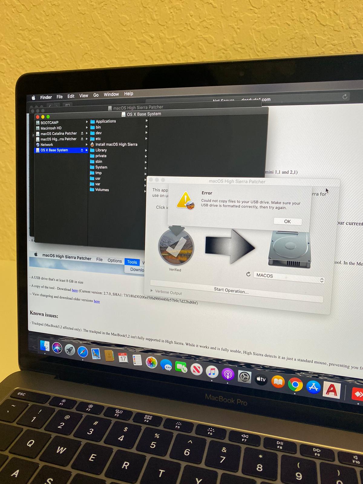

Hi M030, I have the same problem like you with the USB "Could not copu files to your USB drive. Make sure your USB drive is formatted correctly, then try again" could you help me with the way that you do it? do you have the patch that you use, thank you so much.

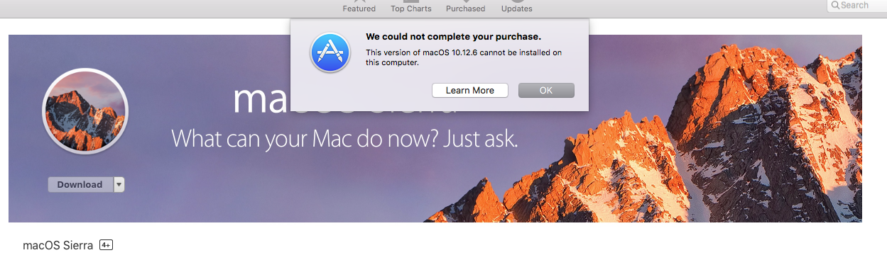

I've tried to download the Sierra installer app a bunch of times but I can only get the .dmg file. If I try to run this file on my El Capitan OS, it won't proceed. How do I get the actual .app file so that I can proceed with Dosdude's Sierra patcher...? The App store also won't allow a download per the screen capture below.
Just use dosdude1 patcher to download the file, mount the .dmg and then extract the app to your desktop. Then you can proceed to make a USB installer
Sorry was thinking his Catalina app does that. I think you can use iTunes to download the High Sierra App if I remember correctly
Try this link to download just the app if you want - https://apps.apple.com/ca/app/macos-high-sierra/id1246284741?mt=12

Thanks for replying.
As you note, the Sierra patcher app doesn't come with a built-in download of the Sierra installer app. I found a version after some effort but the patcher app won't recognize it...
The App store won't allow a download per my first post.

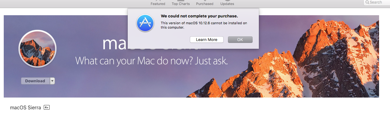

Hi I hope someone can help with this.
I was unsuccessful in installing High Sierra on my cMP3,1 and want to try Sierra, but I am not able to run the @dosdude1 patcher tool on the downloaded .dmg because it is greyed out.
I've downloaded from two different locations:
- the linked to at Apple's own page under step 4
- this link found at Macworld.
Both result in a filed called installOS.dmg which the patcher greys out.
The Macworld article also links to the App Store, which does open, but when I click "Get" there's an error: "Update not found. The requested version of macOS is not available".
Is this really the end of the road or are there other ways to get an installer that the patcher tool recognises?
Thanks in advance
Philip
Thanks in advance
Philip

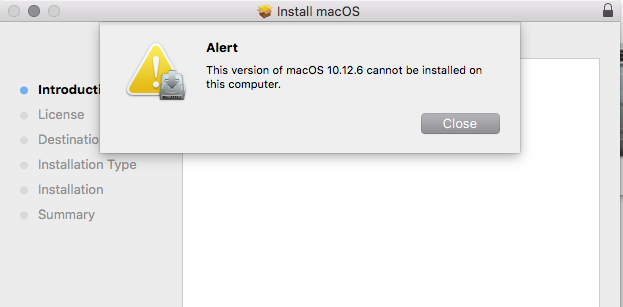

Similar to the post above...where can I find 10.12.6? Or at least 10.12?
As has been mentioned above Apple only keeps the latest / last versions of their OS's available
for download.
So for Sierra that would be 10.12.6. this can be downloaded from this link,
In a moment of ever increasing stupidity Apple decided a better way than downloading the install app
directly to the Applications folder would be to have InstallOS.dmg download to your Downloads folder.
You then open this to InstallOS.pkg, here is the even more stupid part the next bit can only be
done on a mac that is capable of running macOS Sierra, any mac that came pre-installed with a later OS
will refuse to to do this.
Open InstallOS.pkg and an installation window will open, this does not install macOS Sierra but creates
Install macOS Sierra.app in the Application folder, which you can then use to create the bootable USB with
Dosdudes patcher. So you need to borrow a mac that can run Sierra, a mac that is capable of running Sierra
includes macs that have been upgraded to newer OS's. This does not include macs that have been hacked to
run Sierra or other. Has to be an officially supported mac.

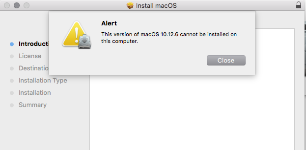

for download.
