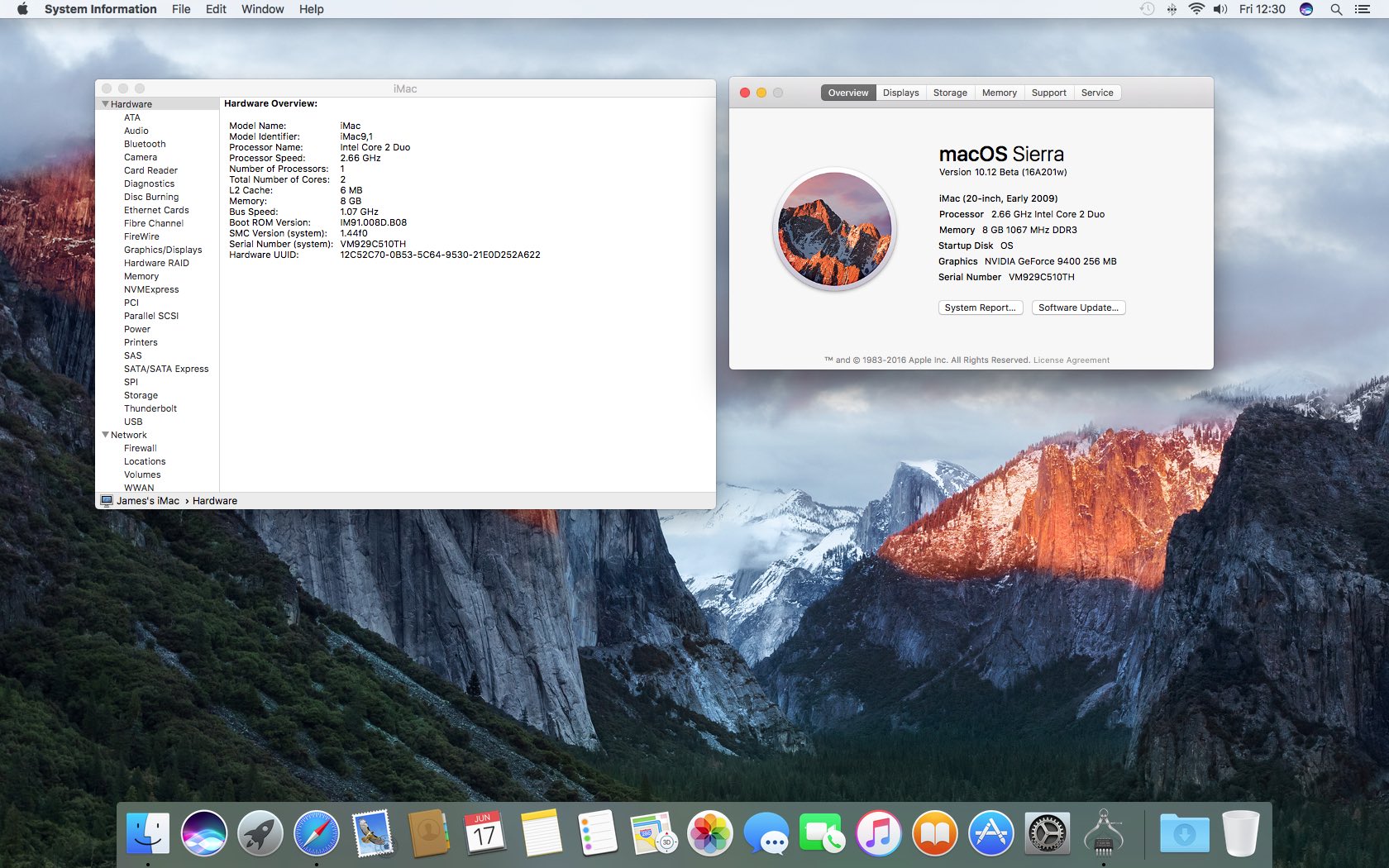

Got it working on iMac9,1 Early 2009 with USB/Wi-Fi etc. I restored the pre-installed DMG to a partition, disabled SIP in Recovery and then ran the Seirra4u patch in El Capitan and it booted fine. Thanks a lot to everyone that made this possible!
Did you booted in ElCap recovery or Sierra recovery?
El Capitan recovery and ran " csrutil disable " in the terminal. Then rebooted into El Capitan, ran the Sierra4u patch and rebooted again, this time into the Sierra partition. Now everything works fine, before running the Sierra4u patch I had no Keyboard or Mouse function.
