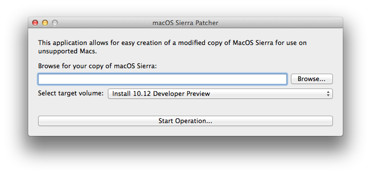

Everybody, I'm currently working on a new tool that automates the process of patching and installing macOS Sierra on unsupported Macs. Should be finished in the next day or so.

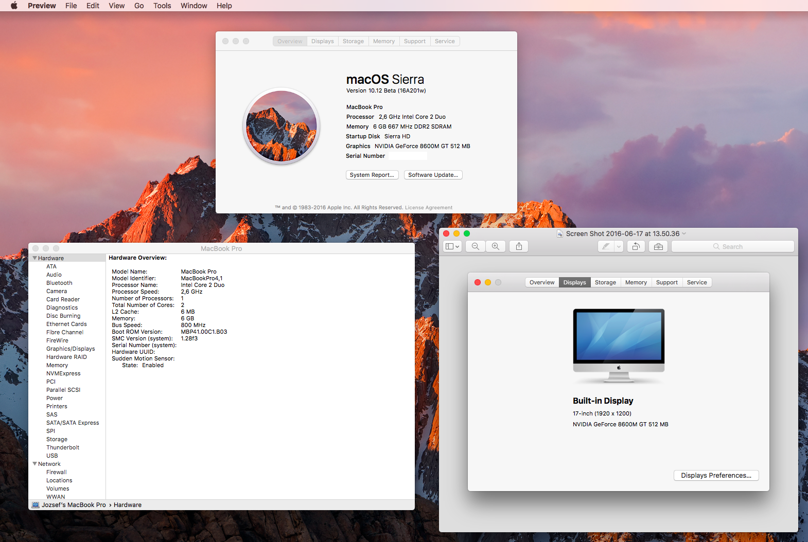

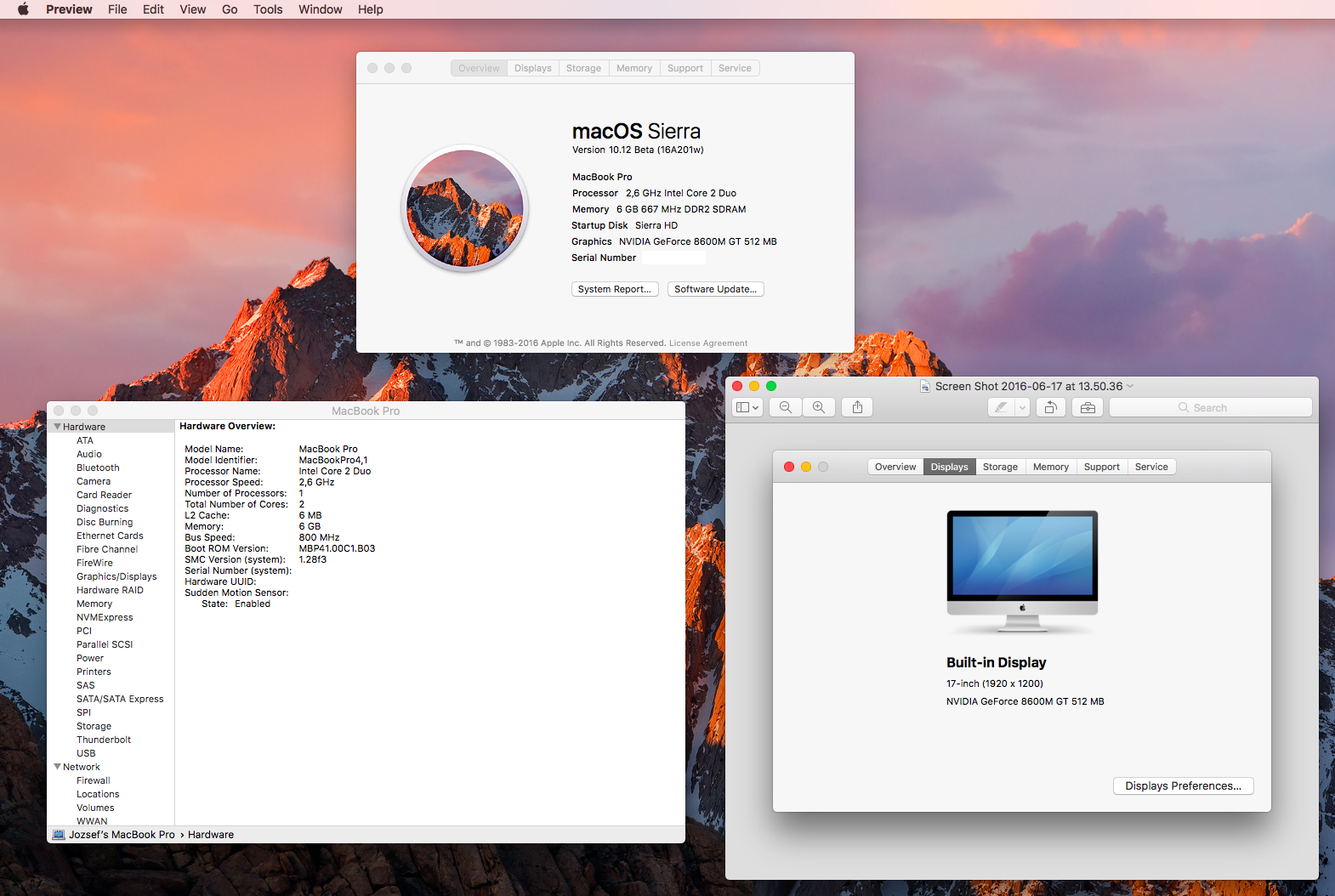

MacBookPro4,1 (Early 2008) seems to be working without WiFi. Somewhere i have a spare atheros WiFi card (removed from my iMac 2011 when replaced a newer, AC/AirDrop/Handoff supported card)
I've just finished the automated tool. It may still have some bugs, but if people could test it out for me, that'd be great!
http://dosdude1.com/sierra/macOS Sierra Patcher.zip
EDIT: doesn't work correct ATM. Working on it now.
Alright, should be fixed now. Go ahead and give it a shot. Note that after the install completes, you'll need to run the post install utility, which is located under the "Utilities" menu in the OS X Installer.
EDIT: Still doesn't seem to be working.
What are the steps to use? Do you need a supported mac?

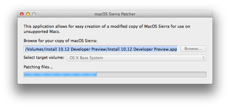

Alright, the automated patcher is now complete, and SHOULD work perfectly fine. Here's how to use it: First, browse for your copy of the macOS Sierra installer app. Second, select your USB drive that you want to use to install macOS with, and click Start Operation. When the tool finishes, boot it on your unsupported Mac, and install normally. After the installation completes, boot back into the installer, go to the Utilities menu, and select "macOS Post Install". Select the drive on which you just installed macOS, and click "patch". You should now have a working system, with the exception of WiFi on some systems. http://dosdude1.com/sierra/macOS Sierra Patcher.zip
