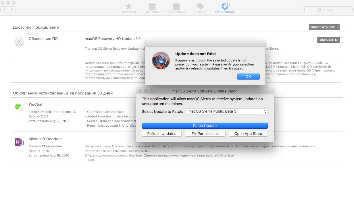

I can't updated!
MacBook Pro (15-inch, Late 2008)
[doublepost=1471868511][/doublepost]

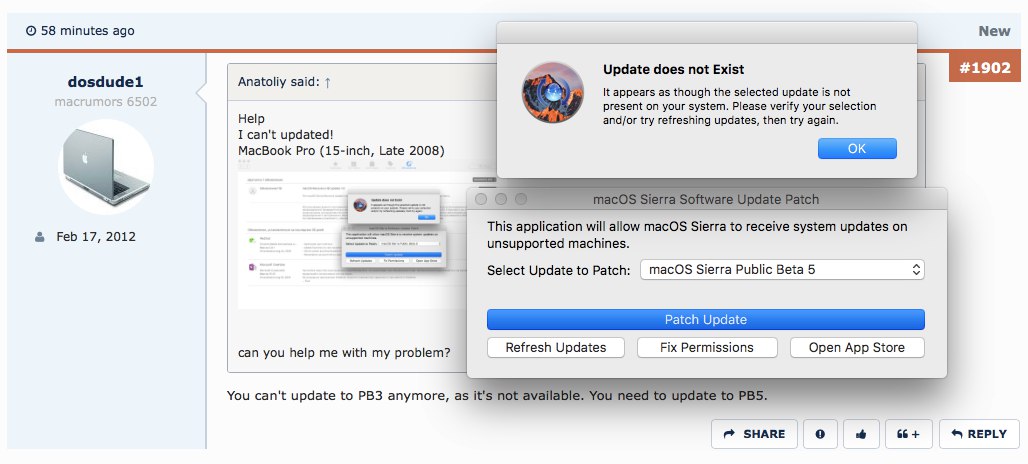

can you help me with my problem?
You can't update to PB3 anymore, as it's not available. You need to update to PB5.

Follow this procedure: Reboot the computer, open the tool, refresh updates twice. Then, reboot the machine again. This time, open the patch tool, select PB5, and click "Patch Update". If it says it was successful, refresh updates ONCE only, and then check the App Store.
hi - how does rebooting and refreshing updates twice then once exactly help? Maybe will help me understand why my updates aren't working. Thx.
For some reason, the entire Update Catalog folder gets erased when refreshing updates a second time, removing the patched file. The only way to make it not do this is to reboot once, and only refresh updates once.

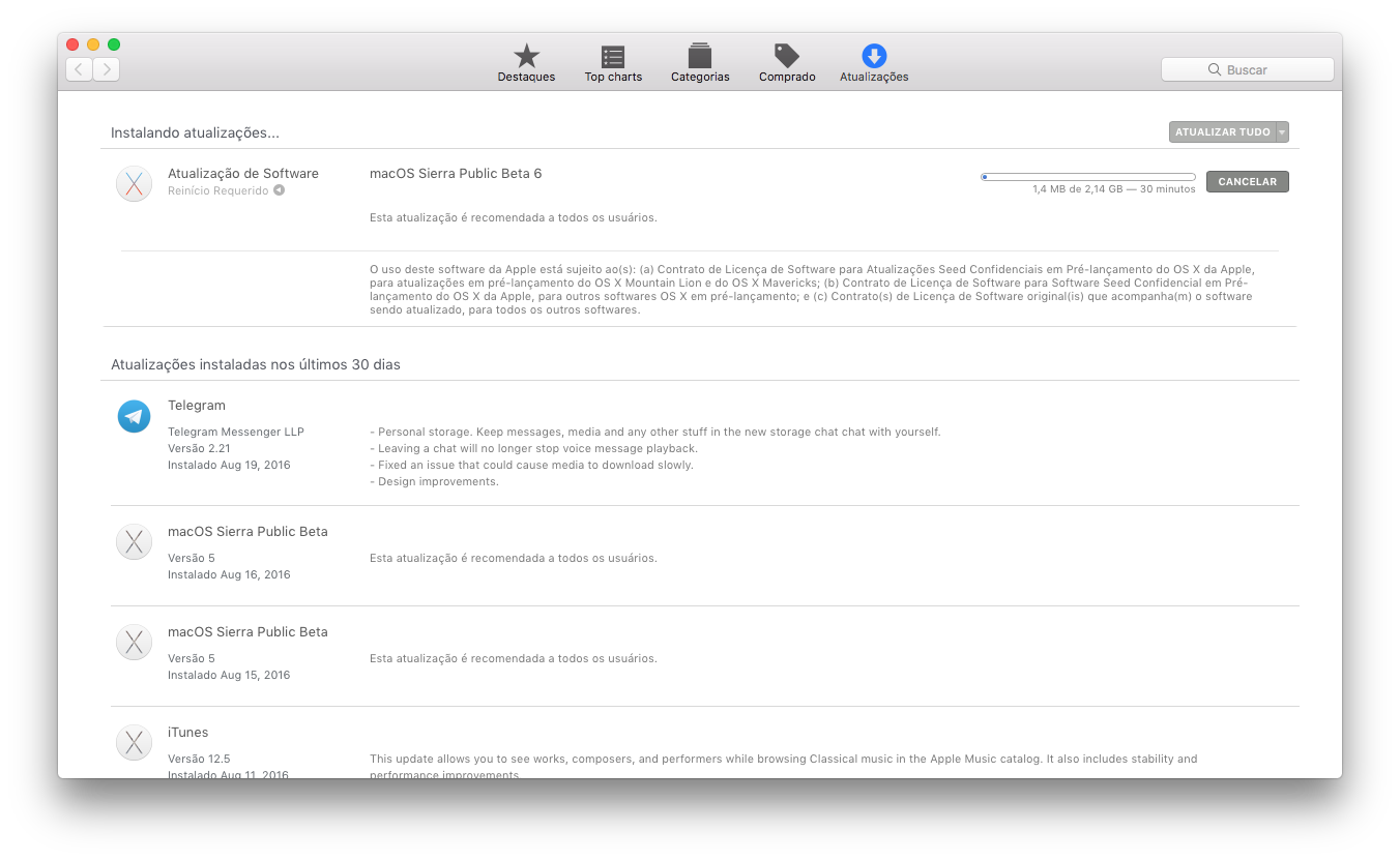

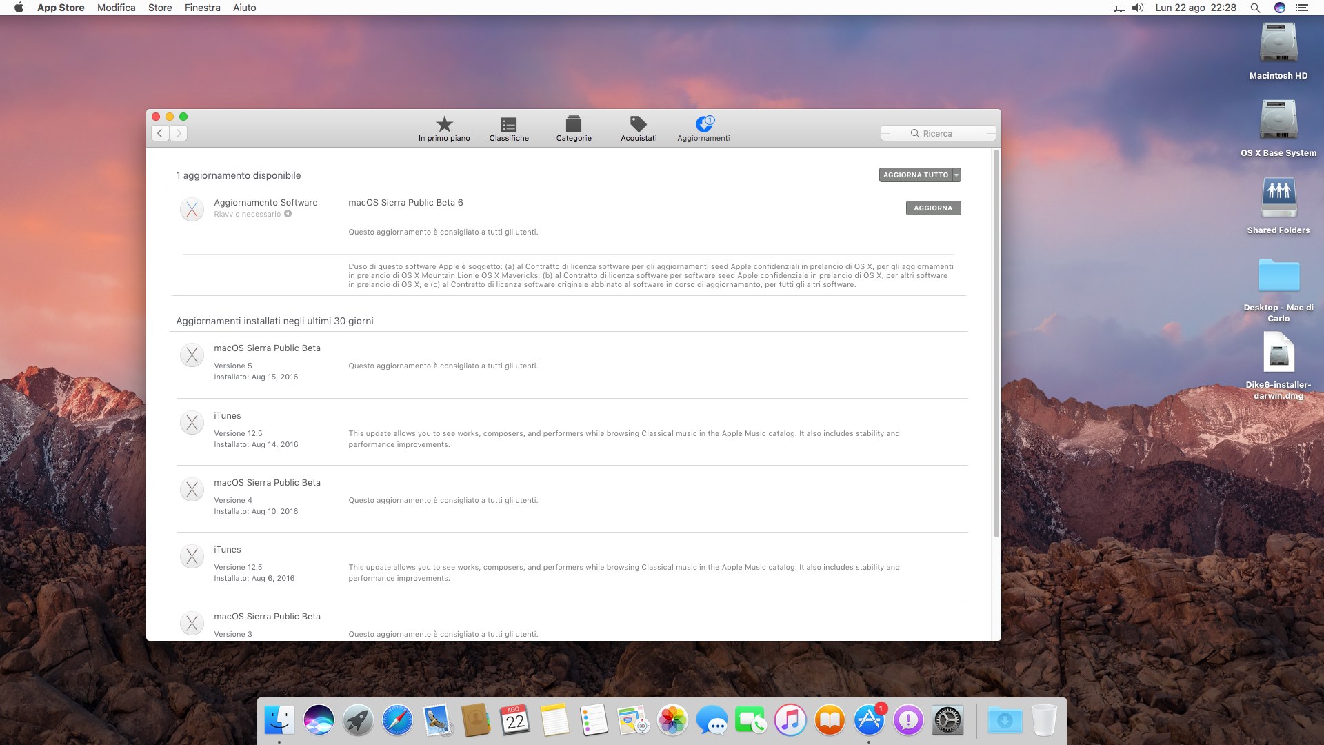

yikes PB6 is out, only just got PB5, after days of arm twisting.
No PB6 showing in my App Store.
Here we go again.

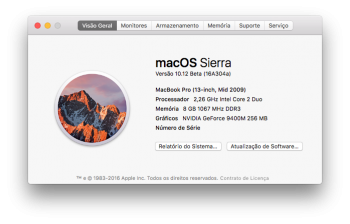

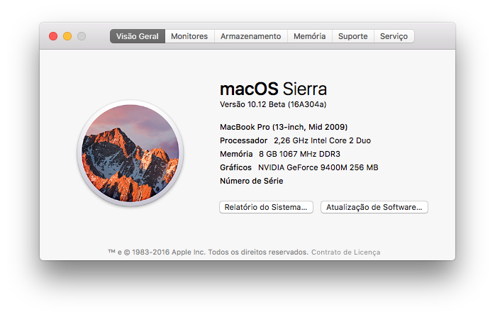

I'm amazed as my MacBook Pro 2009 runs macOS Sierra very well (with 8GB RAM and SSD), it looks better than El Capitan that is officially supported. I wonder if there is a justifiable reason for Apple remove the official support for this model, not just to force people to buy a new Mac.
