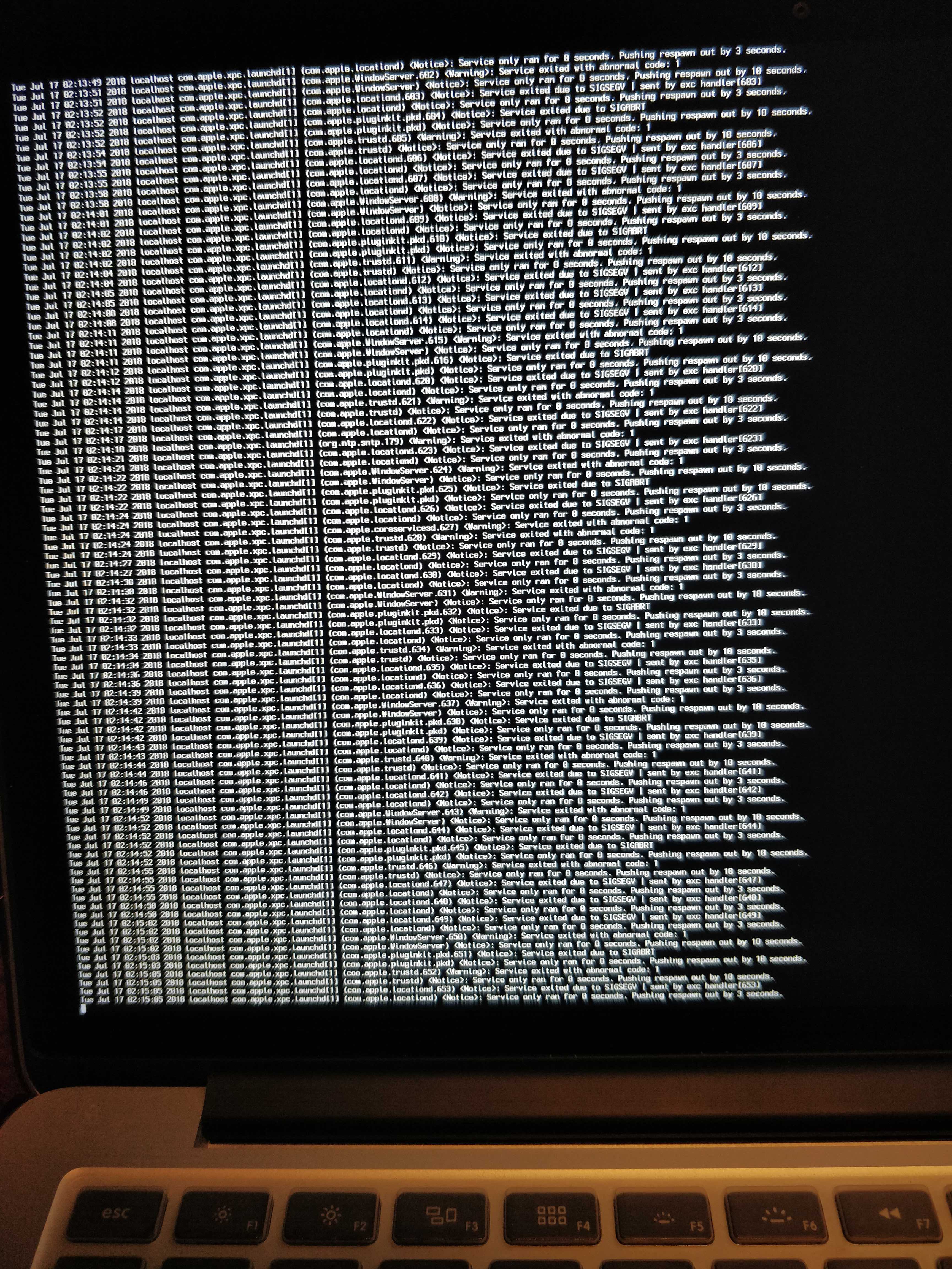

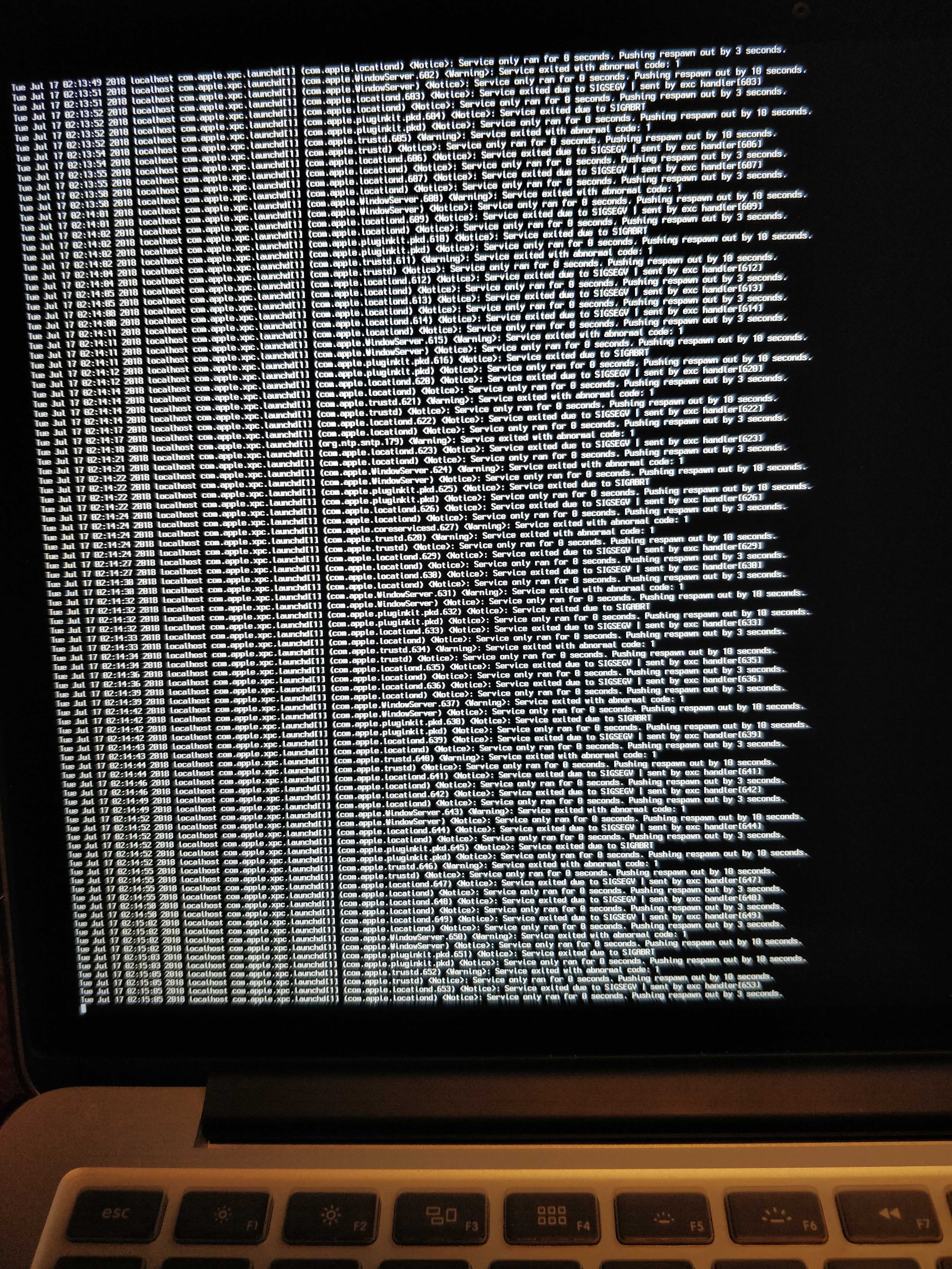

The current version of Mojave patcher just downloaded the Dev 4 version for me. However with patcher version 0.1b10 it will never fully boot even on a 2015 Macbook pro.

Because my tester computer is a 2011 iMac with 780m in it so there is no boot screen. After having it sit for 40 minutes with no graphics initialization my only option is to boot it on a machine where I can see whats happening.
Target Disk Mode?

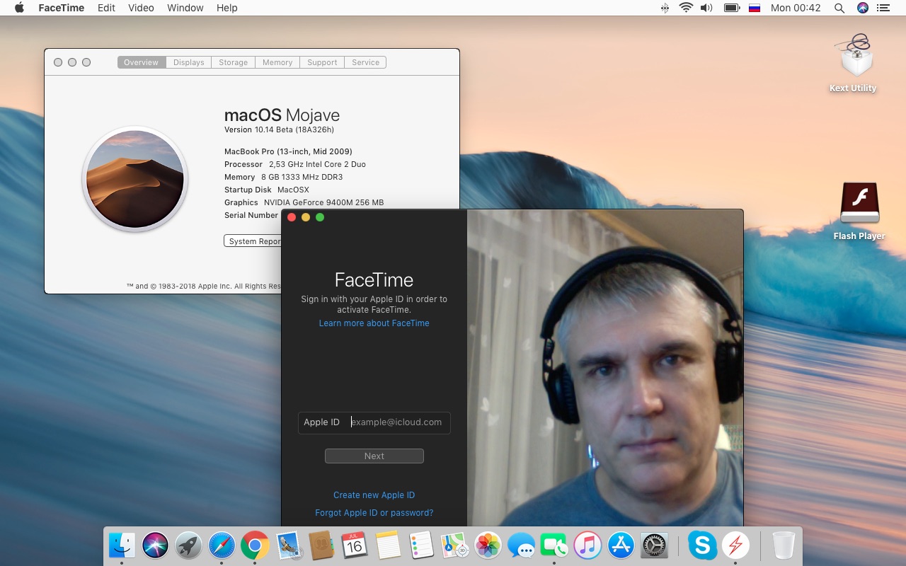

There was a problem with the camera and with the definition of USB.
MacBook Pro 5.5 now works as it should!
It is necessary to make so:
Burn bootstrap with patch HighSierra 10.13.5 from here http://dosdude1.com/highsierra/
From the image, select two IOUSBFamely.kext and IOUSBHOSTFamely.kext from the System / Library / Extensions
Then in Mojave, run the Kekst Utilities program and drop these two keksts
Enter the password twice when processing the caches and at the end, restart the computer.
The camera and USB ports work correctly.
Thank you for this decision!

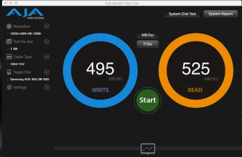

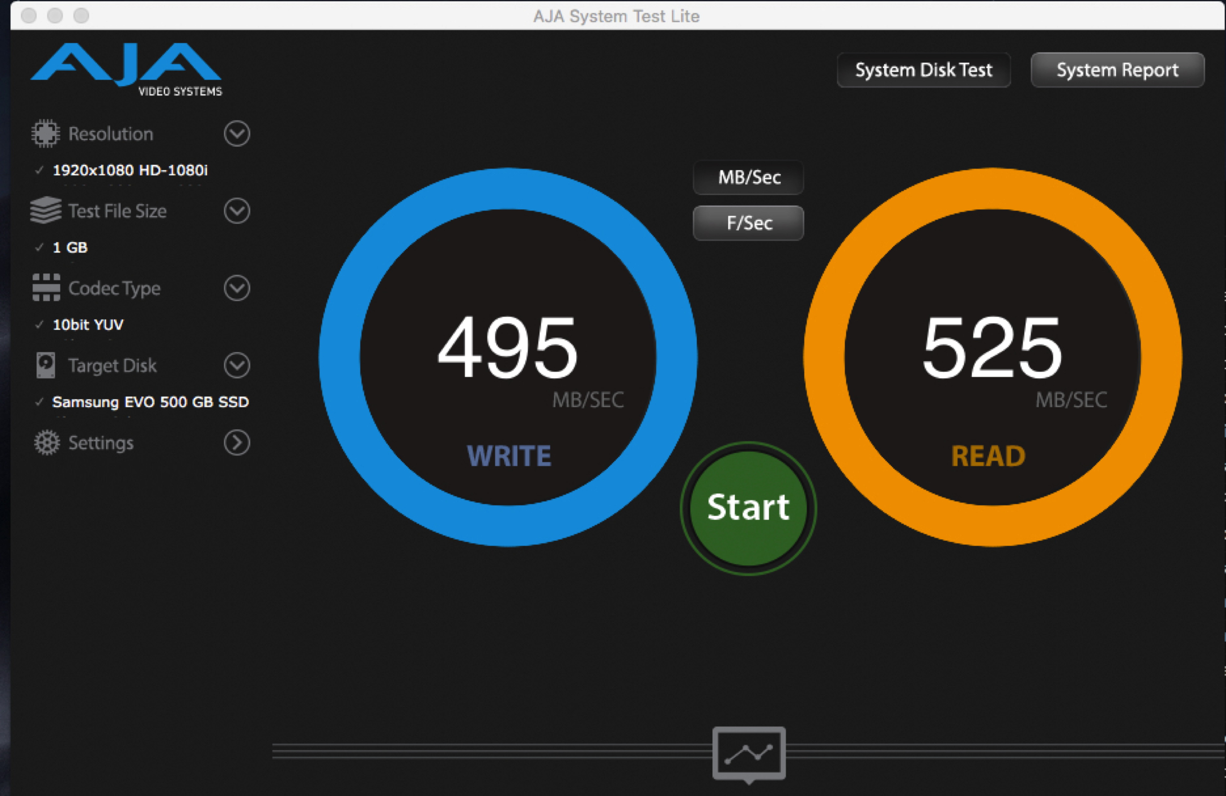

I couldn't agree more, as far as speed goes there is no comparison, SSD's definately have a substantial advantage over traditional HD's. My startup time is about 30 seconds, as far cry from the 1 TB spinner that was replaced with a Samsung EVO. I was trying to remember which connector it was that's tricky. Great info nekon1.

You may want to check out my mini-thread with @Banan4eto starting back at #2905 or so. See if that works for you. Bottomline, (sometimes) starting FaceTime first and waiting (patiently) for it to prompt for a restart "reconfigures" your iSight for proper streaming. No guarantees, but it worked for me on my 5,3 with the original kexts from Mojave.

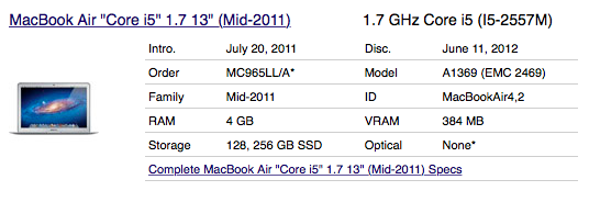

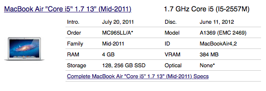

And if you (not only you but anyone else) want to be included in the Mojave Patcher Post Install Mac model should specify their Mac Model. For example from what you have written your Mac Model could be one of these: MacBookAir4,1 or 4,2
I have a MacBookAir4,2
