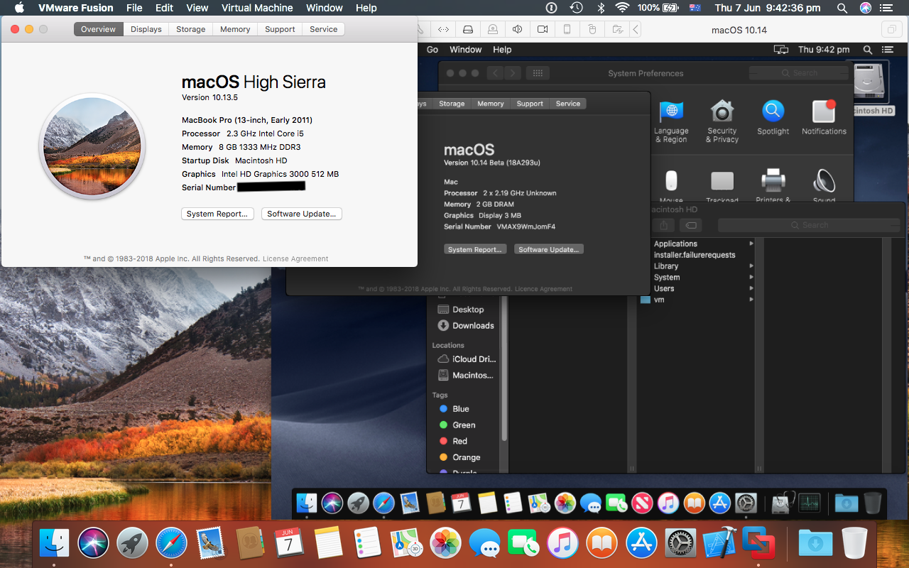

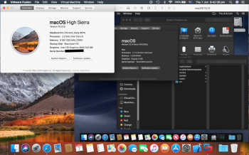

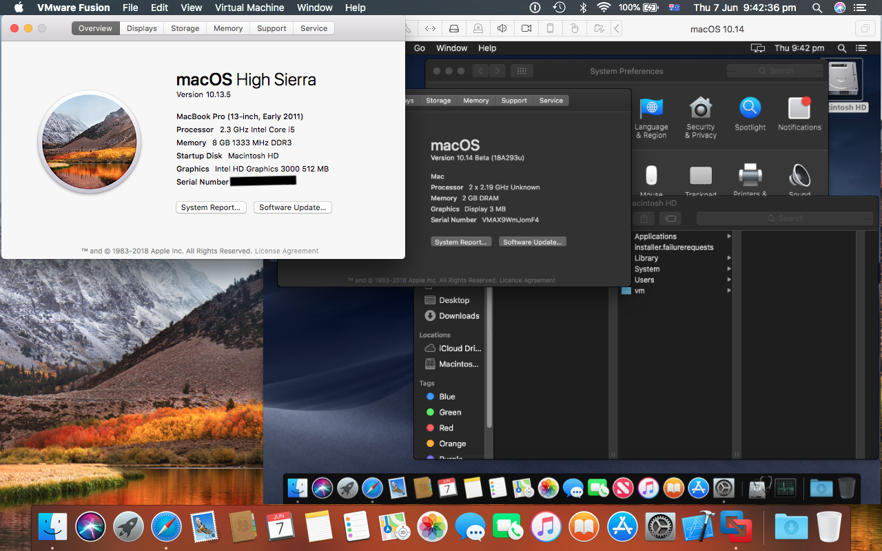

that's good news. And does the dark mode work?
yes
You loosing multiple things without hadware acceleration, like h264 hardware assisted decoding orhardware support from the GPU for video scaling, colorspace conversion. Running on a real hardware without acceleration is nearly the same speed that you can achieve in running a VM. Try to play videos from youtube or running Kodi or playing somethings recorded with an iPhone and imported to Photos.
True, but still useful for Mac developers to test software on it before releasing them to the App Store, and it shows that 10.14 doesn't actually require metal , Apple pulled another dick move by disabling some of the frameworks responsible for hardware acceleration, we just need someone to figure out how to re-enable them and were good to go.
