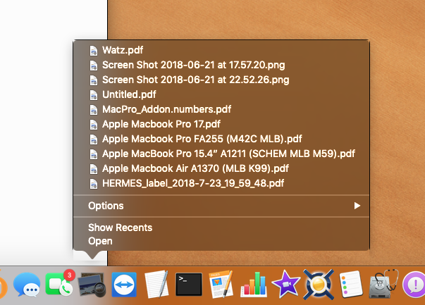

Nice small fix: The build ..347e removed the context menu artifact bug (see pictures).

Guess the dark artefacts don't show on a dark background try again on a light background, they are still there.
Right, but way better... almost not noticable any more. But we´re in beta... ;-)

Yes but in your original post about this you suggested they were gone, I was merely pointing out they were still there, and I know we are in Beta. The thing to find out is if those with supported machines have the same issue.
