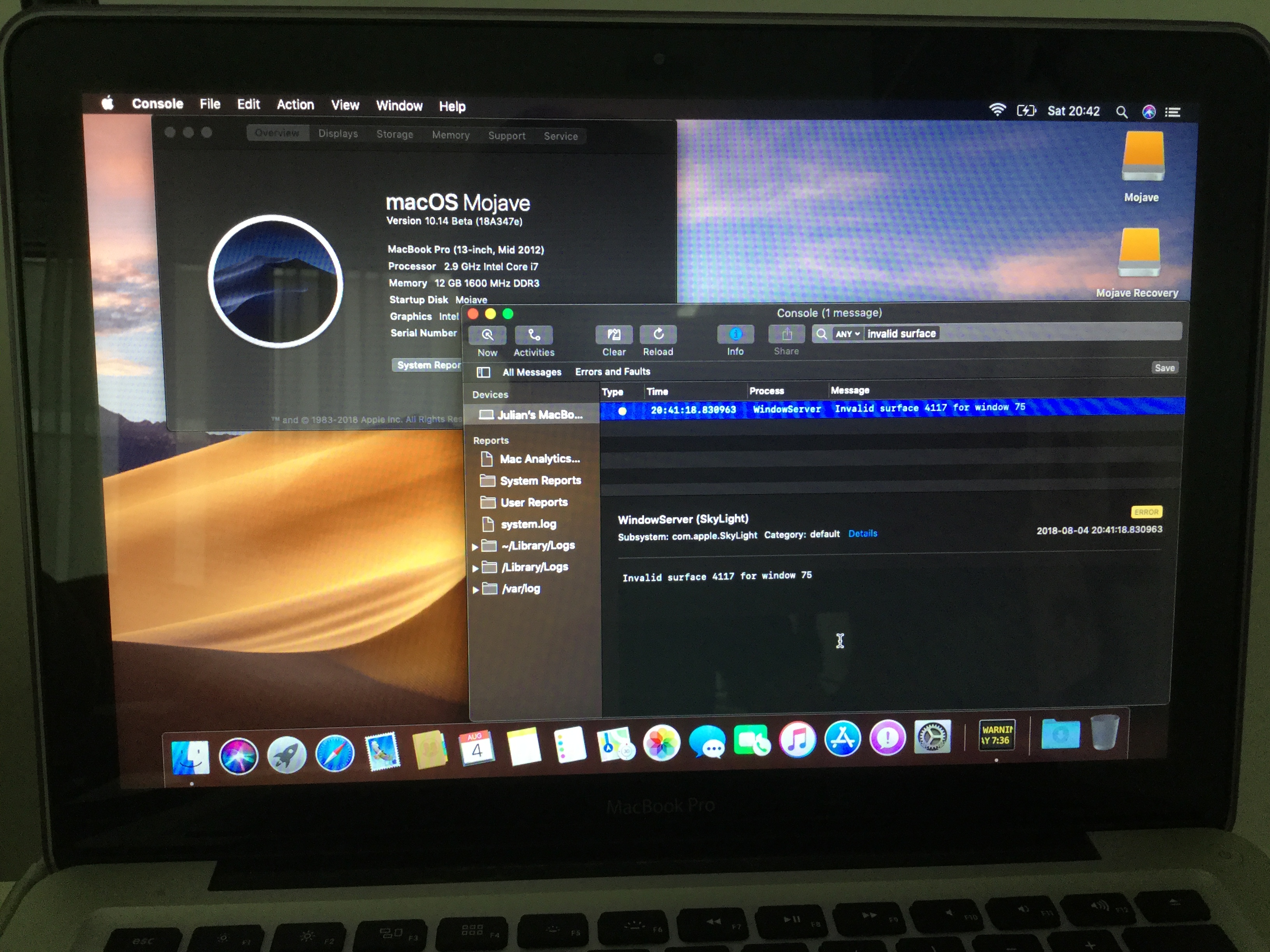

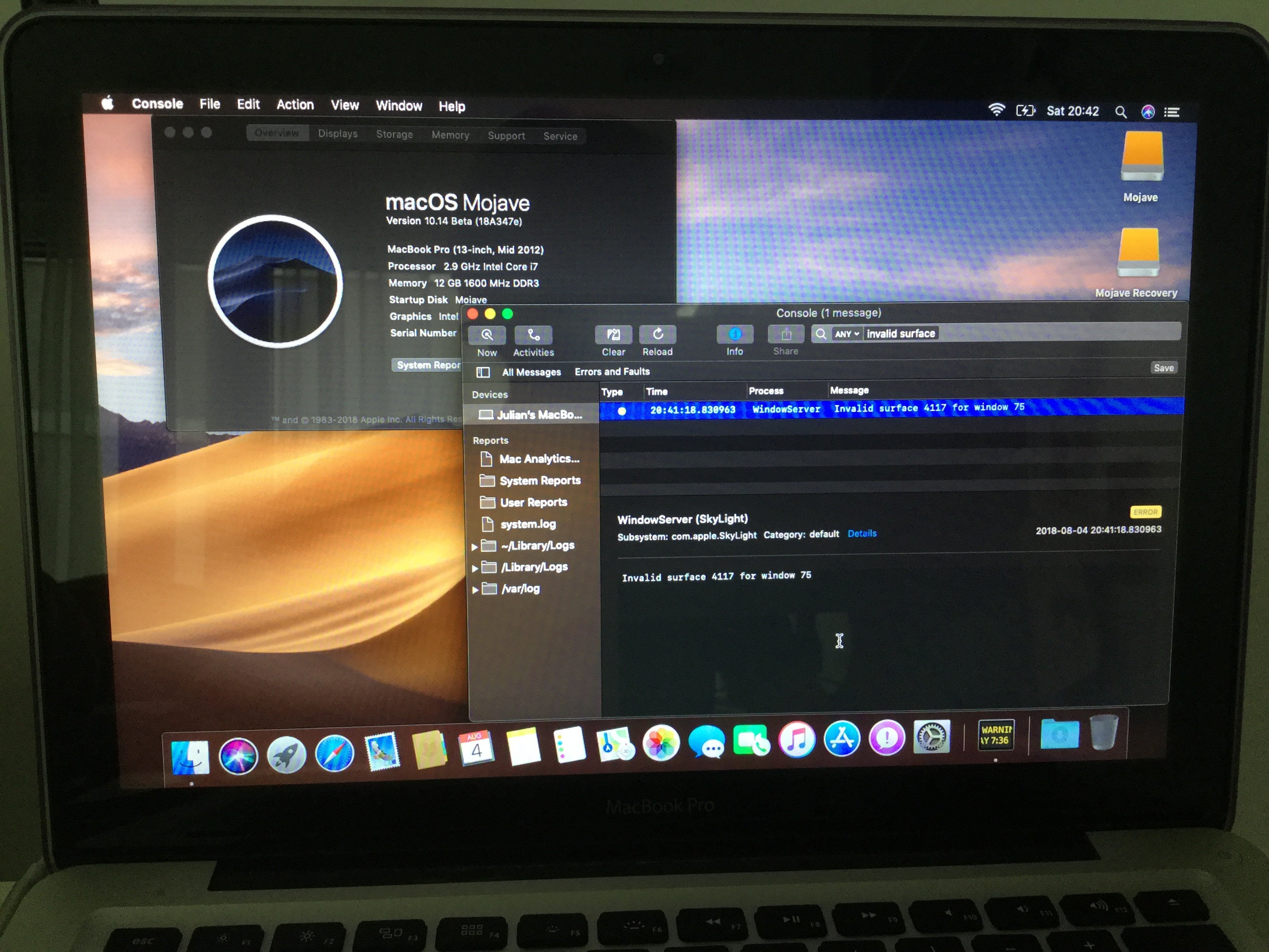

I've only worked on this for a few minutes so far, but as a start point I've been looking at some Console errors that I thought were relevant.
The error Unknown CGXDisplayDevice: [x] should be ignored. It happens in High Sierra.
The error Invalid surface [x] for window [y] only happens in Mojave and I traced it to SkyLight.framework/.../SkyLight. Could somebody with a supported Mac please use Mojave for 1/2 hour and see if this error appears for you? I feel this might be the cause of transparency glitches.

Same issue on a Mid 2012 MacBook Pro.
I did encountered too: Invalid surface posted
