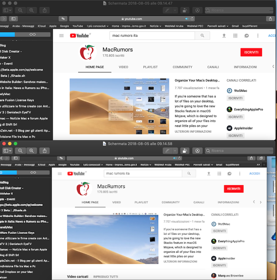

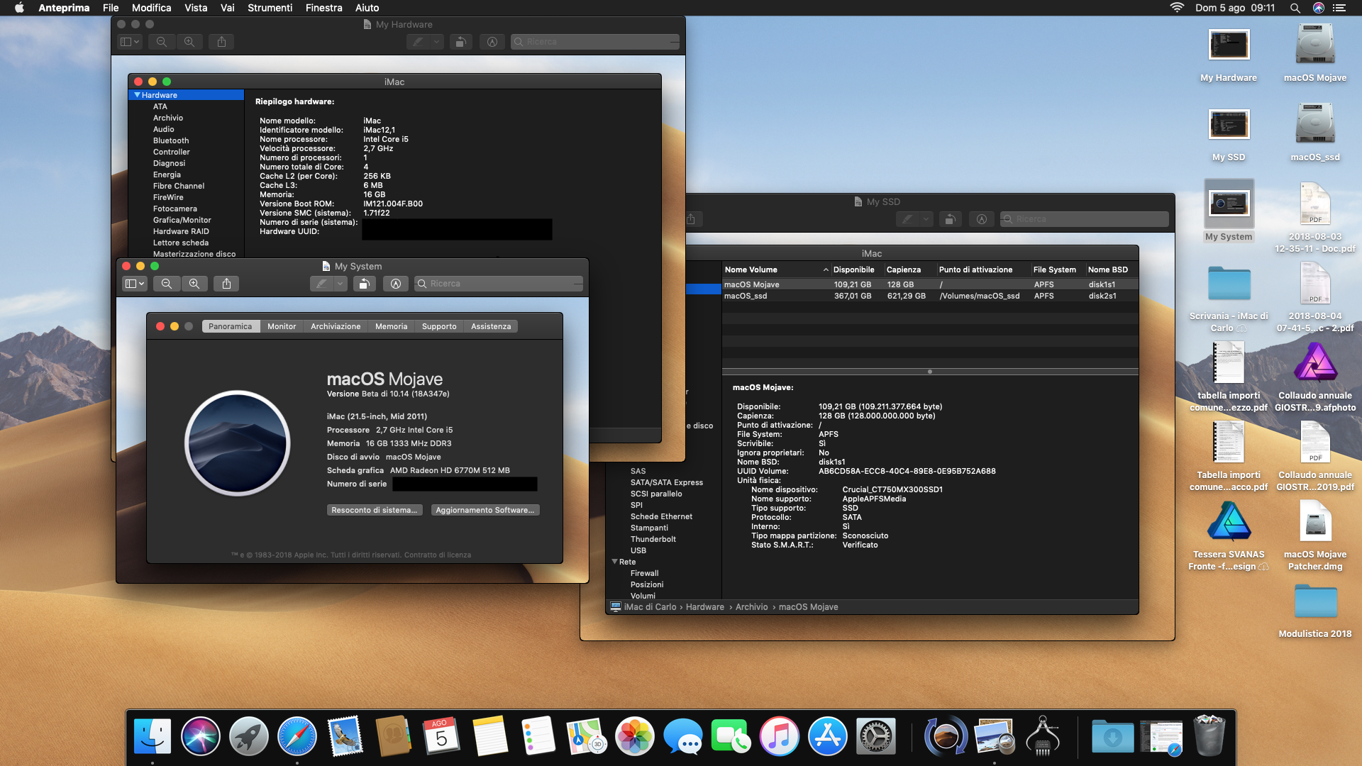

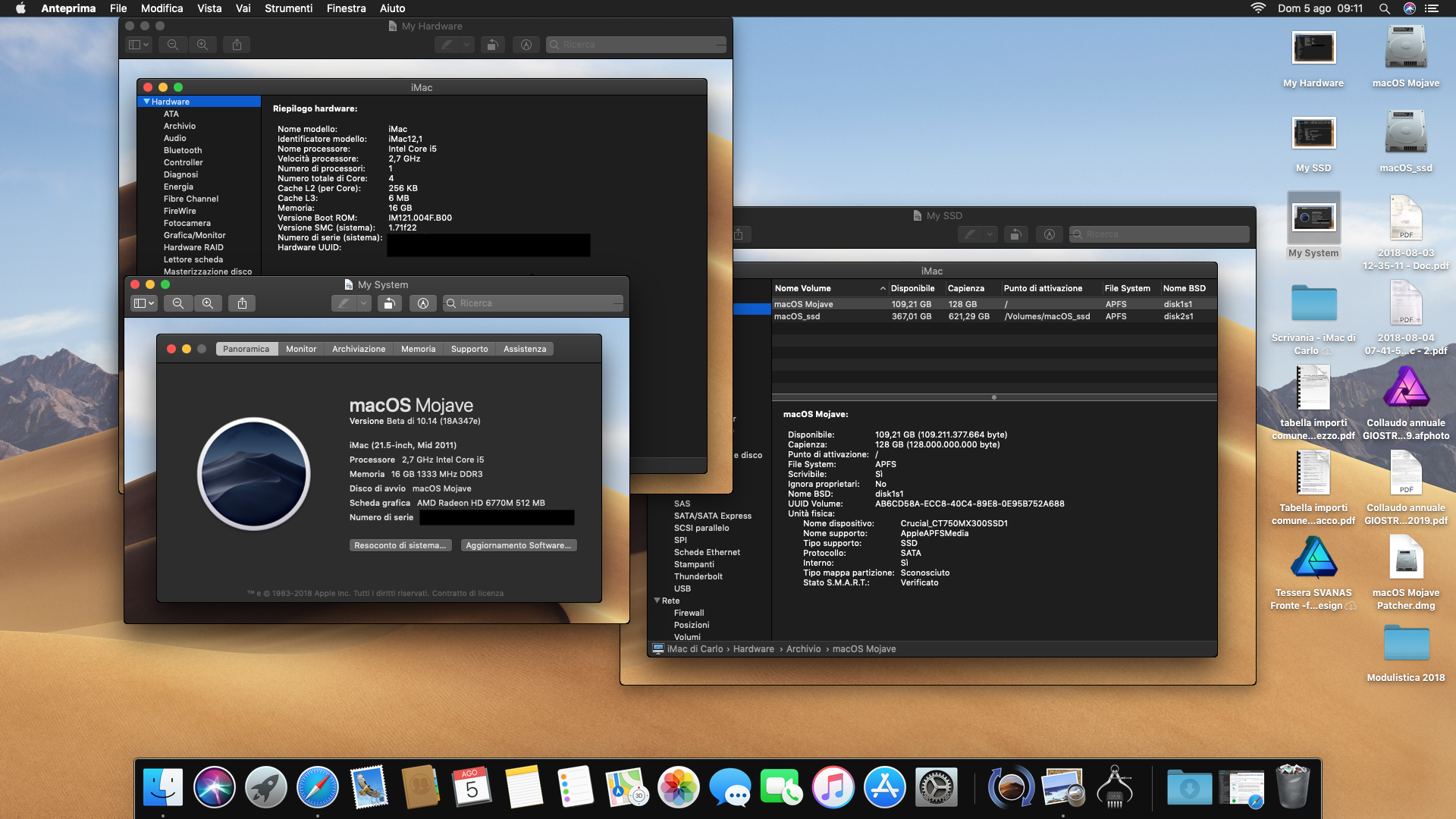

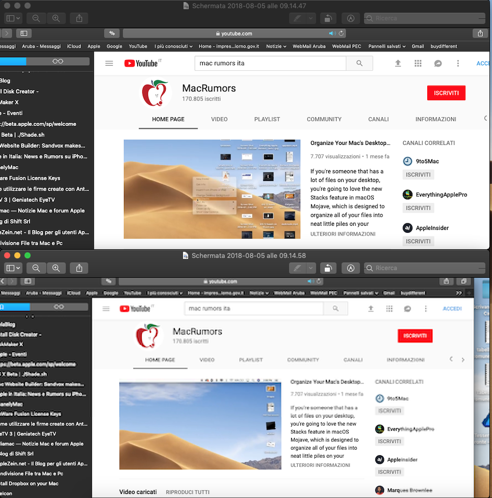

My system iMac mid 2011 with SSD CRUCIAL 750 GB, Memory 16 GB, ATI Radeon 6770 512 Mb,
with you last patch,
controll audio work;
brightness control work;
play videos YouTube work.
transparency effects not work;

Many tanks for your patch.
Those graphics related features don’t work because your ATI Radeon graphics card does not have full acceleration when running on a patched Mojave system.
