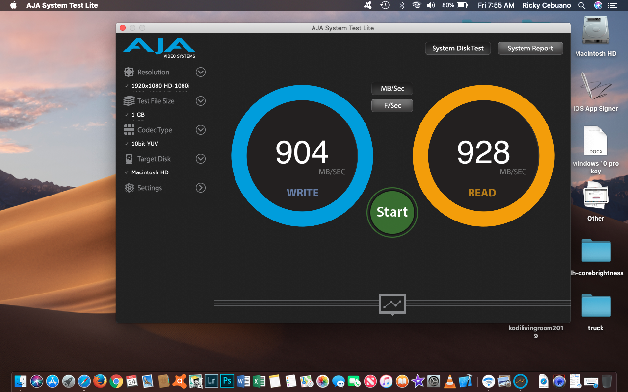

Another question about installing a new SSD. Is there any benefit to replace the optical drive with a second SSD? It’s around the same price to get the doubler along with the SSD, and I never considered this path. Would it be better to have both the HDD and the SSD, or just replace the HDD with the SSD sand use a USB-SATA converter?
i've used data doubler with 2 SSD, its pretty fast for data transfer.

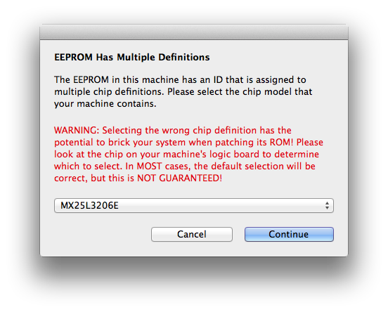

Alright, I've finally finished it... APFS ROM Patcher is finally done! Some precautions:
- APFS ROM Patcher is to be used AT YOUR OWN RISK! There is always the possibility that your machine could become bricked as a result.
- DO NOT apply APFS ROM Patcher if your machine already can boot from APFS volumes
- If you get the following dialog, it is HIGHLY RECOMMENDED that you open your machine, remove your logic board if necessary, and verify the exact EEPROM type your machine has. Selecting the wrong EEPROM model will MOST LIKELY result in a bricked system!

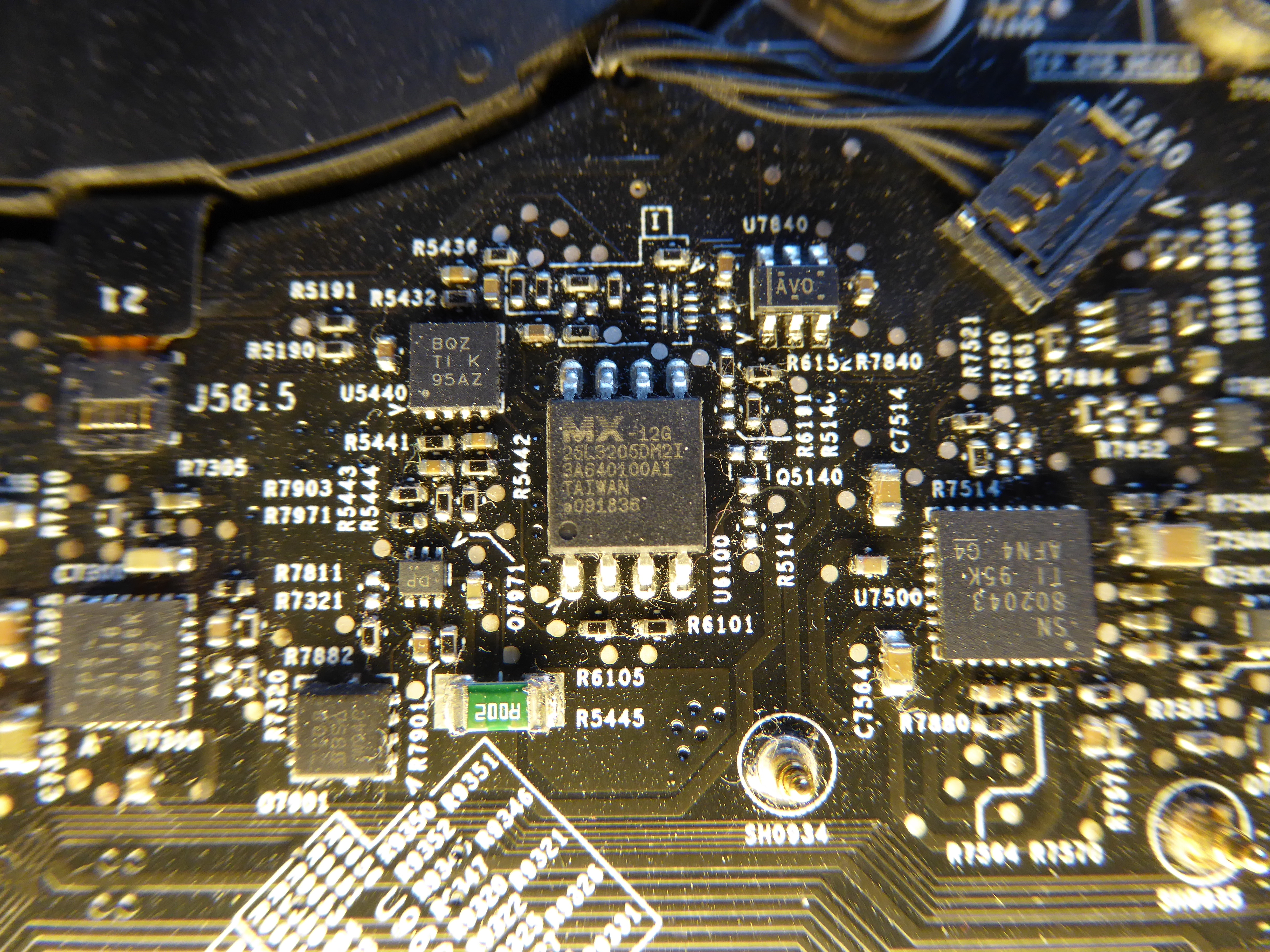

[doublepost=1535129691][/doublepost]Hi dosdude, I'm about to execute the APFS ROM patcher on my MacBoocPro5,2 (17inches, mid 2009). Before doing so, I'd still like to ask three questions:
- I've looked up the EEPROM, it is type MX25L3205DM2I-12G. I assume that is the expected type, is it? (The ROM patcher doesn't ask for that nor show it, but I thought I better crosscheck with you.)
- can I execute the ROM patcher under High Sierra or under Mojave - is there a preferred way.
- will the patched ROM boot HS as well as Mojave.
This is what I have on my MBP5,2: High Sierra 10.13.6 (17G65) on the internal SSD with APFS, and Mojave PB7 on an external (USB) SSD, also with APFS. Both boot fine without the ROM patch, showing the textual protocol during booting (I guess the APFS booting capability of my Mojave installation is a fortunate left-over from cloning (CCC) the internal SSD to the external and then installing Mojave over it with your patcher, then doing post-install where there is no APFS option).
The present boot ROM version is MBP52.008E.B05. The SN is W89301N58YB.

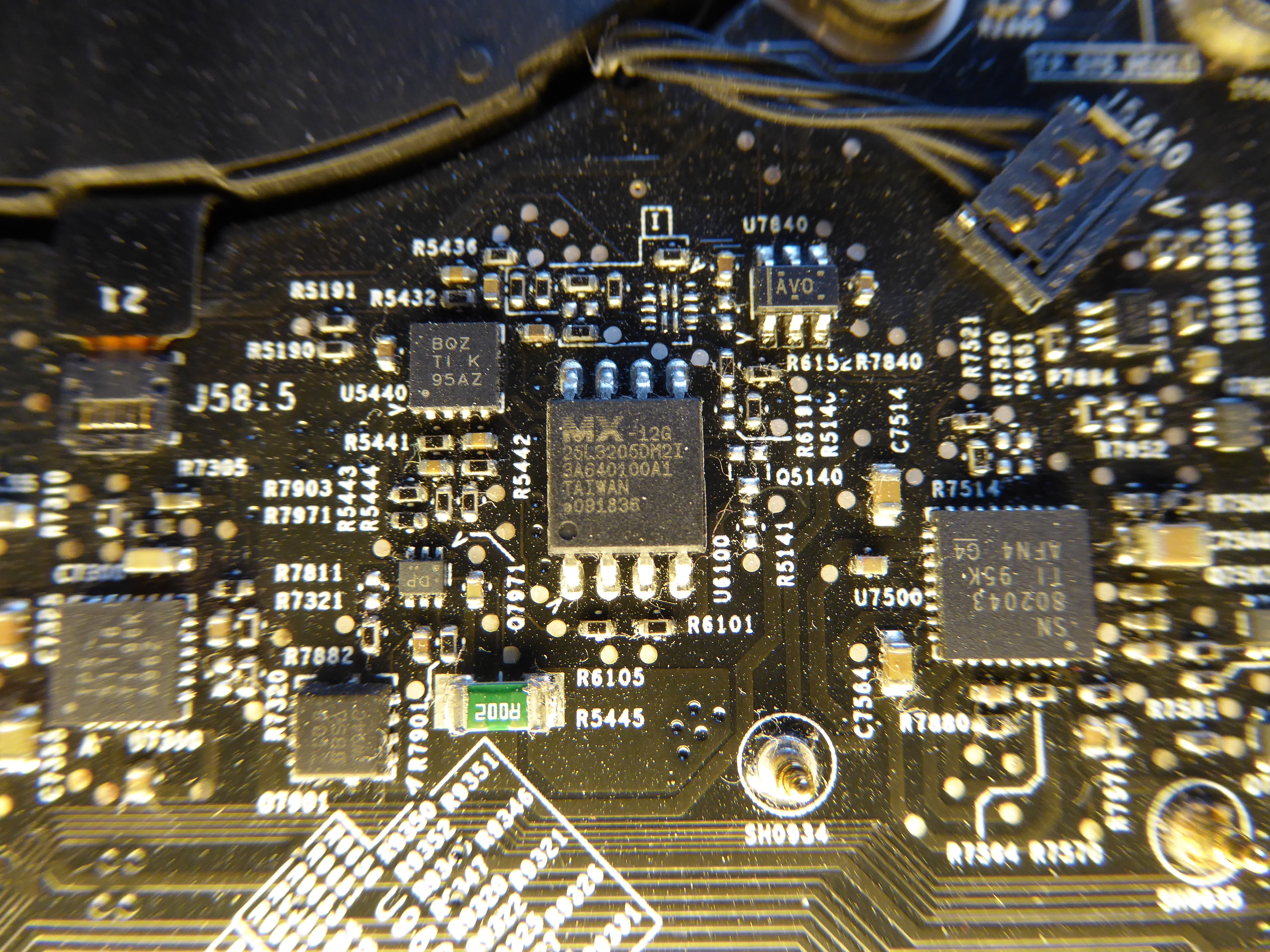

Thanks for your great help with the Sierra patcher, the HS patcher, the Mojave patcher, and the APFS ROM patcher.
The patcher will attempt to automatically determine the EEPROM type. If it succeeds, it will continue on without any prompts. If not, it will ask you to select the specific EEPROM model. You should be able to run the patcher under any OS. It supports as old as OS X 10.7 Lion. Once patched, the system will work exactly as it did before. It will now just be able to boot APFS volumes as well.

Success - ROM patcher completed successfully on MBP5,2. Booting HS 10.13.6 (internal SSD) and Mojave PB7 (USB), both APFS, works fine. Thanks!
For others with a MBP5,2: the ROM patcher offered 3 choices for the EEPROM chip type, I selected the one previously looked up on the logic board (25L3205D), which is different from the default. The 8-pin chip is easily visible when removing the aluminum bottom, see middle of the attached photo.
The ROM patcher took about 5min to dump the EEPROM and about 10min to write it back, as dosdude said. Be sure to let the process complete...
